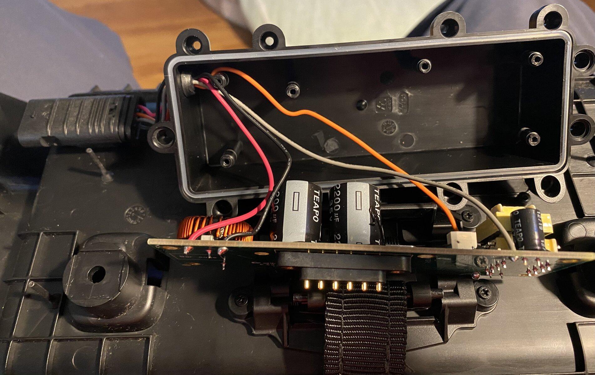

Plug was not there. I ran power and tapped the plug on the charge port. I don’t have stereo sound on the speaker when docked but that’s not really why I wanted it anyway
If I understand you correctly, you connected the red and black wire for power and didn’t connect anything to the orange and gray wire. Is it possible for you to explain where you connected it or even better a photo of where you connected it
Jeep Gladiator Bluetooth speaker charger port F5967E6F-13B8-41F2-AB98-D3266C6F2B1A
. Like you I’m not plan on using it when it’s in the vehicle, I just want to keep it charged.
