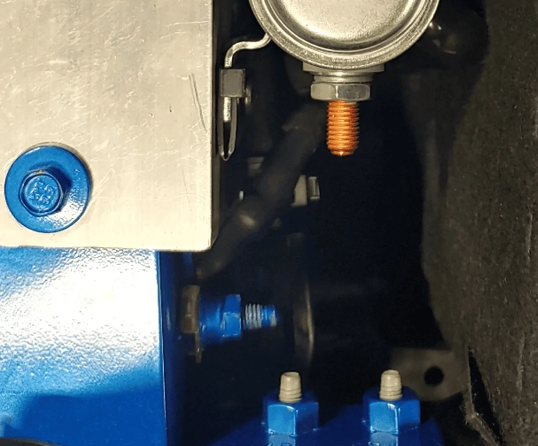

The larger bolt I am pointing to here.... Not sure what it is used for. Maybe on the diesel or automatic model?
Either way, does anyone know the size/thread pitch. It had no nut from the day I bought it. Not sure if it's supposed to or not, but seems like a great grounding location.

Same thread pitch as the one next to it and it's a spare place for a ground ..

Yep same as the one next to it. Mine had a painted nut and I use that ground for some aux lighting.

Interesting. I tried moving the one nut over since I am currently using that spot temporarily for the switch pros, and it wasn't even close to the same diameter... So, a little confused.

My bad ..it is larger than the others on my 2021...A 13mm x 1.25 thread pitch is what you need.. I had a nut laying around off of one of my motorcycles

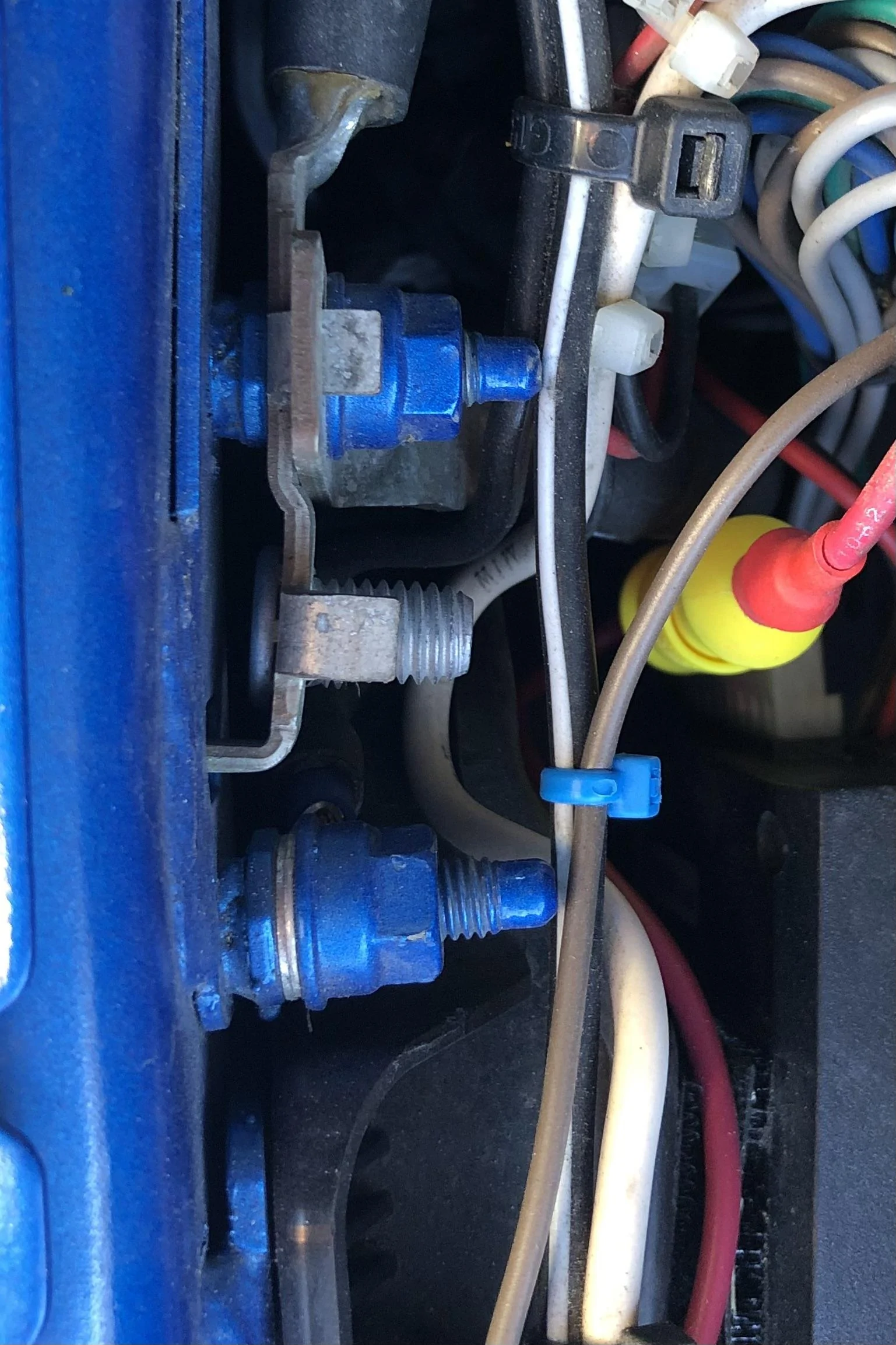

OK, what the OP’s picture doesn’t show…
Jeep Gladiator Body ground bolts by battery 1662418170799
There are two ground studs that are the same. The 3rd bolt in the middle is actually on the end of the ground cable, and is a different size.
Any of the three will be good for grounding.

Gonna have to look again cause I dont remember seeing 3...only the 2.
But the middle large one in your photo is the one I was hoping to use.

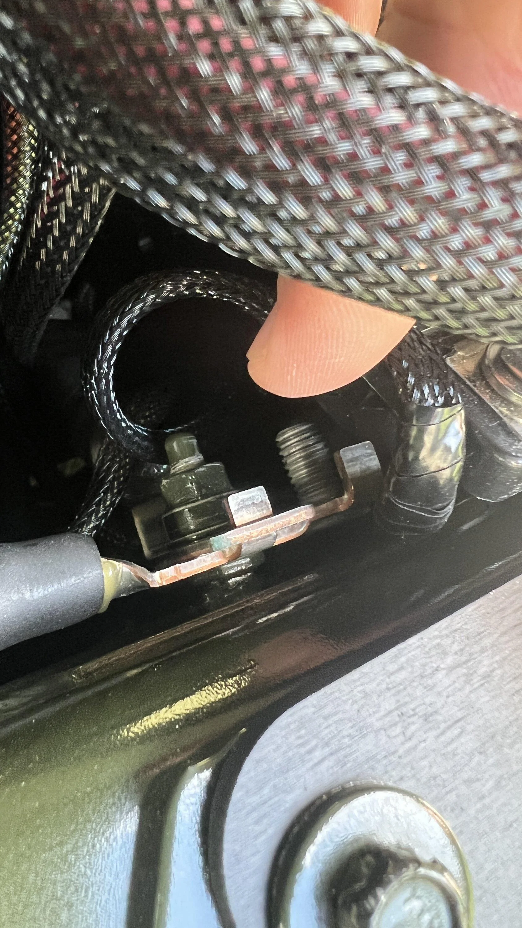

You can just make it out on my 2022 under my terminal strip.
Is it a aux switch thing? Or does any 2022 with or without aux switches have this different cable?
Jeep Gladiator Body ground bolts by battery 1662422146891
This is the other ground point further forward.
Like already said - the other stud is part of a cable.
Jeep Gladiator Body ground bolts by battery 1662422245779

yeah but why would the ground cable have a stud on it. thats kinda weird... I have never seen that before. I have aux switches...so it can't be that. only thing I can think of is it has something to do with the diesel option. that would make the most sense.
I still want to use it though.
