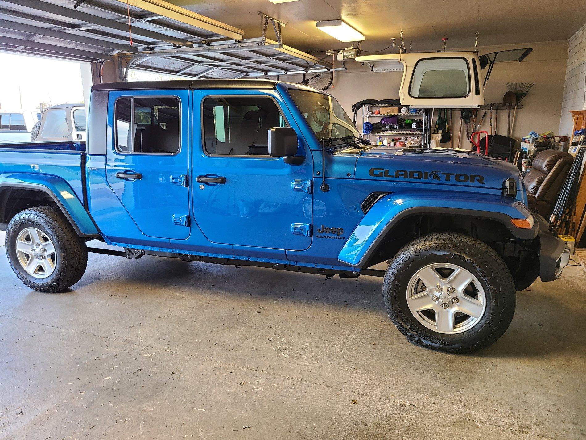

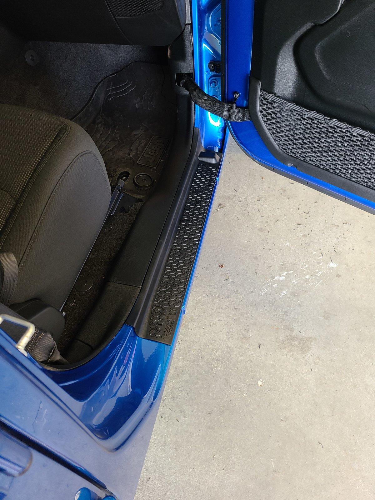

I installed the rugged ridge sills a little while ago. I forgot to mention i also have the hot heads headliners to install. I'll work on that later after getting some acetone.

Absolutely, I'll be in here talking about that lift once it's installed. I plan on driving it liftedand on stock tires until I have the money for the tire and wheel package.
In the meantime, I installed rough country Al2 aluminum steps tonight. It was an easy install and the steps are super lite.

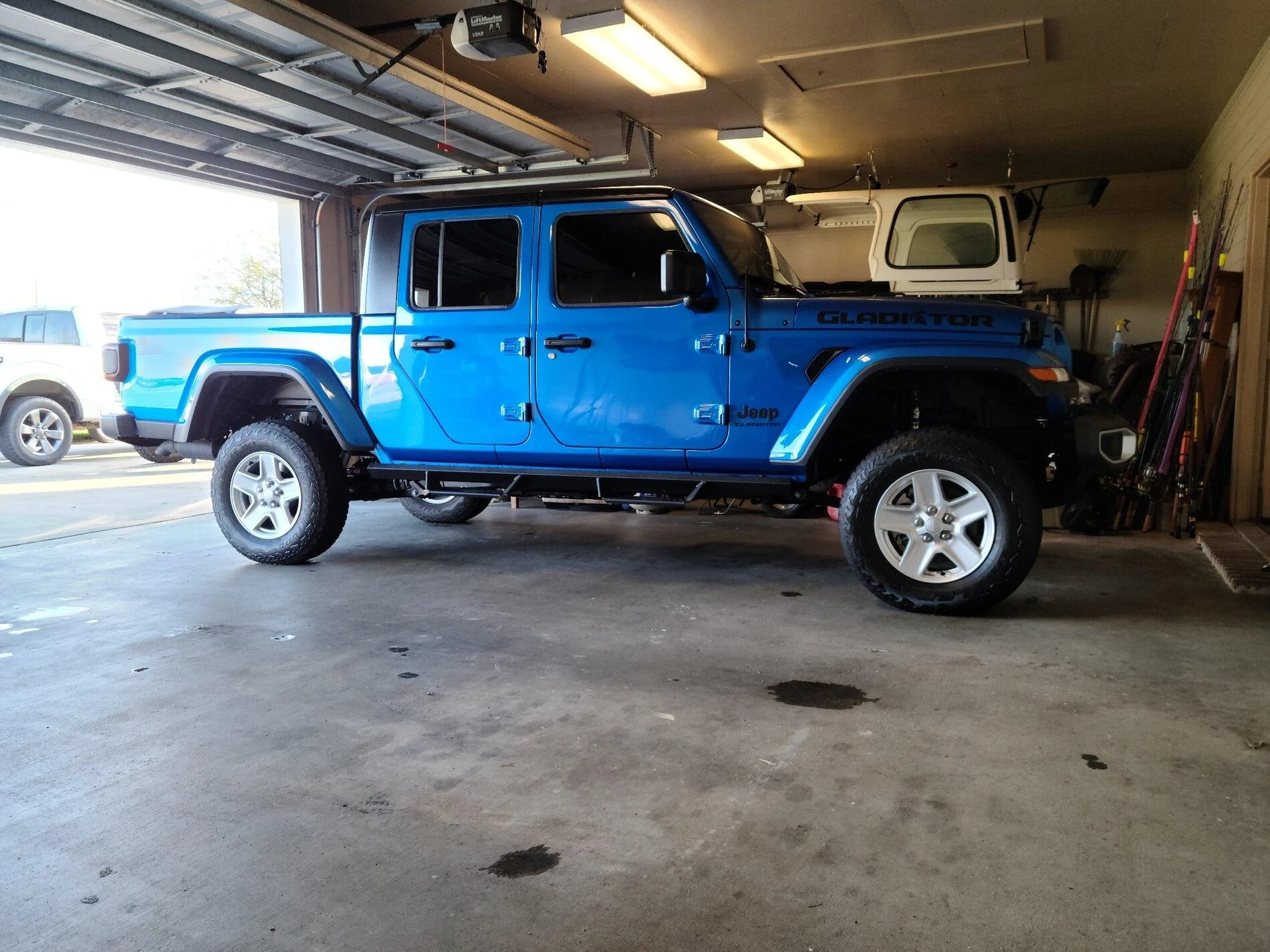

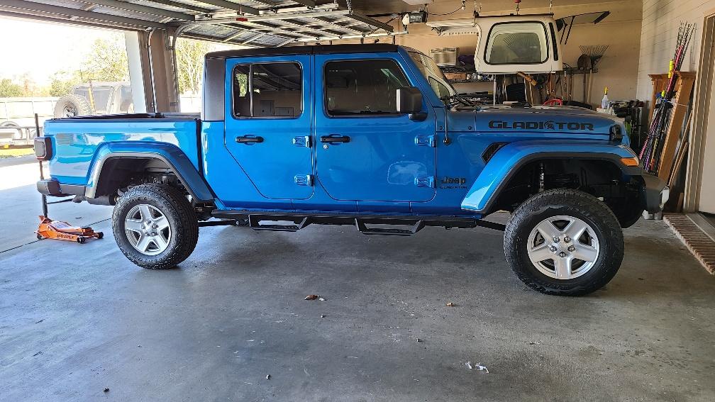

So, I am attempting the suspension lift install on my Sport S diesel. I have run into a problem with the passenger upper control arm frame side bolt. I cannot get it out because the exhaust down pipe is right next to it and won't let the bolt come out. The bolt is too long and hits the exhaust down pipe.
Well, I just cut the dang bolt....wasn't too bad.
Ok, I got it on and dialed in. I'm still on stock tires while I wait for the 37 bfg ko2's to get out of quarantine.
The ride is just like stock! Maybe even more controlled feeling...not nearly as much floaty sway feeling. This kit is a home run!
I took plenty of before measurements and angles in order to make it easier to dial in. I'm very very happy with it.
Clayton sent 3.5" front springs to compensate for diesel weight ( I ordered a 2.5" lift) she sits nice and level still on stock tires and wheels.

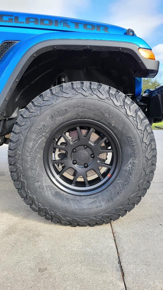

Yes, I did the bumper jump thing...neighbors thought i was crazy! I had the angle finder all over it before the lift and set it all back to the same or as close. Exception is castor, I set it about 1 degree more + as best as I can tell. I like a little more castor feel.
I looked at the bronze wheels, but in the end I'm keeping it black and blue.
Attached is how I set the toe 1/8" in.

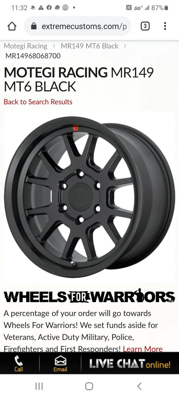

Also, the wheels I'm using is the Motegi MR149 which is 25lbs.

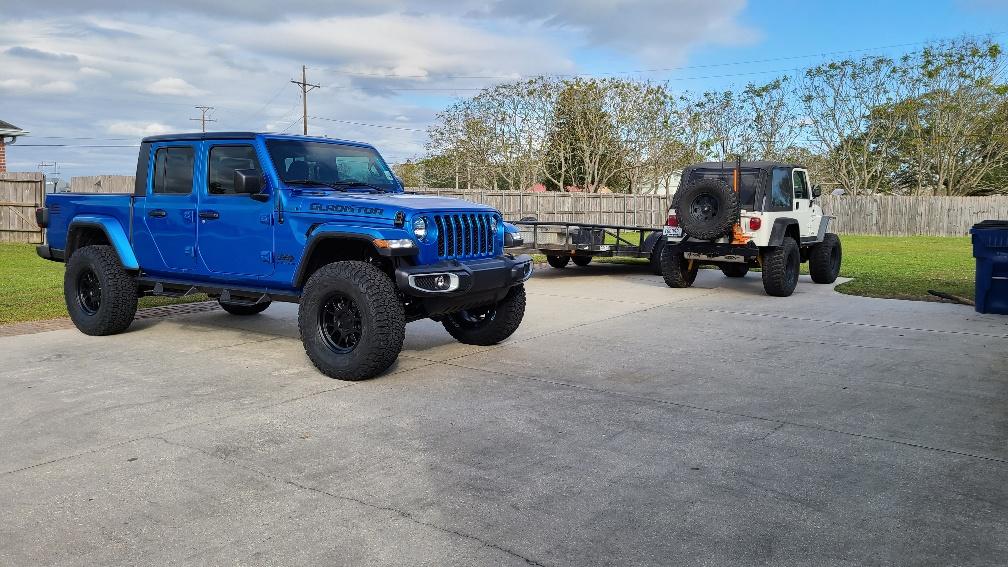

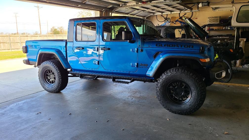

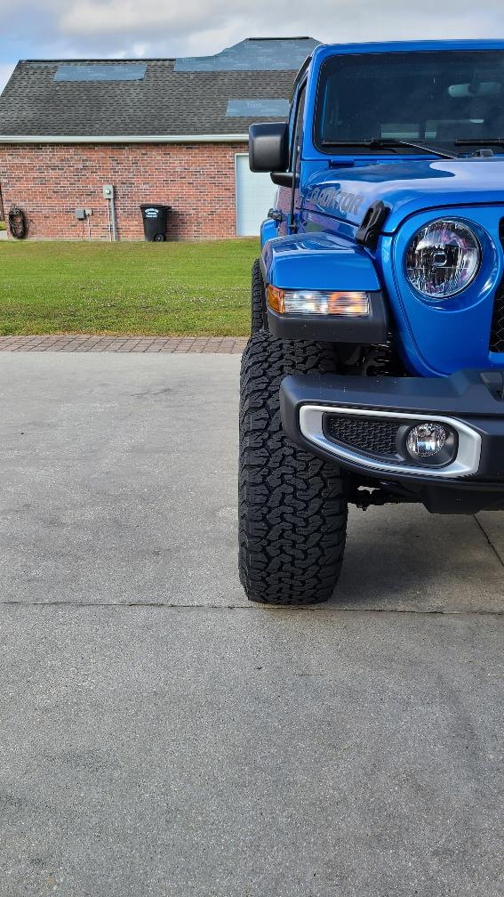

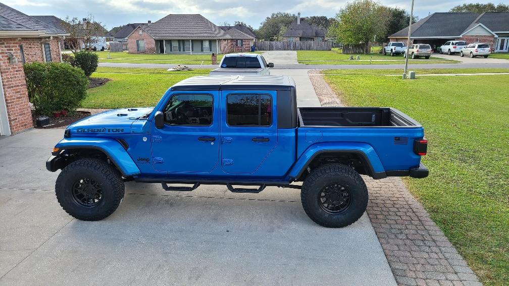

The bed is now lined and the tires are on! 37x12.5x17 BFG KO2 on Motegi MR149 with 0 offset. No rubbing or vibration and drives smooth. I love it. TPMS are not working, I'll deal with that at some point.

Well, I only have 1270 miles on it so far. Mostly city driving with mileage at 21 mpg. I have been mashing on the skinny pedal because it brings smiles....I cannot feel any loss in power and I thought I would. Still haven't been able to get a front end alignment due to working out of town, but once I do it will have some highway miles. We will see if the mileage gets better. Oh, I keep the tires at 30 psi.

I went with the fox 2.0's and I feel it rides perfectly fine and I couldn't justify spending the extra for the falcons based on the nice ride I have now.
Immediately after the lift while on stock tires, I measured exactly 3.5" of lift in the front and 2.75" of lift in the rear. When the smallish 37" bfg's went on - the front went up another 2.5" and the rear also went up another 2.5".
I didn't use the 1 inch spacer as I figured the 3.5" front springs would be just right with the weight of the eco diesel. I still have the spacers because I plan on a front bumper and winch at some point.
