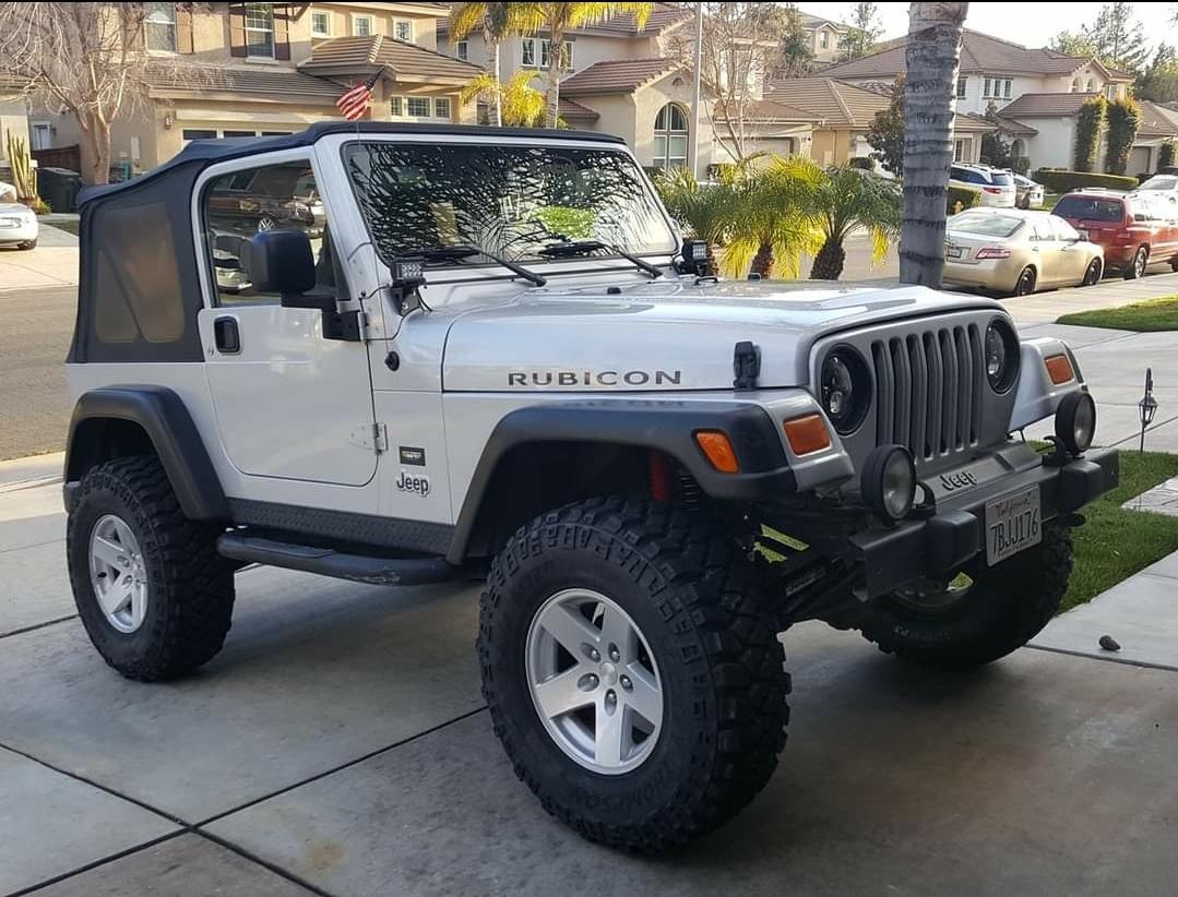

So this Jeep Mojave is my 3rd Jeep. I started with a 2006 TJ Rubicon and just sold my 2016 JKUR Hard Rock to buy the Gladiator. I'm a Rock Crawler by nature having run most of the difficult trails in California and Utah in my 2016 Rubicon. I'm in Southern California and have both Rocks and Desert to play in. The reason I switched to a Gladiator was for work. I'm a home inspector and wanted more room in my vehicle for ladders and tools.

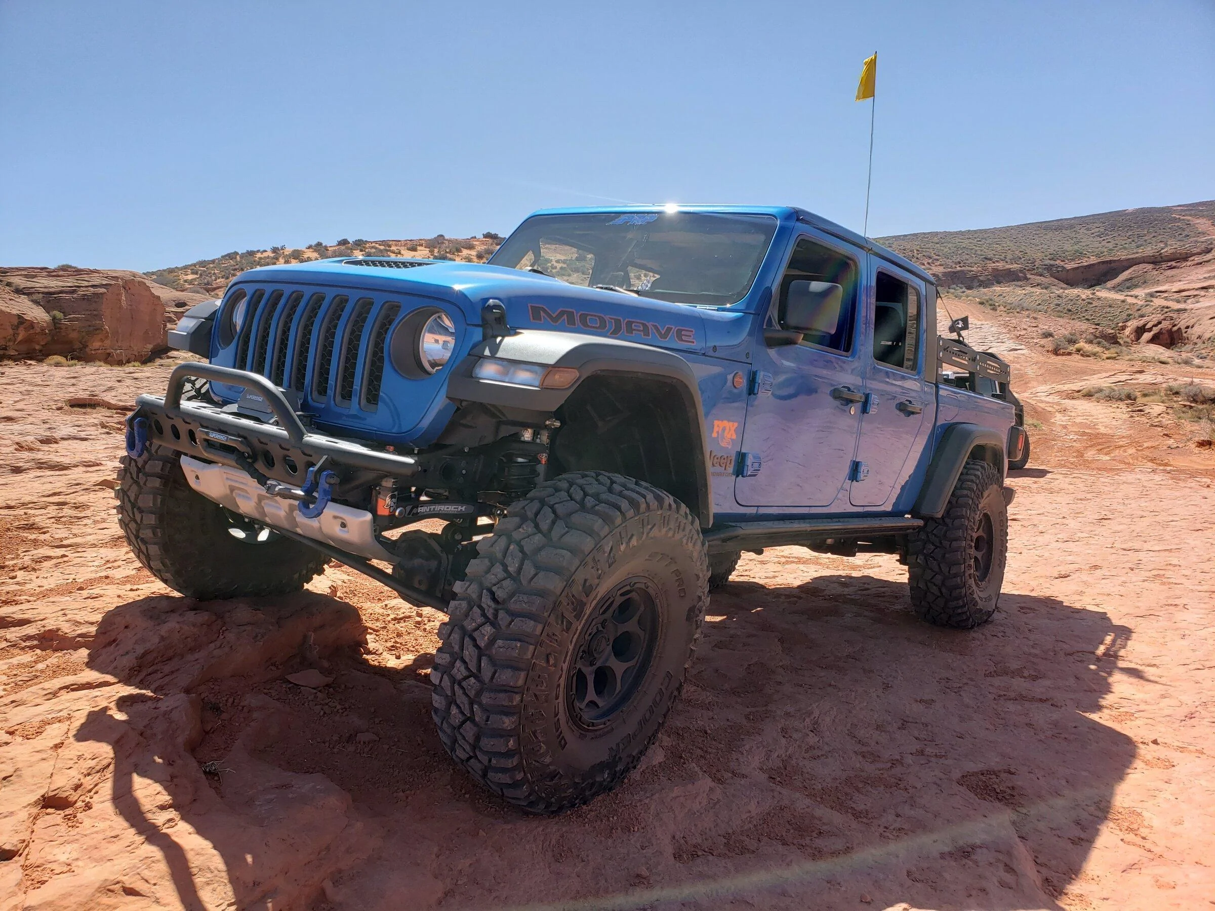

So I picked up this Gladiator in early December 2021 in Arizona. Got a fantastic deal on this Mojave buying it in Lake Havasu which is only 4 hours away from my California resisdence. Because I'm a rock crawler I know a Rubicon or even a sport would have made more sense to start the build with but I fell in love with all the Mojave had to offer.

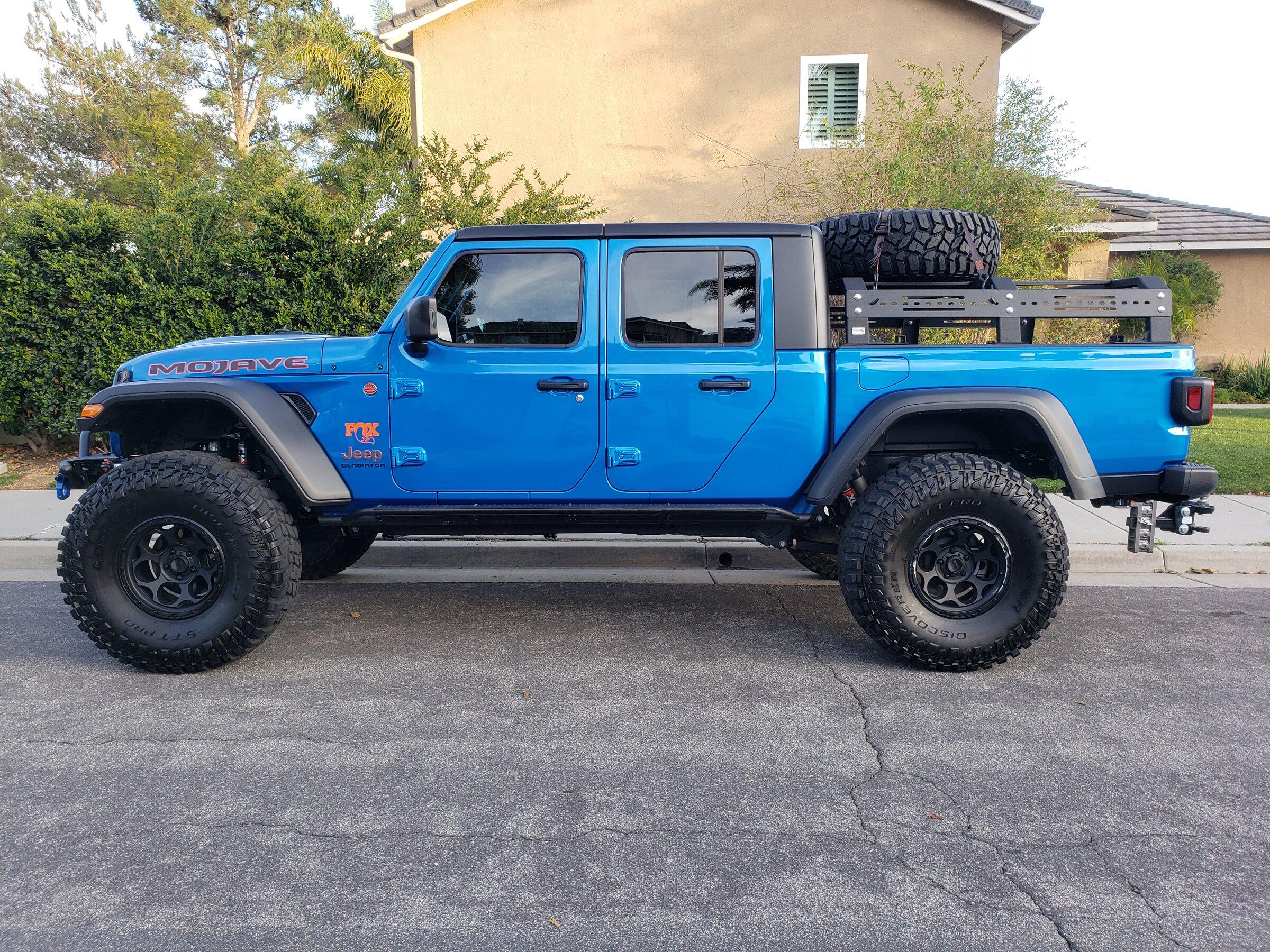

So the plan was to immediatly get to 40's so I could hang with all my friends who are in JK's on 37's and 40's. So below is a list of modifications either already done or ordered plus a wish list of modifications down the road.
40" Cooper STT Pros on 17" KMC Dirty Harry Wheels
3.5" Clayton Off-Road Overland Plus Lift Kit
Barnes 4WD Pritchett Canyon Bumper
SuperWinch sx10,000 (waiting on bumper to install)
Quadratec Brute Strength Sliders
Fishbone Tackle 1/2 bed rack
Adams Front Drive Shaft 1350
Fox 2.5 Elite Resevoir Shocks with DSC for 4.5 lift
RockJock AntiRock Front Swaybars
Tazer JL Mini Controller
Apex Steering Booster
5.13 Revolution Gears
MagnaFlow Exhaust (Before the axle dump)
Future Plans:
Truss the front and rear axles
Upgrade the Tie-Rod and Drag-Link to an Aluminum Option
Fox Steering Stabilizer
Synergy or Steer Smarts Sector Shaft Brace
Upgrade the cloth interior to a PRP Seat Cover
Hign-Line Fenders / Brace

Thanks. I'm going to get it out on the rocks this coming Sunday to test out the flex and see how the Jeep performs. Most likely will need to go with a fender chop kit also to not rub with the 40's.

Let me start with, sharp rig!
What’s the tape measure read on the coopers, close to 40”?

Mounted on the Jeep with 30 PSI they measure in at exactly 39"

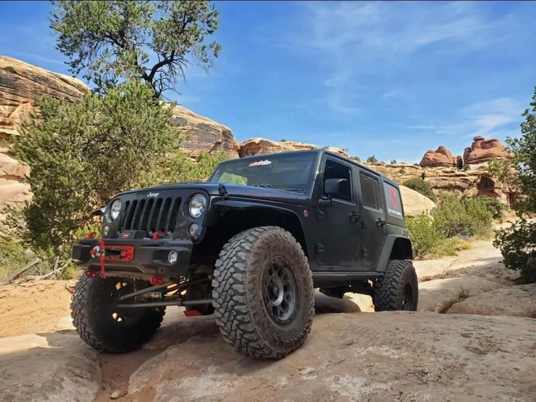

Knock on wood I've never had to be that guy yet. My JKUR had 37's with stock Rubicon axles that were reinforced and I wheel with guys much more built than me and seen plenty of breakages. Being overbuilt is awesome and I wish I was but I feel confident in my order of operations.
A couple of the choices I've made since I'm on 44 axles is to keep the tires on the lighter side and same for the wheels. I have friends on 37" Nittos and Toyos that are like 110lbs a tire with 40lb beadlocks. My 40" tires are 91 lbs with 30 lb wheels. I know rolling resistance and leverage of 40's are different than 37's but I try to make informed decisions.
