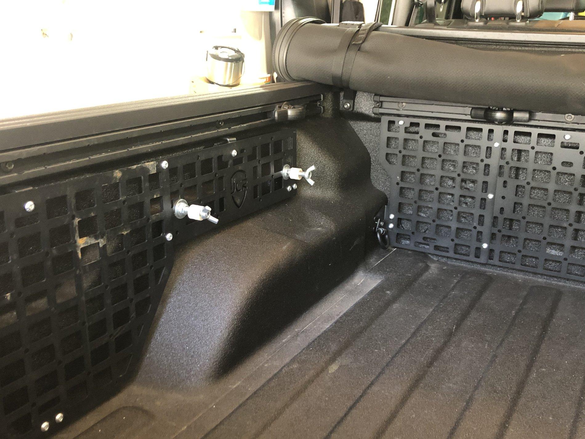

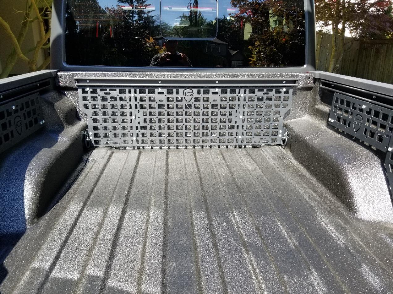

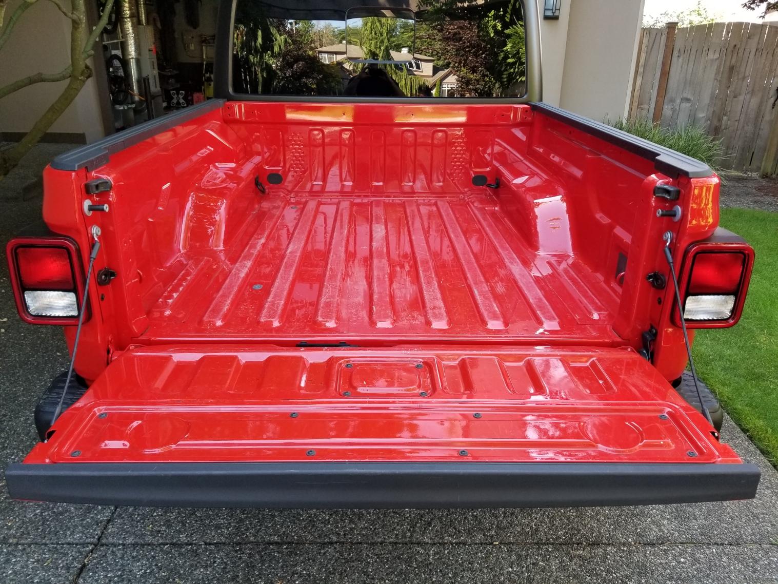

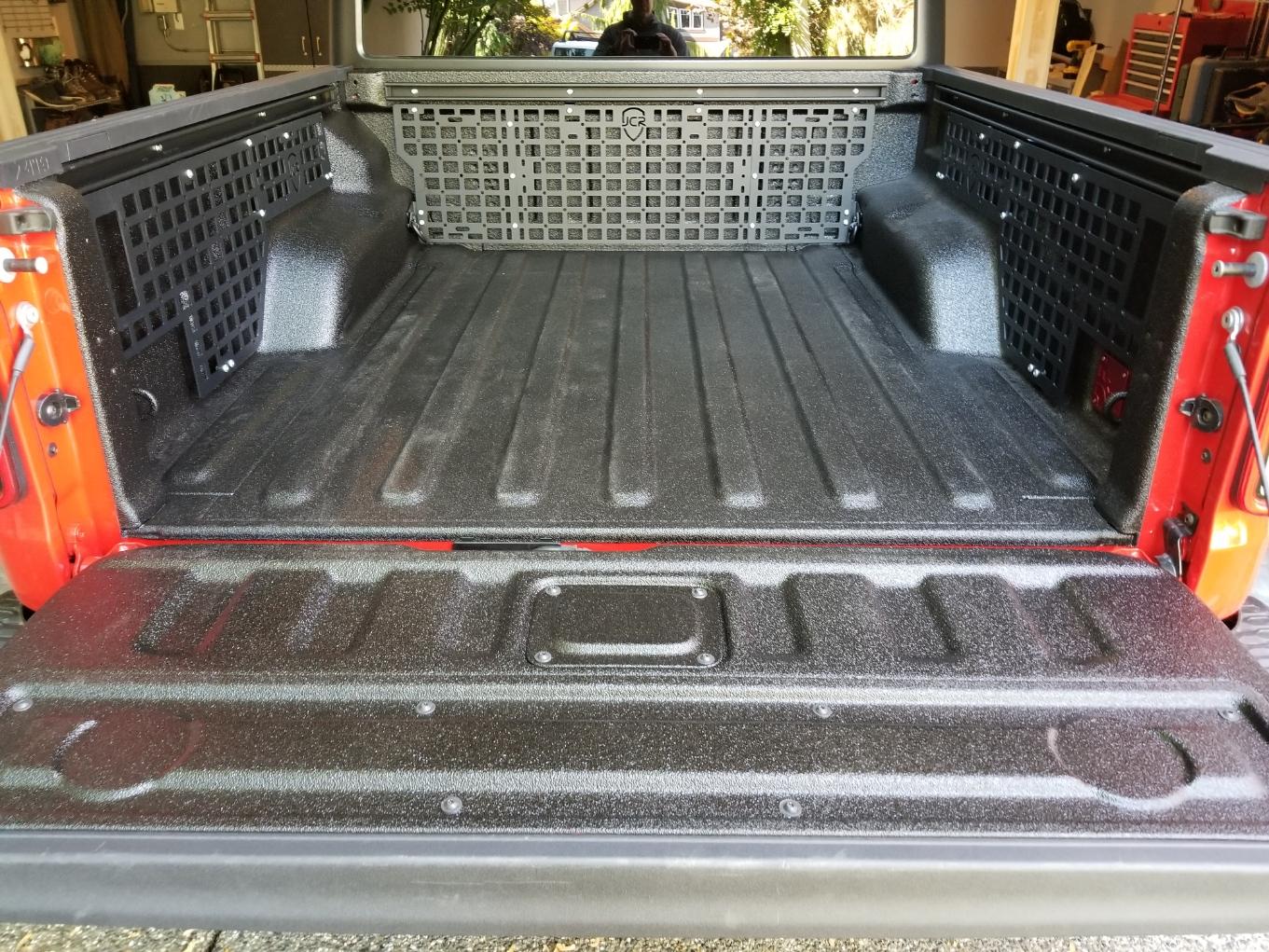

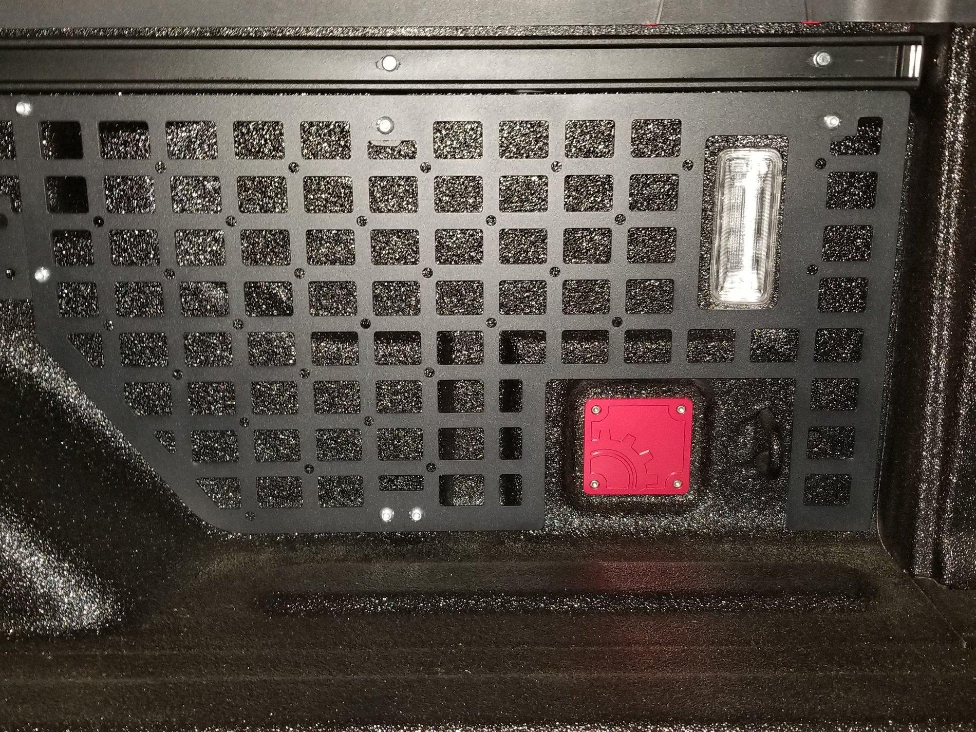

I don't think I'm covering any new ground here but figured there might be people with questions about the setup and how it looks so here you go...
Jeep Gladiator BuiltRight Bed Rails & JCR Offroad MOLLE Panels Installed TruckBedStock
Jeep Gladiator BuiltRight Bed Rails & JCR Offroad MOLLE Panels Installed 20200822_152222
Jeep Gladiator BuiltRight Bed Rails & JCR Offroad MOLLE Panels Installed 20200823_113835
The guys that sprayed in the Line-X did a good job of plugging all the holes so no real issues having to clean out any of the bolt holes like I've seen with some of the factory sprayed liners. One of the factory bolt holes for the rail system on the passenger side has some pretty messed up threads (bolt wouldn't even thread in) so had to clear it out with a tap but once that was done the bed rails went in with the supplied hardware no problem and no special tools required..
I went with the JCR Offroad MOLLE panels because they mount behind the rail system instead of into the rail system which seems like it gives the maximum amount of flexibility for future needs but I'm sure the BuiltRight MOLLE panels work great. Getting a wrench on the nuts when installing the JCR panels to the panel mounts was pretty interesting for some of them but with a little bit of patience and some thin wrenches it works.
Happy to provide any additional pictures or measurements if that is helpful to anyone.
Now to figure out a bed rack/canopy solution...

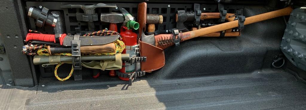

Jeep Gladiator BuiltRight Bed Rails & JCR Offroad MOLLE Panels Installed Jg105n

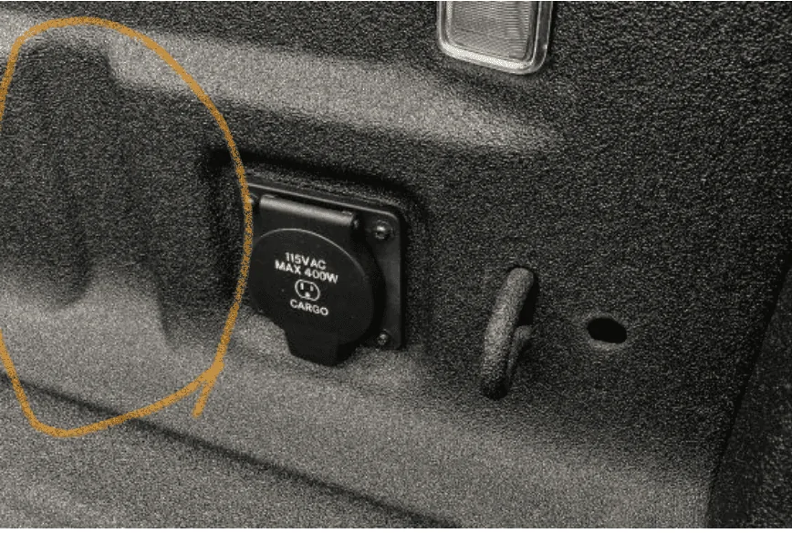

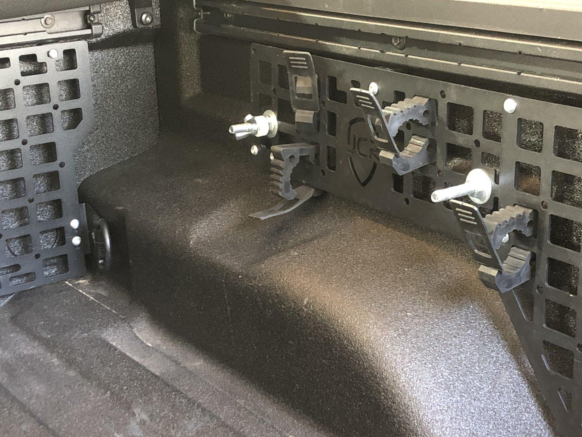

After looking at your pictures and watching the install video on the JCR website I still have a question for you. Do the MOLLE panels block the 2x4 slot on the side of the bed?
Looks great BTW
Looks great BTW
The slot is really more into the wheel well isnt it? I say no, unless I'm misunderstanding the intent.
There is also the indent at the rear behind the wheel well. Between the wheell well and the plug/ tie down.
