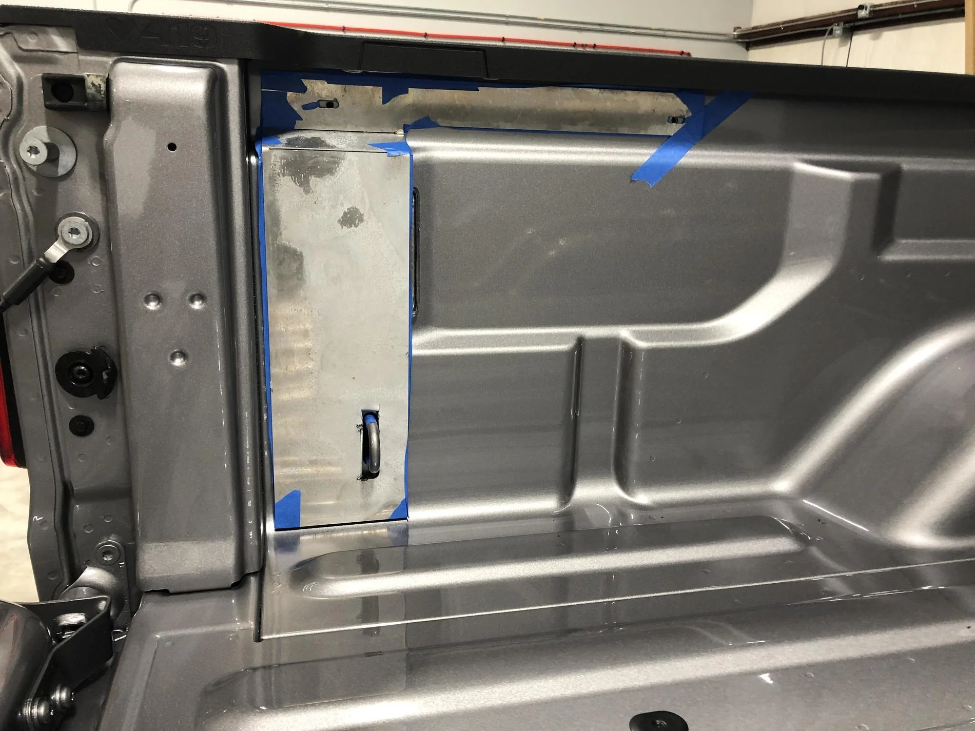

I threw together an embarrassingly rough 3D model of the contours in the bed and got to work after work one night last week. My JT doesnt have the trail rail system (although I pre-ordered the mopar kit, which will hopefully arrive soon) so I made them interface with the threaded features in the bed. Once I've got the rails, I'll revise and maybe make some adapters so they'll work for both. Anyway, to verify my model, I cut a test panel from thin aluminum and bent it up.
Jeep Gladiator BuiltRight Industries Bedside Racks - Any Interest? {filename}
Made a couple of quick adjustments and frantically sketched up a full panel to test out. From there, I 'flatten' the part in CAD, export a DXF file and bring it into a program called sheetcam, where I can generate the gcode for the plasma table. In this case, we're cutting the prototypes from 11ga mild steel.

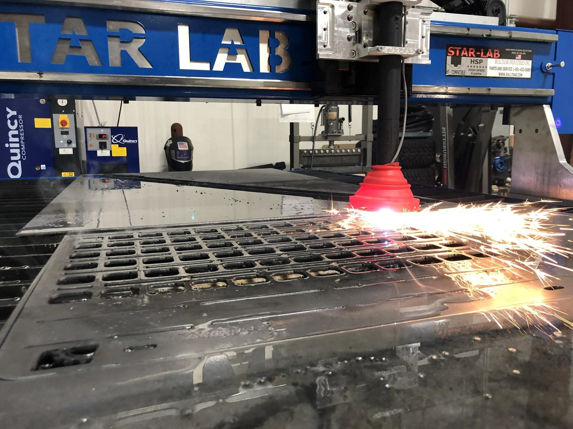

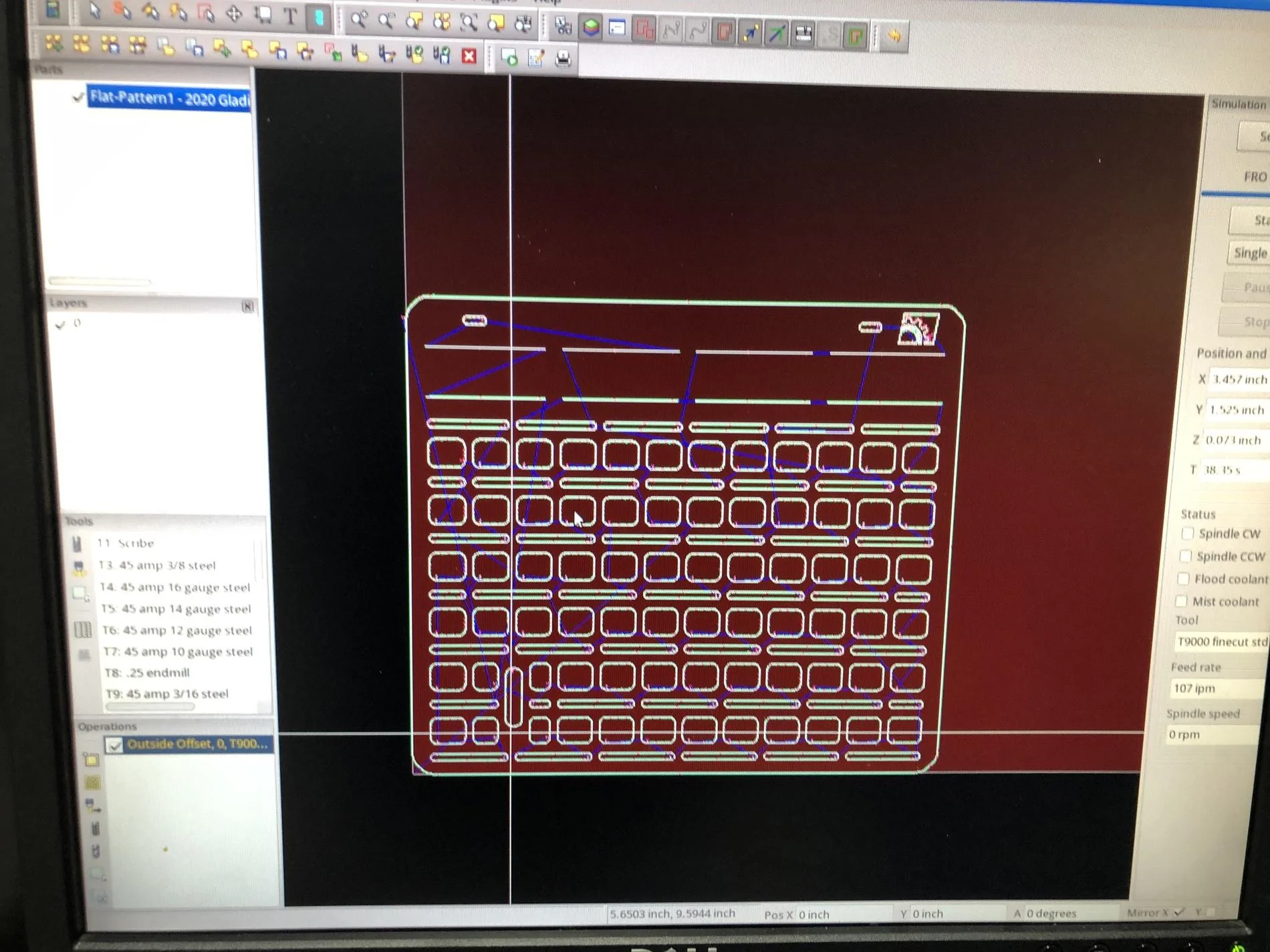

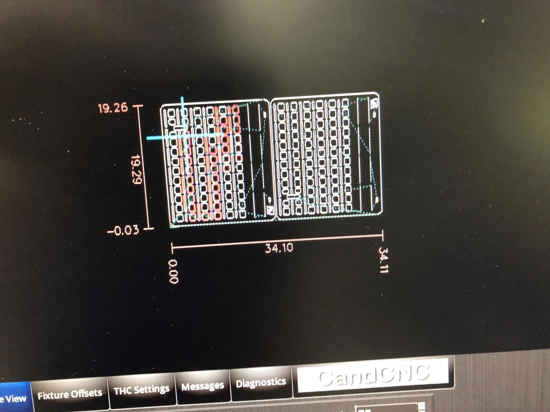

Then into a program called commandcnc, which is what actually drives the table. As you can see, I decided to live a little and cut driver and passenger side simultaneously.
Lots of cut time on the plasma table, but it went smoothly. My table has automatic torch height control, so as the plate deforms with the heat of cutting, the torch head maintains a proper distance and keeps the cut clean.

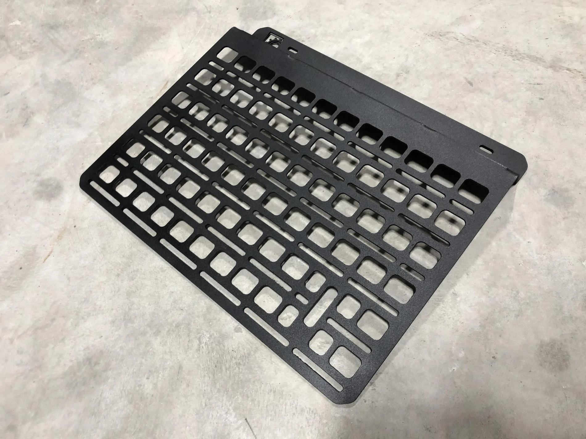

I didn't snap a picture of the least pleasant part, which is deburring the parts and cleaning them up, but these cut pretty well, so it didn't take much. Went ahead and bent them up using our little SWAG offroad finger break. This picture shows the cut quality we're getting from this Starlab table - pretty impressive for a plasma cutter.
Finally, shot it with some paint and let it cook in the driveway before installing.

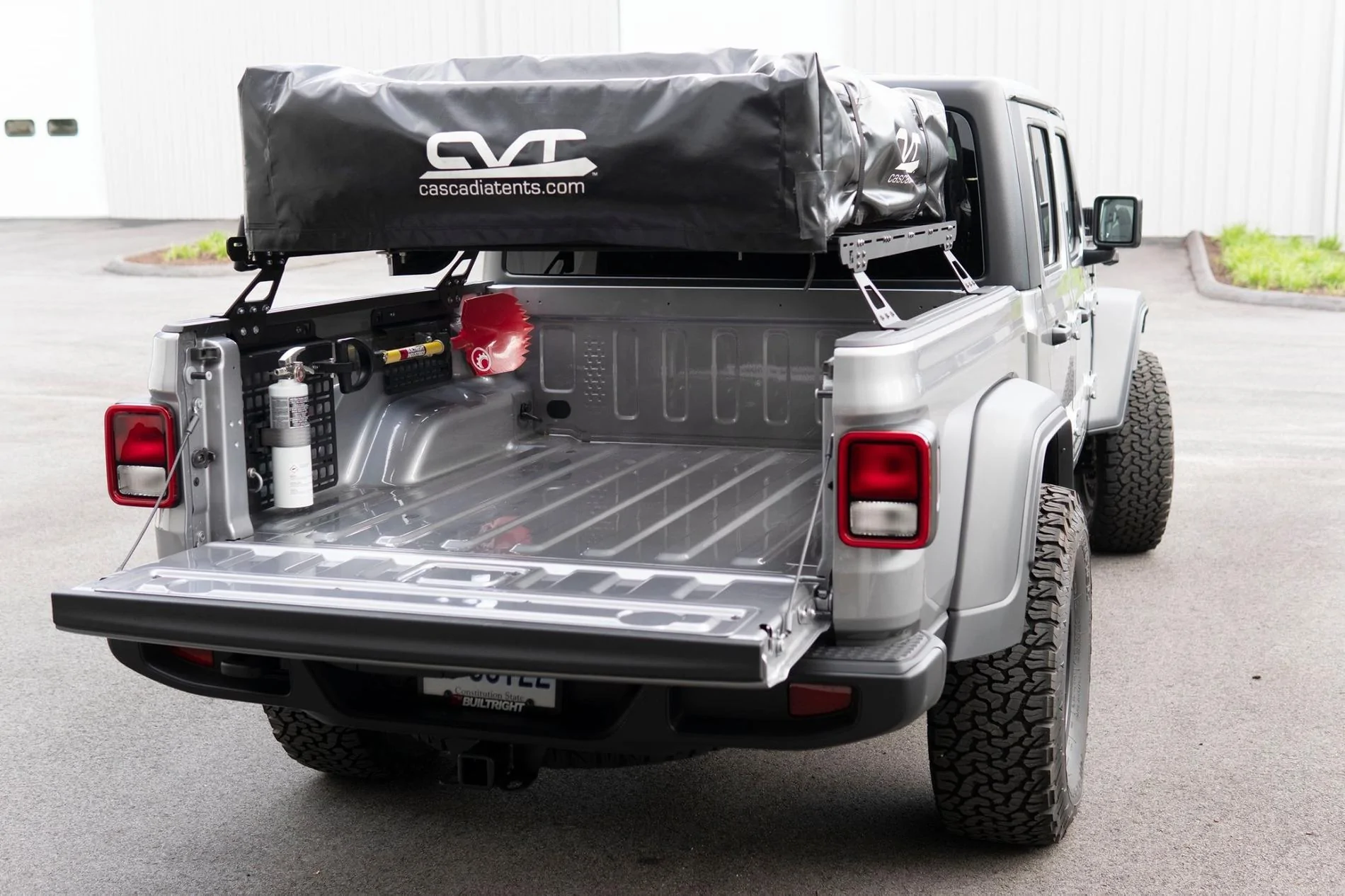

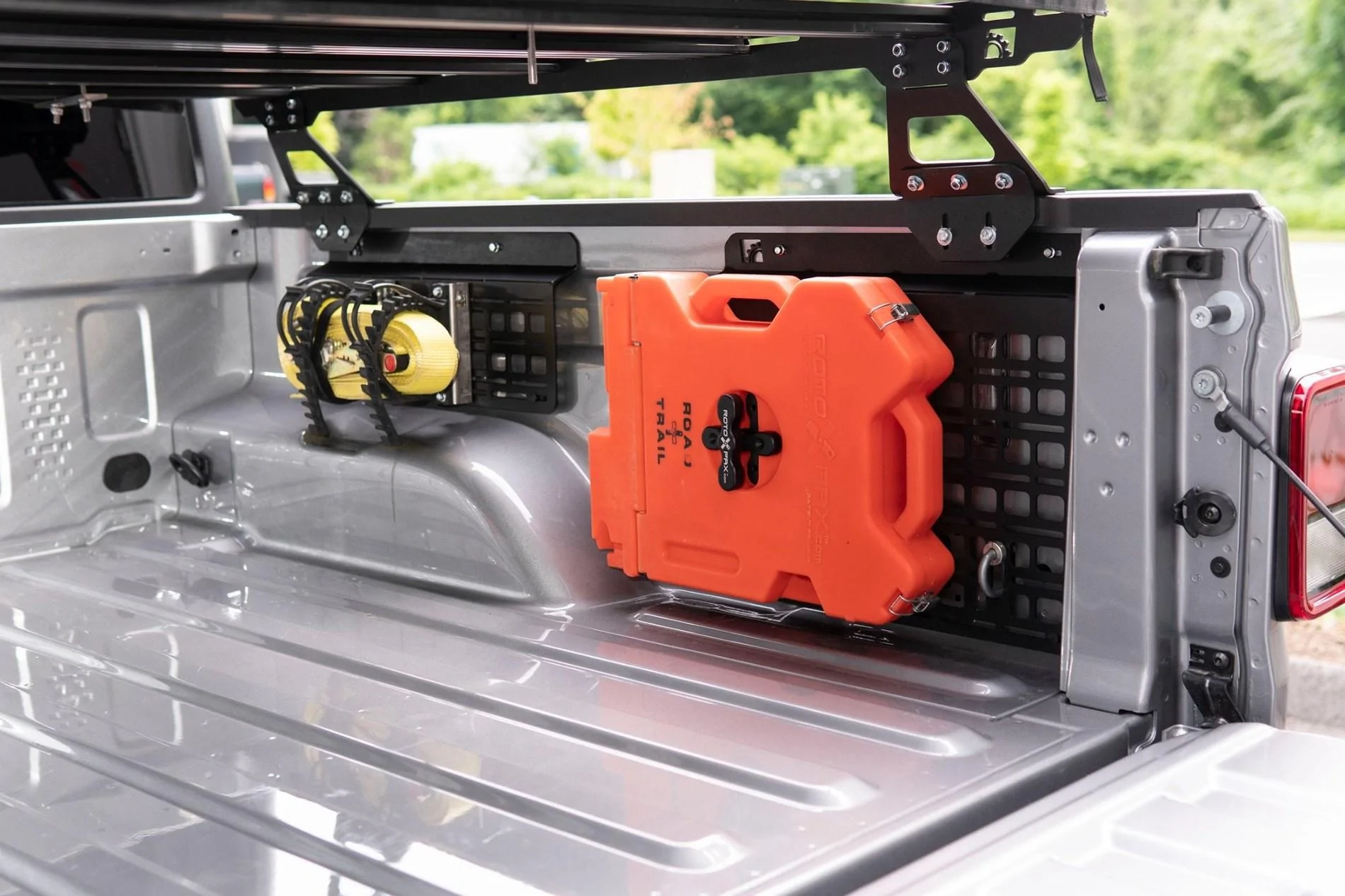

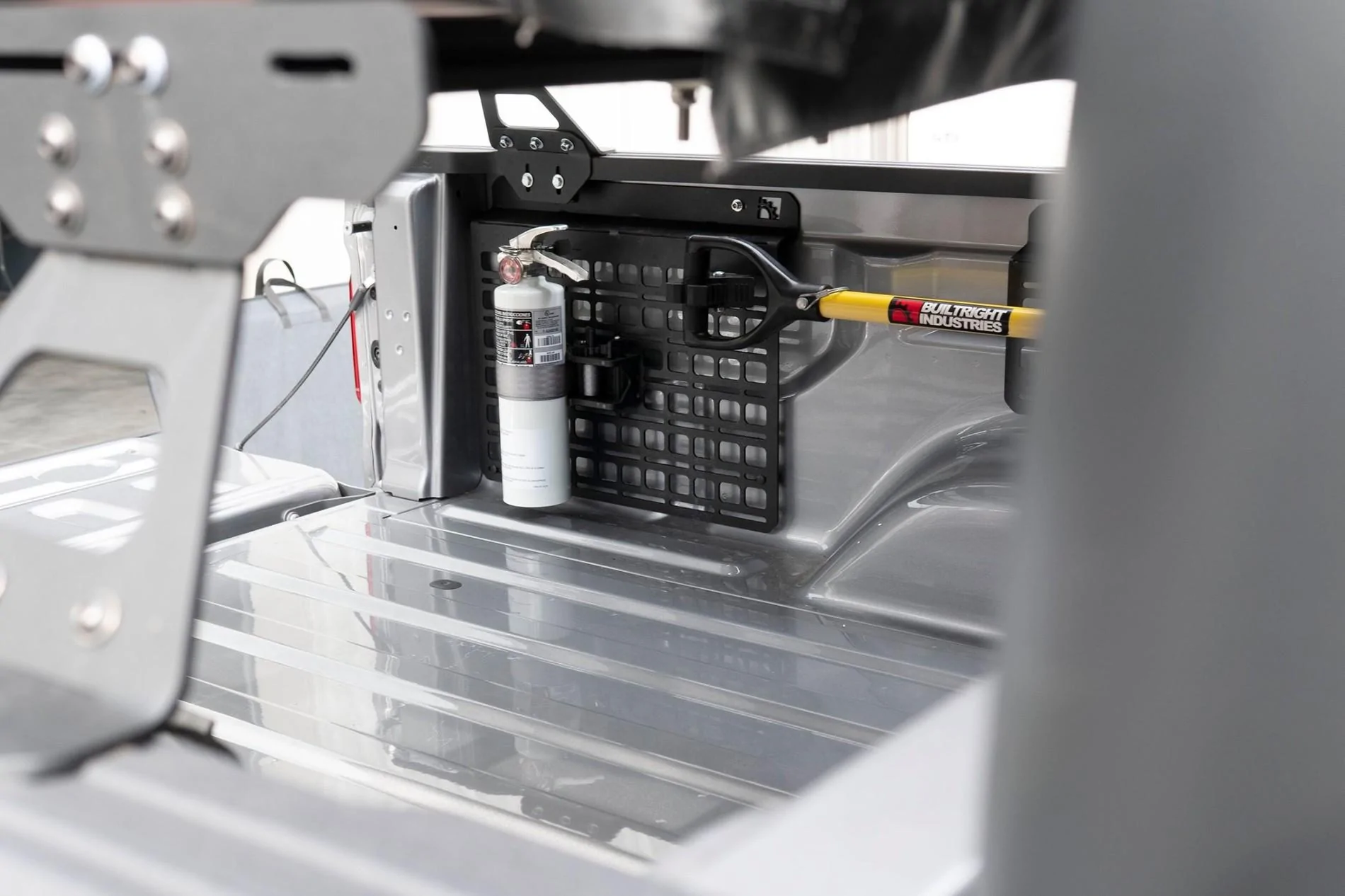

I finished the other side as well as some front panels and got them installed and attached some gear. I'll put some miles on them to make sure everything is good, but I'm super, super happy with how they turned out. This post juuuust might be the unofficial introduction of our first product for the JT platform. I'm excited to revise them for the trail rail system and refine the lower mounting point a bit, but for a first revision, these are super close. I took some 'installed' photos this afternoon, so I'll pull those off of my camera tonight.
Update: Those installed photos as promised
On the driver's side, I've got a fire extinguisher and my Krazy Beaver Tools shovel, secured using a pair of our Riser Mounts.
On the Passenger's side, I've got a pair of our Super Clamp Riser Mounts securing a tie down strap and our Rotopax Adapter Bracket along with a Rotopax mount and gear can.

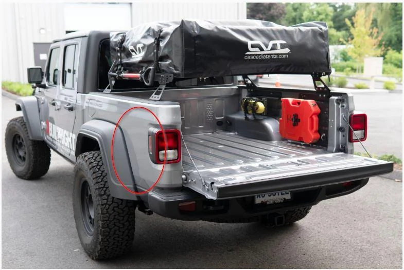

  4. Perhaps you could come up with something that makes use of the space outside the bed behind the rear fenders for mounting rotopax, like the wayout concept but not set into the body:
