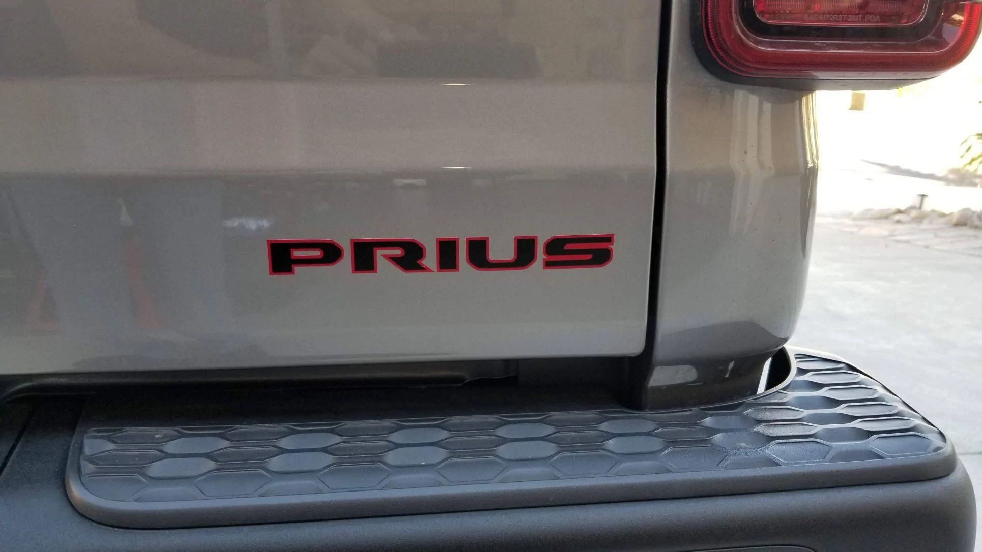

Maybe you could tell the DMV that the engine identifies as a dual quad…..
Dang it - now I need a Prius emblem for the back of my car.
