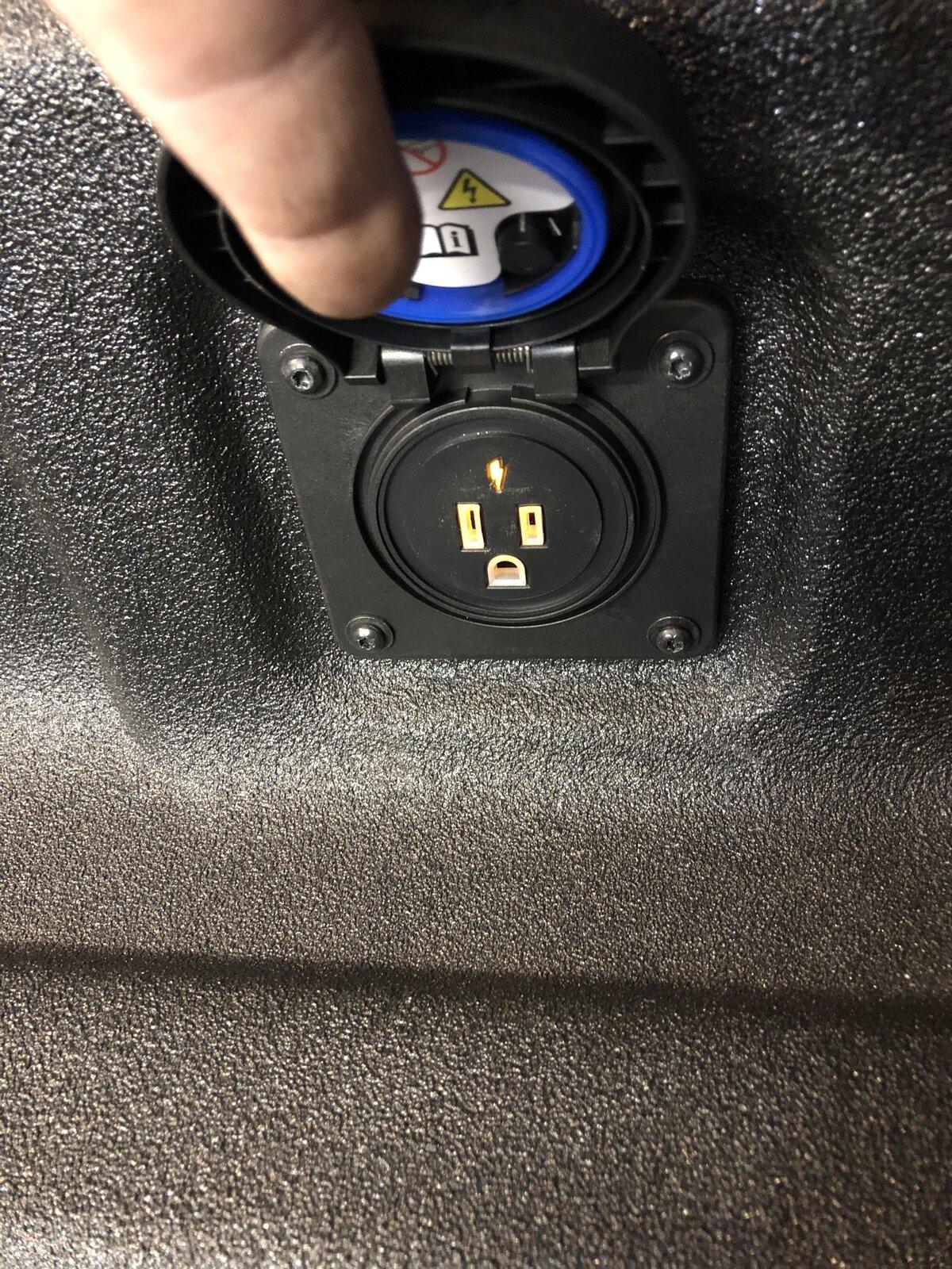

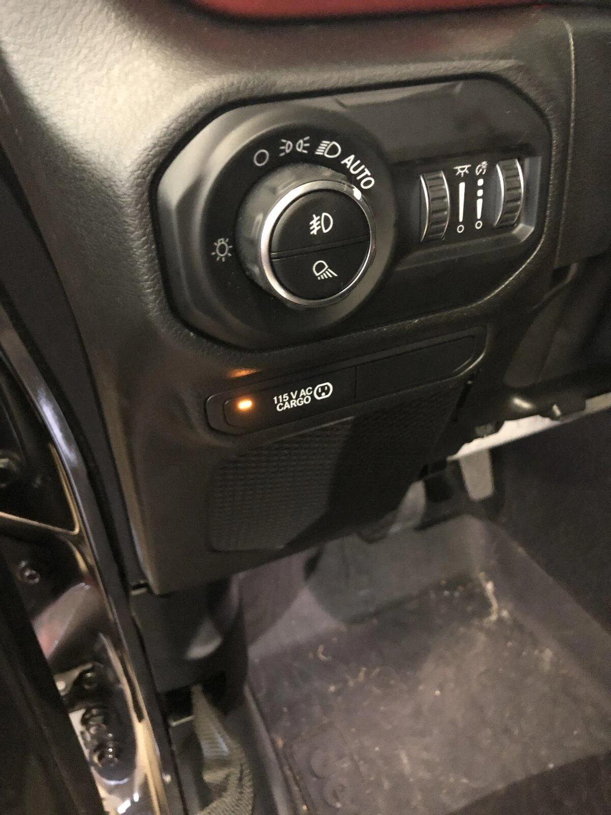

ZAutomotive (manufacturer of the Tazer programmer for JK, JL and JT) says they can help JT owners program the OE bed 110 outlet and dash switch. They need an owner who has a Tazer and has the factory-installed bed outlet to add this functionality to the Tazer. If we can get such a volunteer to do a BCM Read for them. If you're willing to help, just let me know your email address and I'll share it with ZAutomotive. Or you can text them at 631-533-3363 or email them at [email protected].

I sent them my BCM logs on Friday. Hopefully it was what they needed.
The support person at ZAutomotive says he got your file and has already written the function into the Tazer, it just needs to be tested. He had a customer that was going to test it for him, but they got rear ended and now their JT is in the shop. So we wait...

I have all the OE parts installed and am doing testing with the ZAutomotive support person. I gave him all the part numbers and he's going to put together a How To once we have it working.

This allows you to add the OE Mopar bed outlet with all OE parts. Once you add all the parts you need to enable the outlet by flashing the CPU. The dealer can't go this because they can only flash what was programmed to your VIN at the factory. So ZAutomotive is adding this capability to the Tazer.
Some of us prefer adding a second, more powerful inverter. If you don't have the factory inverter then that's what you'll need to do or add a 12-volt outlet instead. Either way this thread won't apply to those without an OE inverter and the rear seat 115v outlet or who prefer a second inverter.
I prefer a clean OE look and plug/play install, so this is the route I'm going.

Hello All. I promised ZAutomotive that I’d let the forum know about the success.
Firmware version 11.2.4 is now released for everyone to update to.
