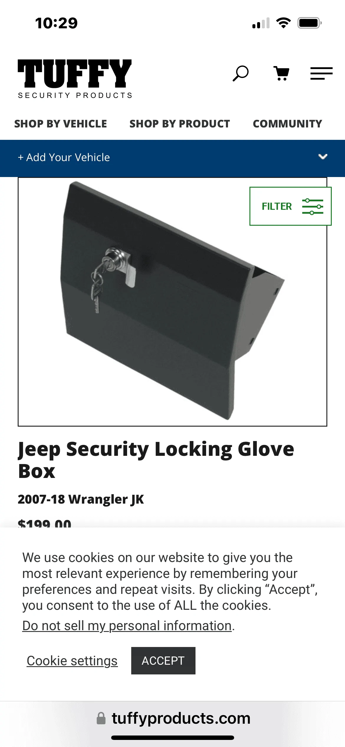

Tuffy or ? needs to make this for the JL and JT.

Security glove box? A screwdriver will get past that. It has a single point holding it in place, pull hard on the right end to distort it and she'll pop right loose.
