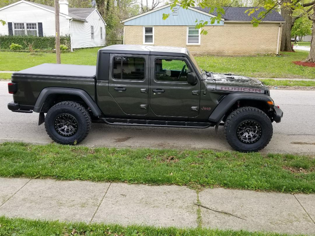

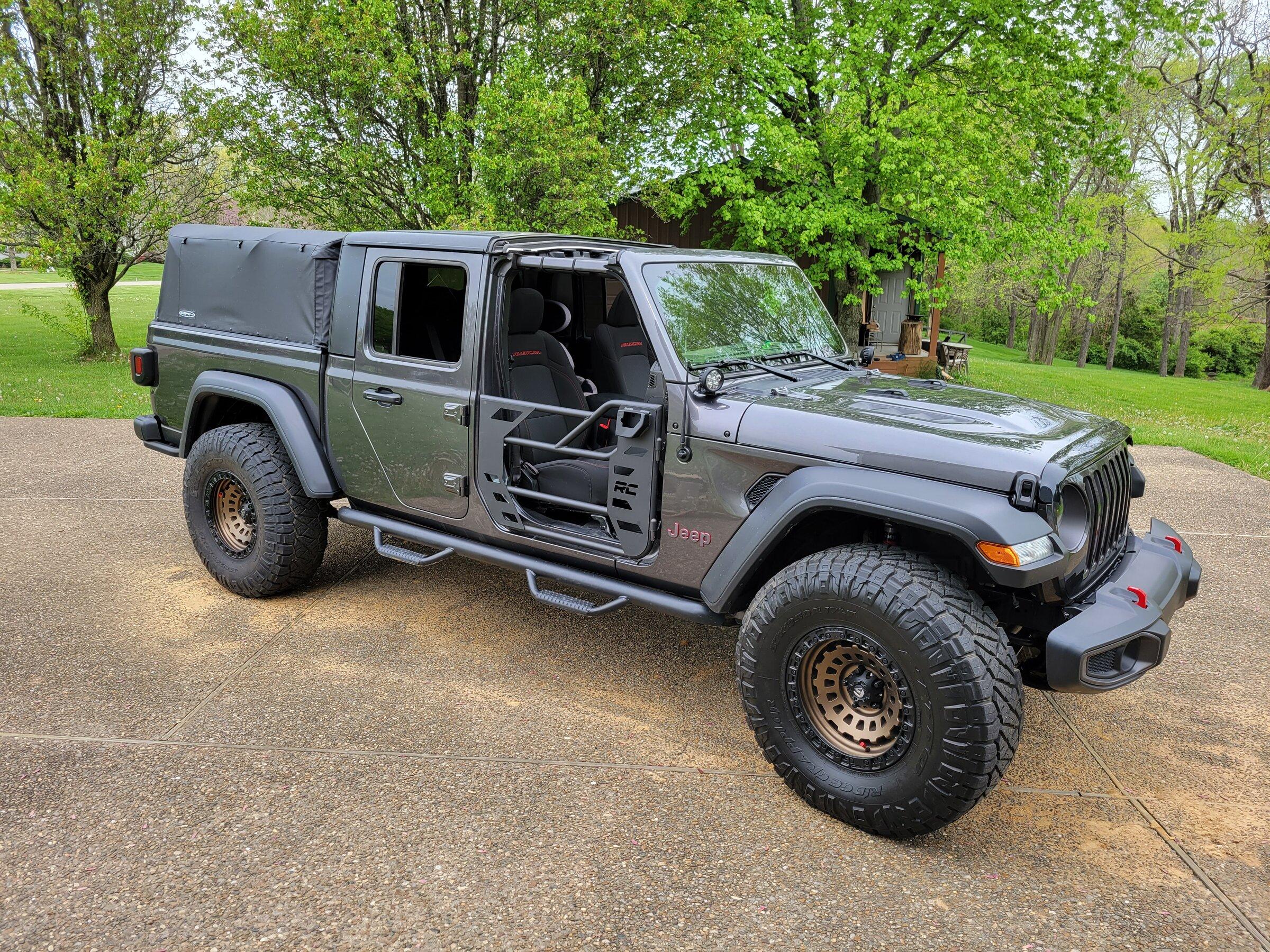

You’ll be fine. Stock rims and all.
I run 35x12.5 on stock rims and mopar lift. Even no lift would work.
