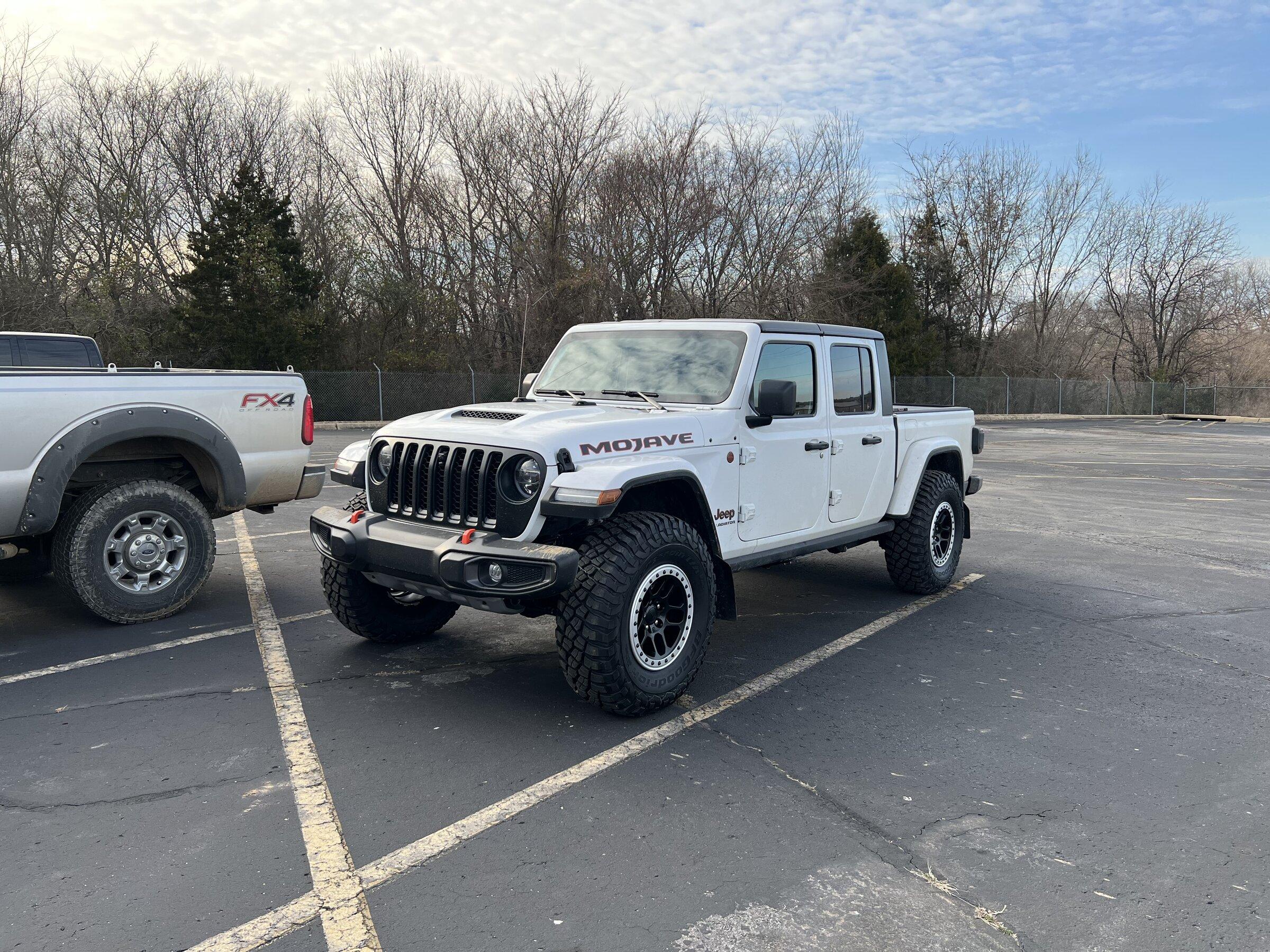

Currently i'm running MOJAVE AEV 2" lift with Dv8 non-beadlock 17x9, -12mm offset, 4.53 BS, with nitto grappler 37x12.50r17 and they clear perfectly on full turns.
I was looking to upgrade to beadlock ones but curious if Mopar beadlock wheels would clear on full turns as well with 37s 12.5 tires on'em. and wondering anyone already has run this setup
I would say it should
since Mopar weel specs are pretty close to one i have
17" x 8" Beadlock-Capable Wheel provides a backspacing of 4.4" (12mm offset)

They clear for on road use on mine before I even added my 2” AEV lift. 37” KM3
