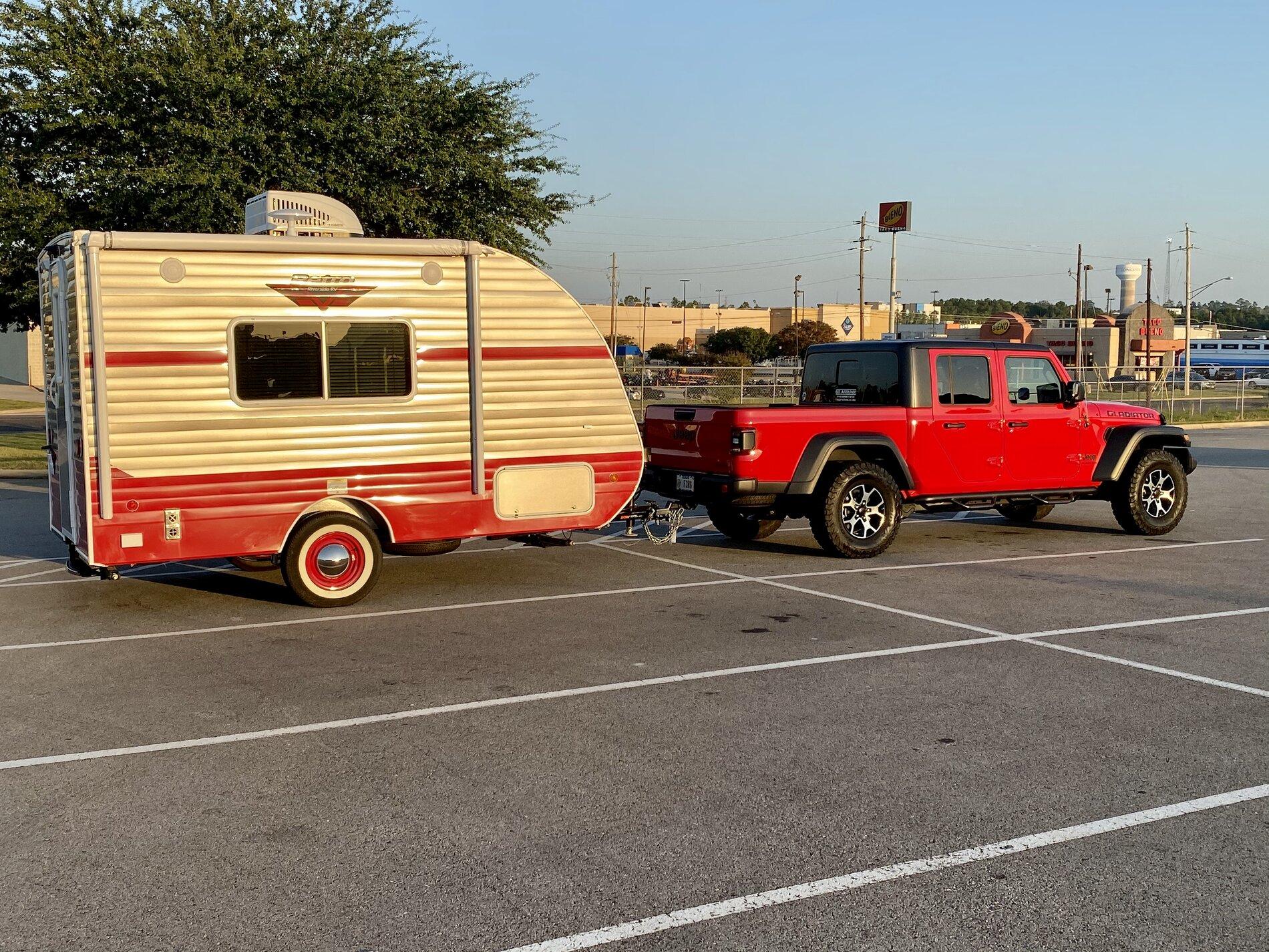

My Sport has the standard Tow Pkg. I pull my sub-4k# trailer (see below) without any problems. If you’re looking for an excellent smaller trailer (only about 20’, but still very nice), take a look at either the Winnebago Hike or, even better, the GeoPro G19FBS. My next trailer will be the GeoPro. I drool over it every time I see one!

I didn't see that picture when I first saw your post. That thing is cool as heck!

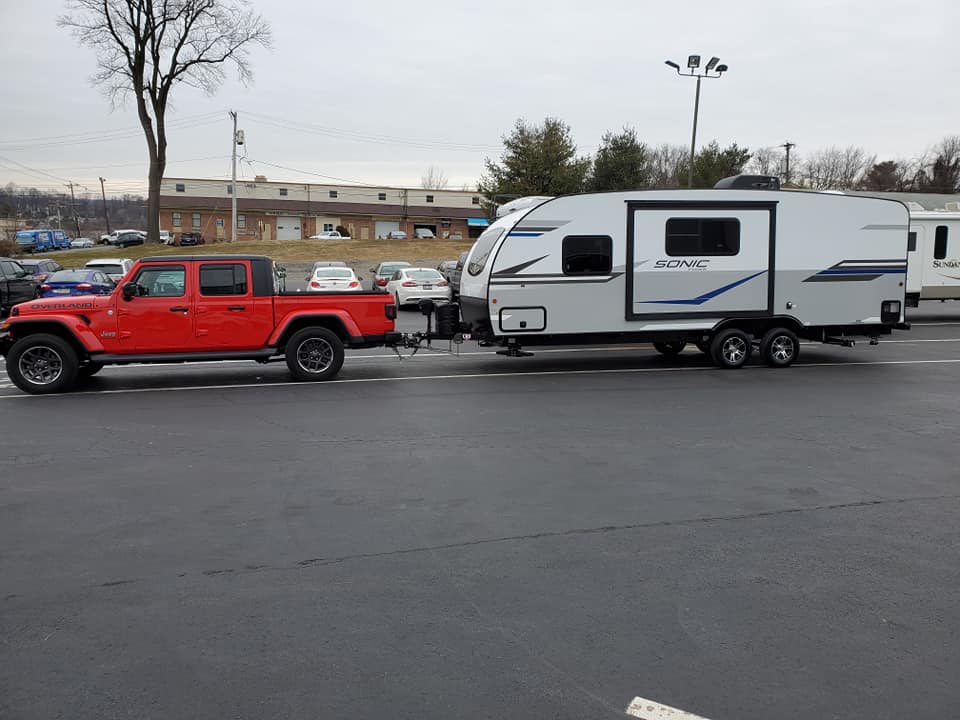

Well, I have the 2021 Venture Sonic 220VRB with the rear bath and front bed. Mine DOES have a slideout but it's roomy inside and well laid out. The bed is in the front and it's a murphy bed style. My JTO handles it just fine. It's 27' hitch to rear bumper. Weight specs:
UVW (Unloaded Vehicle Weight)*4,740
Dry Hitch Weight*430
Dry Axle Weight*4,310

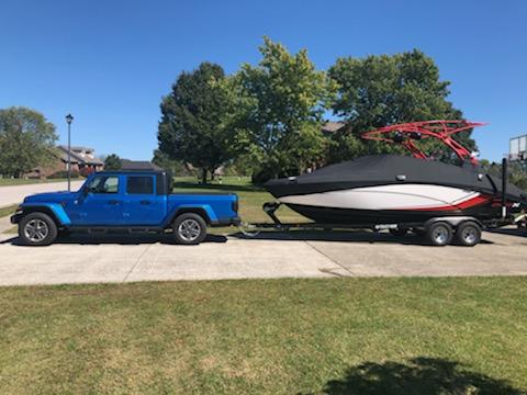

I pulled this #6,000 pound boat with a stock Sport S.
No weight distribution hitch or sway bar.
I would have no qualms doing this locally, but not for long Interstate hauls. The winds would push it around more than I’m comfortable with.

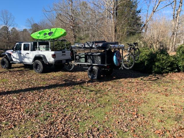

I have towed my trailer quite a bit and don't have any problems. It is only about 3000# though so a bit lighter than what you're looking at. Because mine is lighter I don't worry about payload as it all goes in the trailer. Even with mine being lighter I highly recommend electric or any form of trailer brakes. I'm sure most the size you're looking at though would have them.

Cool boat and truck! Thanks for that info - it’s interesting that you can pull that much weight around even locally without the WDH or bar. I’ll bet they’d make a world of difference, especially on the highway and in the wind. Anyway, that’s the absolute top loaded trailer limit for my truck so it’s encouraging that you’re pulling it off. Your truck looks surprisingly level in the picture. I’ve already got the WDH and anti sway bar, so I’m all set for the highway.

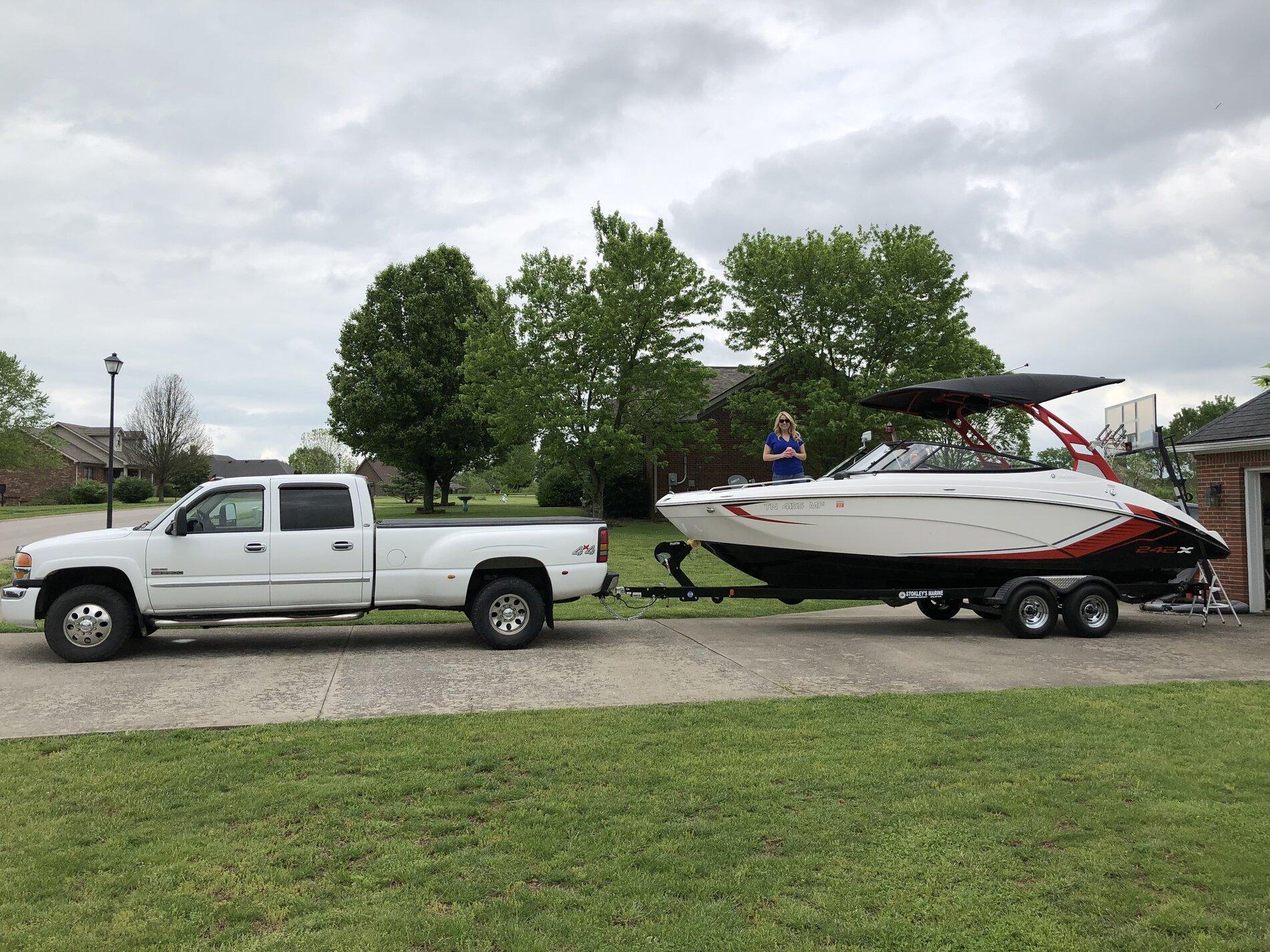

I pull with the Big Daddy, when we travel any real distance.
I’m all about having the right tool for the job!
