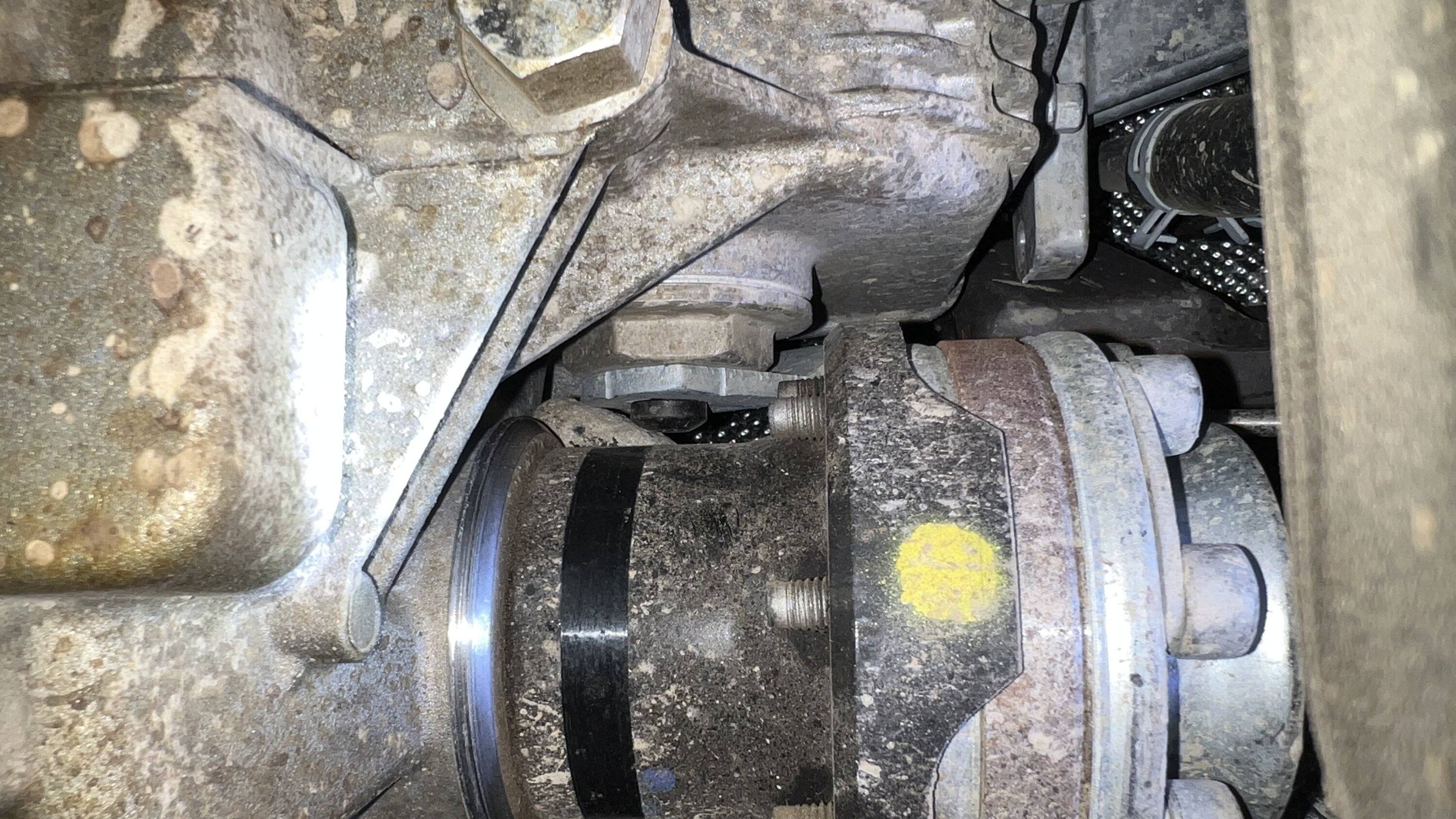

I made a post about this awhile ago - what happened to me was a small rock lodged itself on top of the transfer case where the shifter goes into the t-case. I would take a peak underneath real quick. I couldn't believe my eyes this actually happened. I was not able to shift to 4 lo

wow, that rock is camouflaged and shaped perfectly to fit into that little nook. Had to look at the picture really hard to find it.
