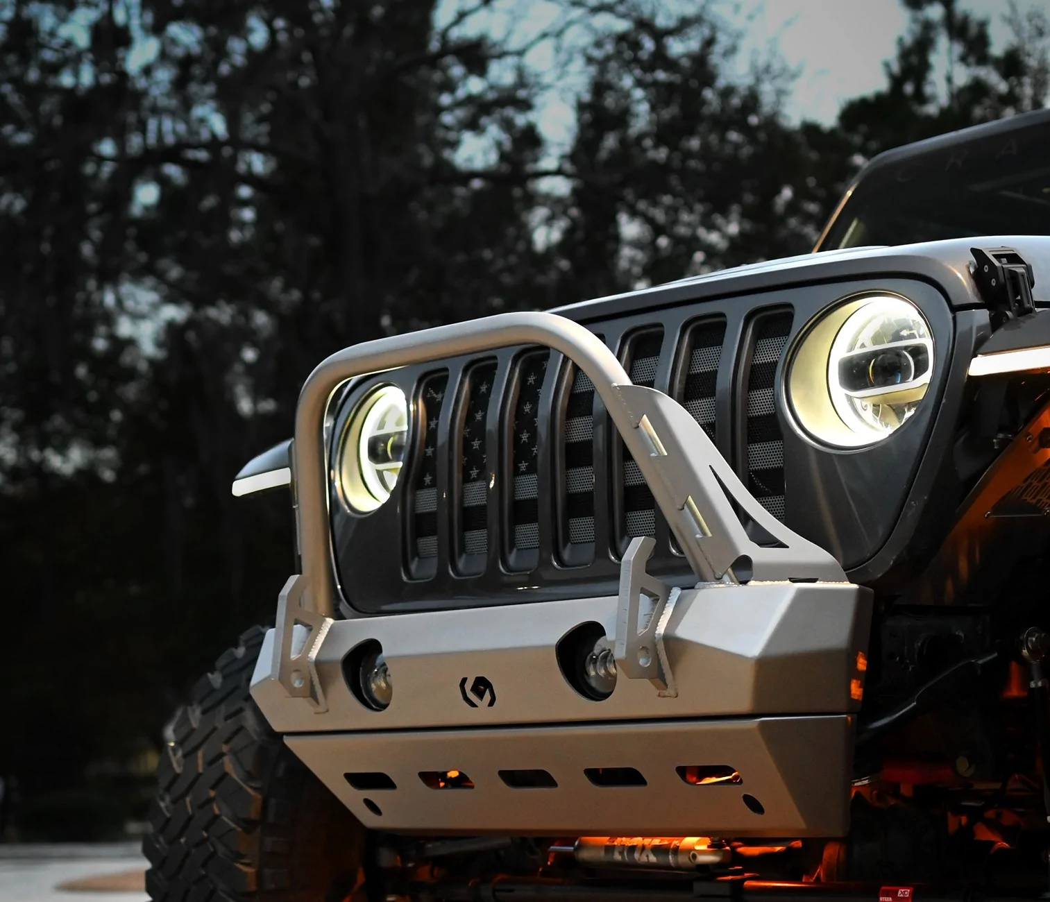

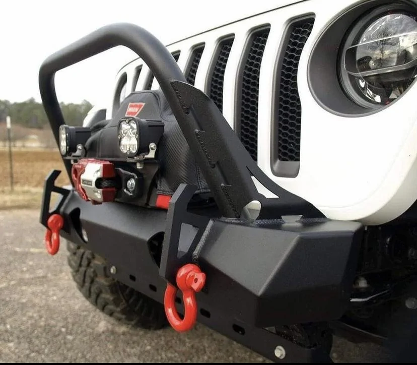

The Rampage series bumper has become one of our most popular front bumper options. Unique D ring / "Quick Hook" recovery points, and an optional Rampage Hoop. This bumper is compatible with OEM fogs (from a plastic OEM bumper) and is a direct bolt bumper (no drilling, cutting, etc).
Be sure to take advantage of our Gladiator Forum discount with code: JTFORUM
No Hoop:
https://cavfab.com/collections/bumpers-armor/products/jk-jl-jt-rampage-front-bumper-w-o-hoop
With Hoop:
https://cavfab.com/collections/bumpers-armor/products/jk-jl-jt-rampage-front-bumper-w-rampage-hoop

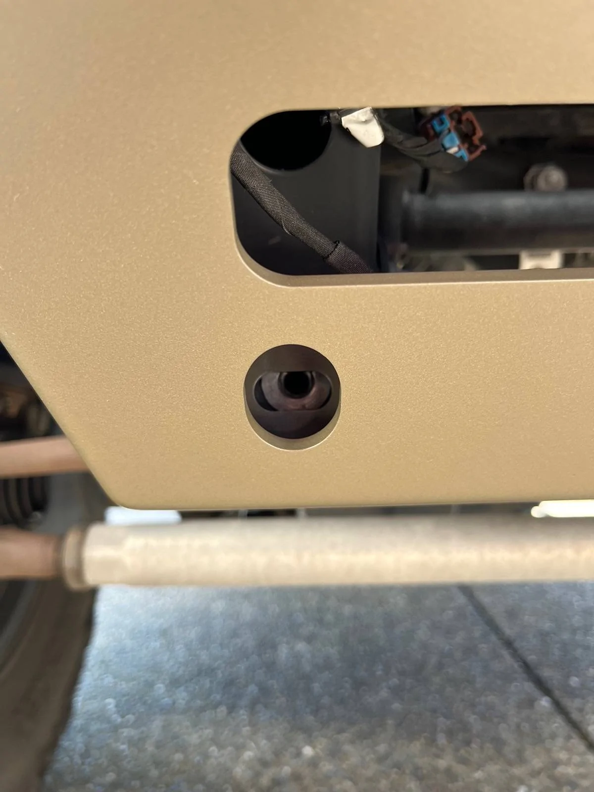

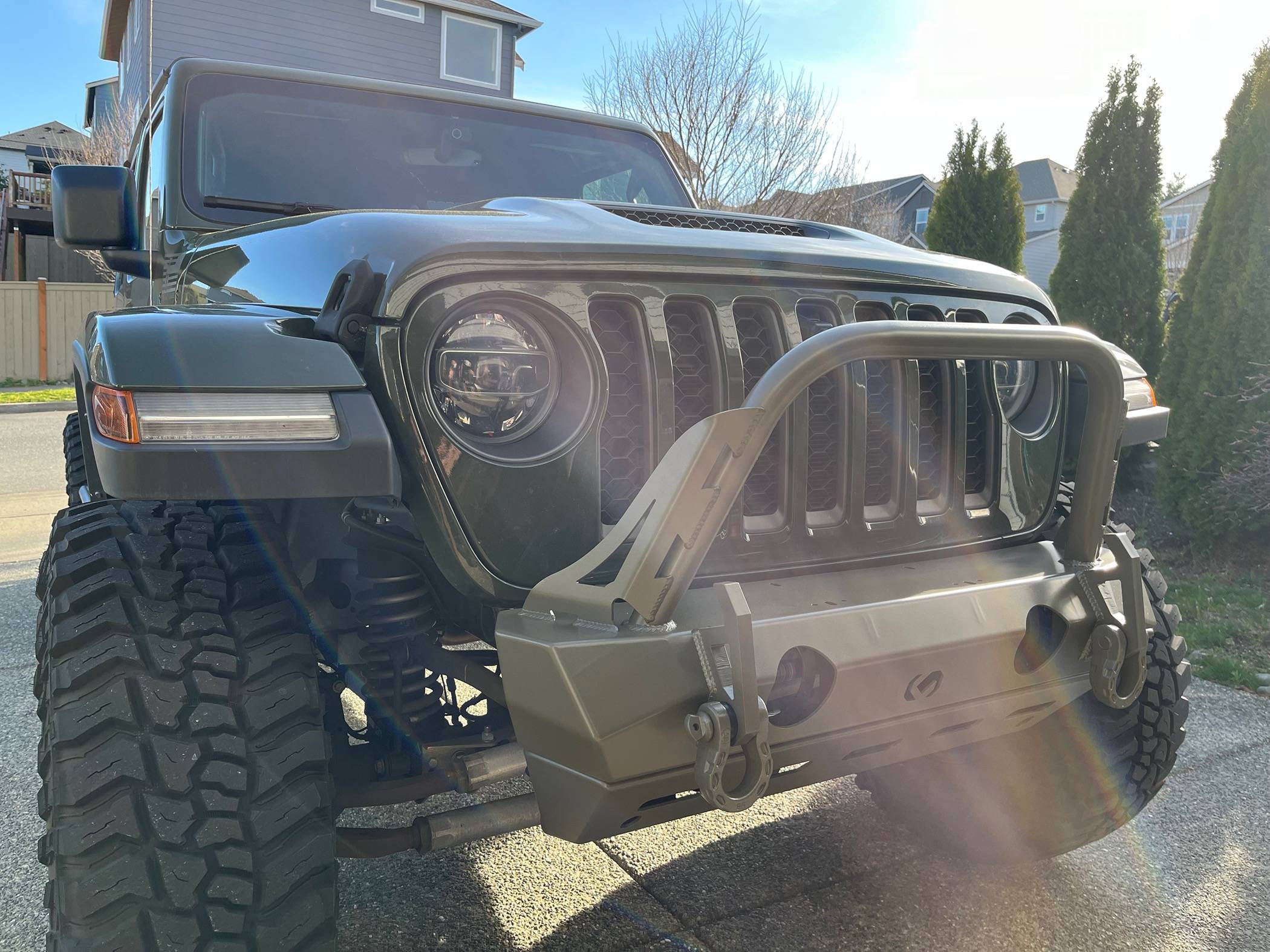

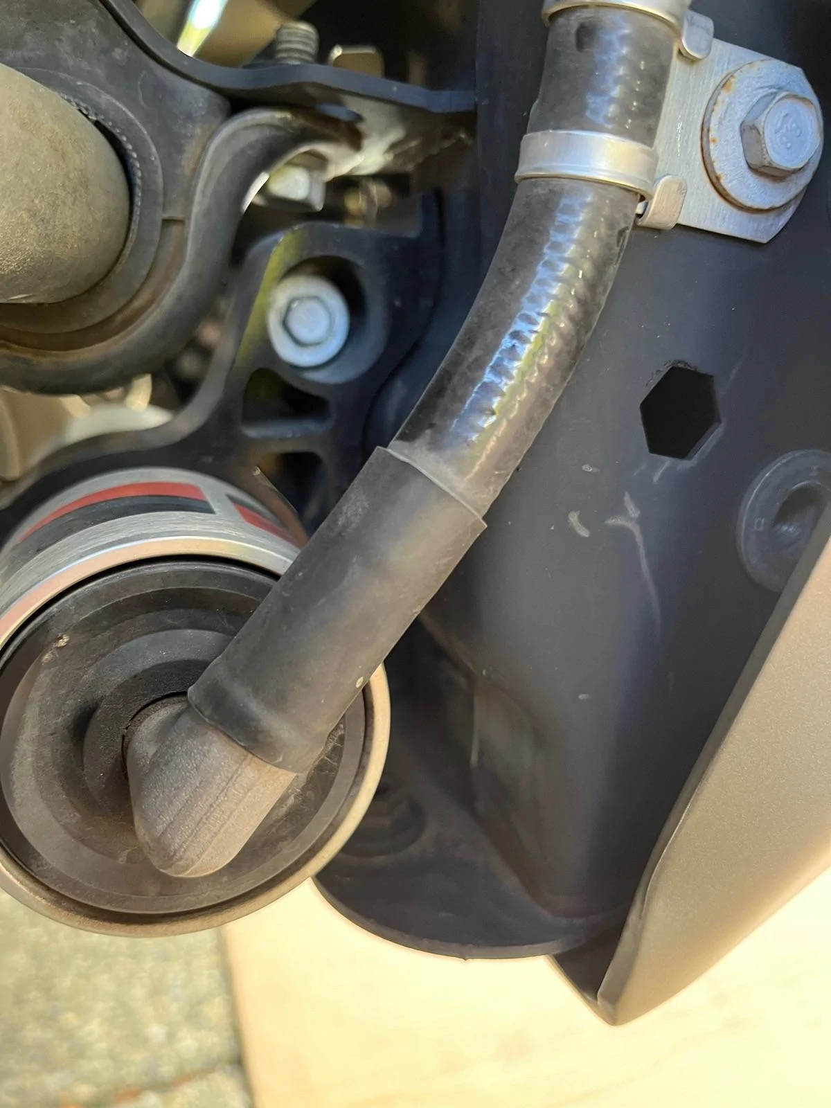

Got the bumper and lower skidplate installed. I think it looks great!!
However, there was one small issue with the skidplate compatibility with the Mojave…Mojave has an additional plate on the bottom of the frame horns that mount the shock reservoirs. The additional thickness caused the two bolt holes on the front to be misaligned. With how tight it is against the frame after fastening the four bolts to the bumper, I don’t think it’s going anywhere so will probably run it as is for the time being. I would have to remove the shock mounts completely in order for it to bolt in correctly.
