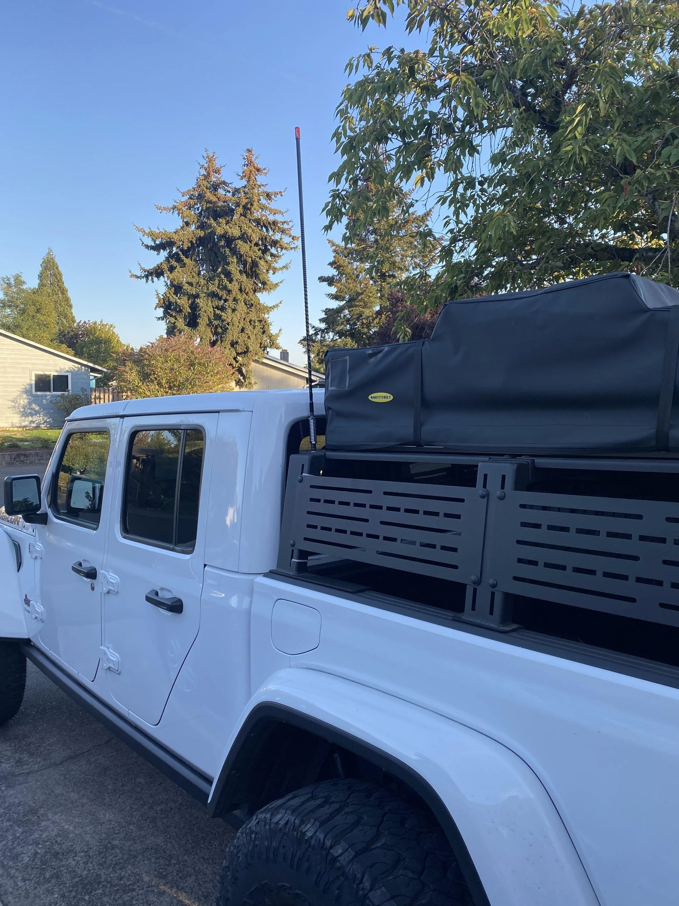

Hey Guys,
I was thinking about mounting my CB antenna on top of my bed rack. Obviously the shorter the better.
Basically only using it on trails
What would be the best antenna... Base loaded?
Thanks

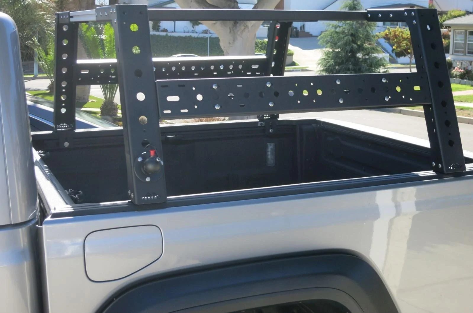

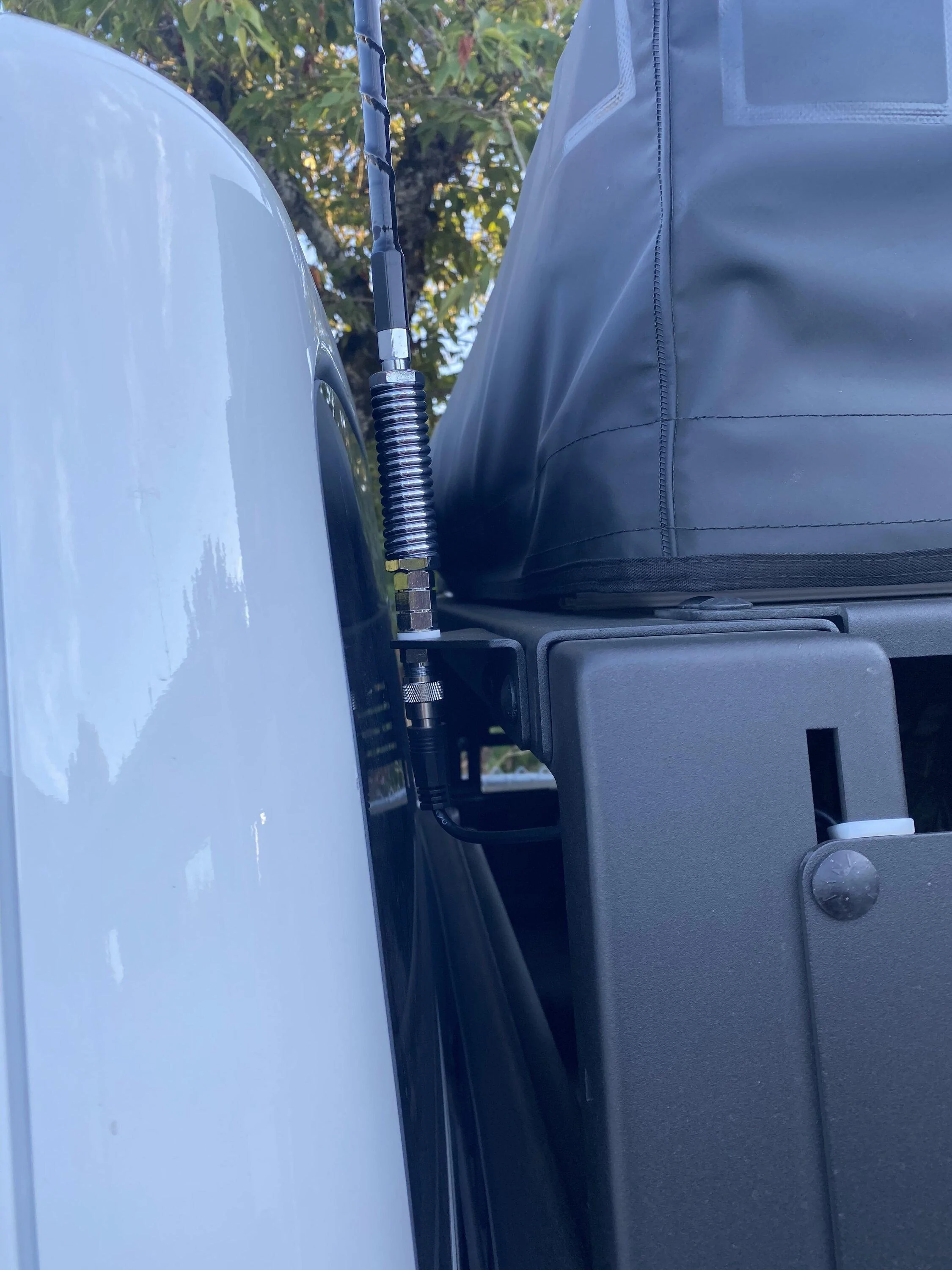

I mounted a ball mount to the lower part of my bed rack just behind the cab and it works well and all antennas I've tried. I have another mount for CB/HF antennas inside the bed just behind the rear wheel and when I got the bed rack it completely interfered with the whips sticking up from that mount. I put on this ball mount for use when the bed rack is on the truck which is not that often. The reason its mounted so low is I have padded kayak holder bars that go on the front and rear top of the bed rack and they overhang about 6 inches and I needed to put the ball mount low to keep the whips spaced out away from the kayak bars.
I thoroughly tested this antenna mount location using a 9ft CB whip, several lengths of Firestick antennas and a couple of multiband and single band HF amateur antennas and the SWR is fine on all. Being a big ham geek I did bond the bed rack to the front bed wall with short lengths of wide braid but that didn't affect the SWR enough to notice.
