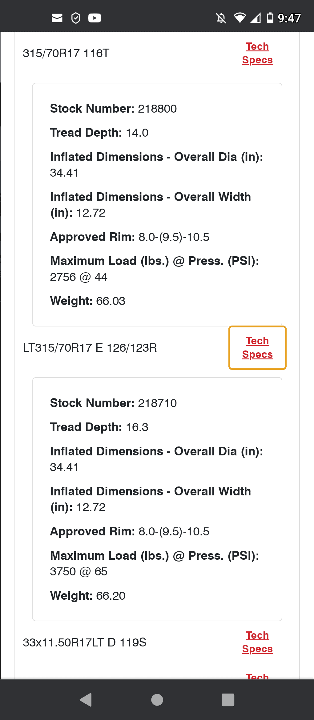

Free2roam
Robert
Mar 1, 2021
3,537
6,331
89521
The Nitto Recon Grappler looks to be a good alternative.
Jeep Gladiator Changing 35's Screenshot_20221027-094713
