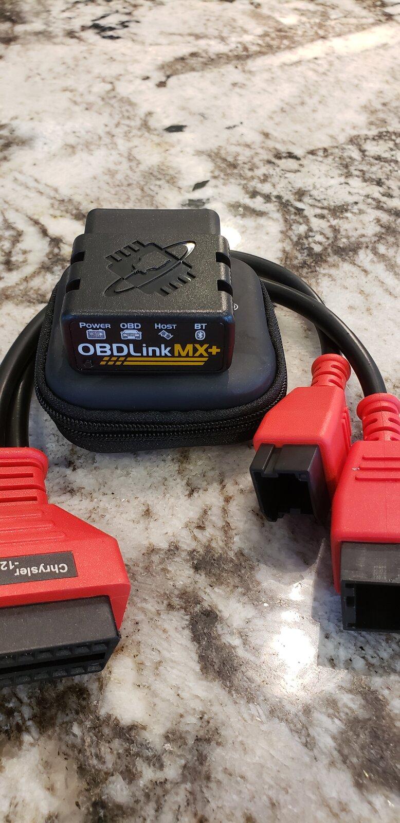

I can not get my J Scan to work at all. Goes through all the steps to change tires to set size and a pop up tells me vehicle is running, shut it off and turn it to run and try again. If vehicle is not running just select continue and press go. It looks like its working then it stops and says to disconnect cables and try again. I must have tried this 50 times. Any help would be appreciated.
178
29,091
34,573
You have the security bypass cable in place? What bluetooth adapter are you using?
Jscan is easy to use to set things like tire size - never had it act that way myself, so gotta ask the basics.
I have the same questions as shadow papa.
what other hardware are you using in conjunction with the jscan app

No other hardware being used, just the OBDLinkMX+ with the bypass cable.
Jeep Gladiator Changing tire size, need help. OBDLinkMX+
You have a top of the line adapter there, the MX+ It's the same one I use with jscan, AlfaOBD and other software I've messed with.
The only thing I can think of is that sometimes these get picky with the order in which things happen but then it's hard to mess up too much if you follow any screen prompts.
I try to recall back to any hiccups I've had and the only thing I can think of is I didn't have the "ignition switch" in the correct mode and ended up pulling the BT adapter, shutting down the software and starting the process again. Not sure what I did but it didn't like it until I did that, then it was fine.

I was just thinking that maybe when it says to turn the vehicle ignition on you were literally starting the truck. I’ve done that before and it doesn’t allow the changes to be made correctly. You can press the start button once and it turns on accessories. If you press the ignition button again, without touching the brake, all of the electronics will turn on but the engine will not start.
That should allow jscan to make any changes
178
29,091
34,573
Yeah, I've messed up and had it in only accessory mode before. Something simple to check.
