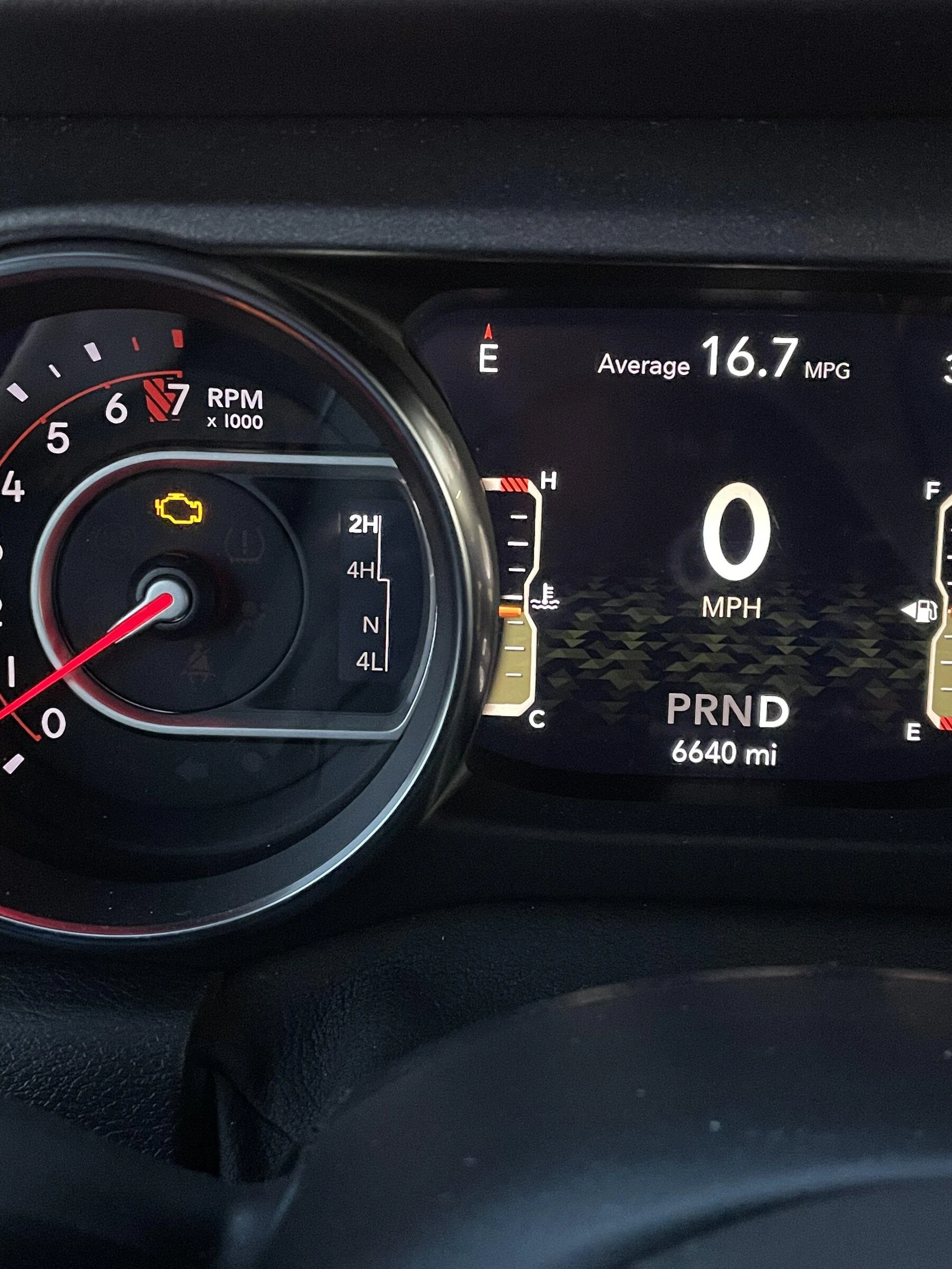

I have a 2020 with the 3.6. After an easy drive on some old logging roads today the check engine light came on. I didn’t seem to run any differently. Also, I noticed quite a bit of steam coming from the front but the temperature gauge didn’t move. Guess I am going to be spending some time at the dealer tomorrow.

Did you look under the hood?
Yes. I didn’t see anything that stood out other than steam coming from the passenger side of the radiator near the top. I have little to no mechanical skills so wouldn’t even really know what I am looking for.

Do not go by that temperature gauge - go to the off-road pages or change the cluster to show you the REAL temperature of the coolant.
That gauge is a go/no-go gauge and doesn't move much at all. It's not an accurate tell of the real temperature. You can scroll to the gauges in your center cluster by using the left steering wheel up and down buttons. You can see coolant temp, trans temp (if automatic) oil temp, tire pressure, voltage.
