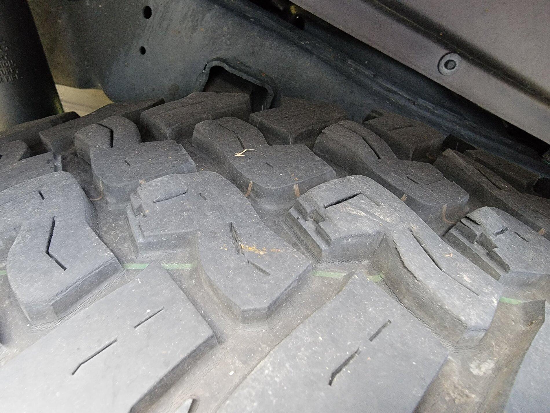

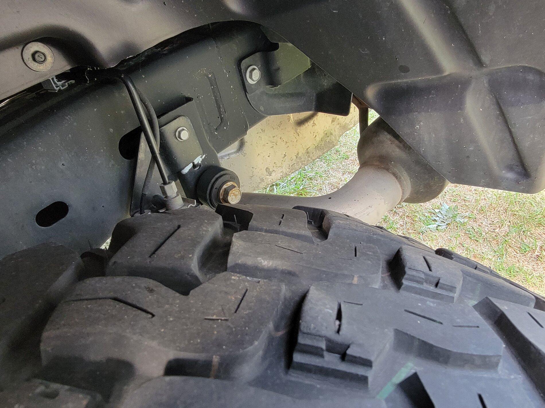

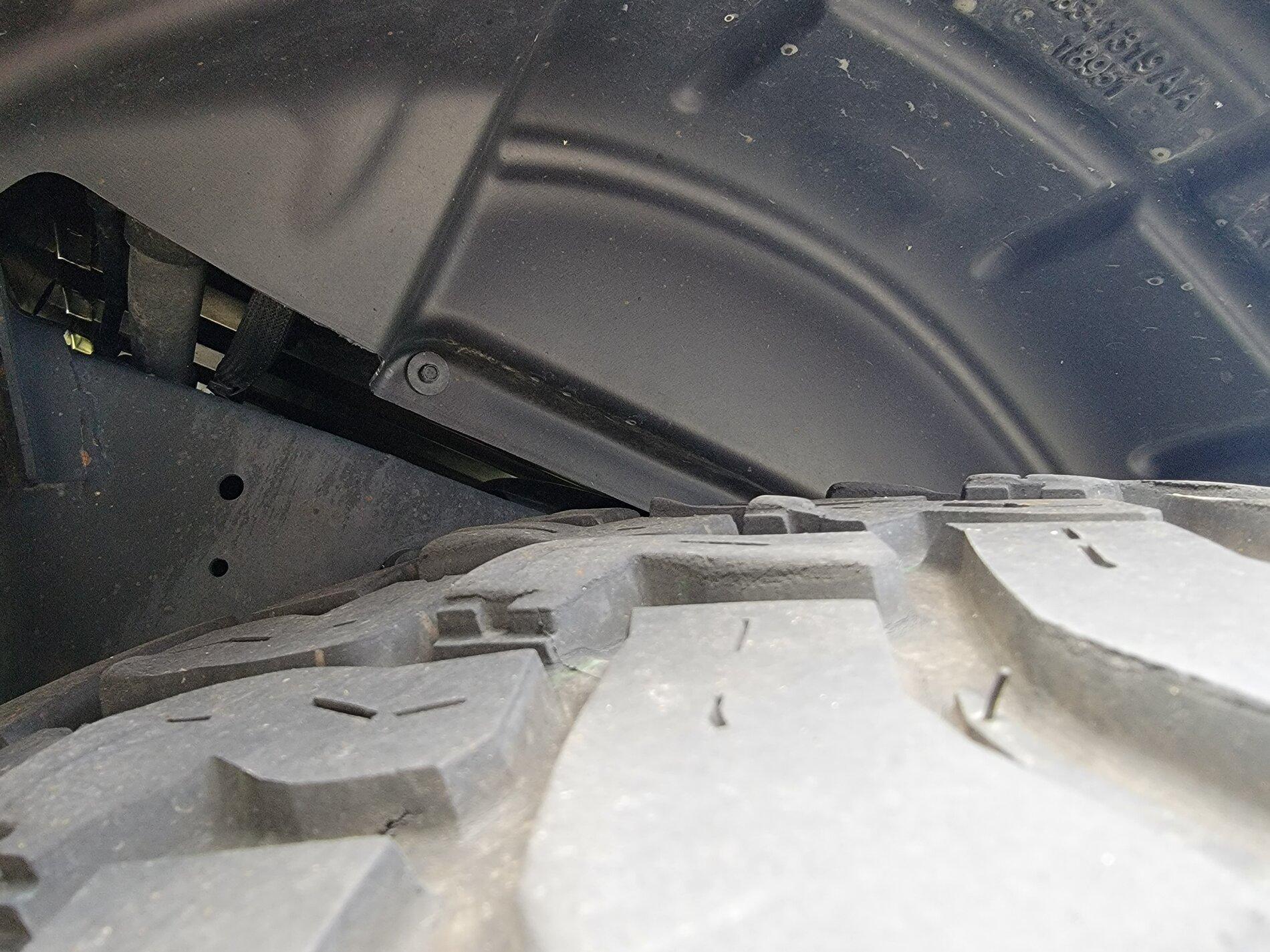

Not sure how well you can see in these photos, but there a pieces of tread that are definitely higher than others, why it would wear unevenly like that is beyond me.

I have seen that type of wear on one of my friends JKs on MTs that were not rotated, how were they rotated? front to back or cross corner?
Cross corner I believe

How often do you change oil (and therefore rotate?) Aggressive MT tires usually should be rotated every 3000. I even do my AT tires every 3000 to keep on top of any whacky wear.

I agree with the guys above. I’ve never heard it referred to as chopping though. I’ve always heard it called cupping. It normally happens when the tires aren’t rotated enough. If you are going 5-7,000 miles on oil changes you may want to rotate them in between oil cages at around 3k miles like mentioned above.

I've been rotating every 5k Mike's so maybe I should go with 3k. I'm going to have the suspension looked at too

Now the bummer is... once the tires get that way, usually the only fix is new tires. (After ruling out any underlying alignment/suspension issues of course)
I've heard of some machines that can shave down the tires to be true again, but never actually seen or met anyone thats done it... can't imagine it would be very cost effective either.

Cross rotate them and run them. Does not look like any major issues.
