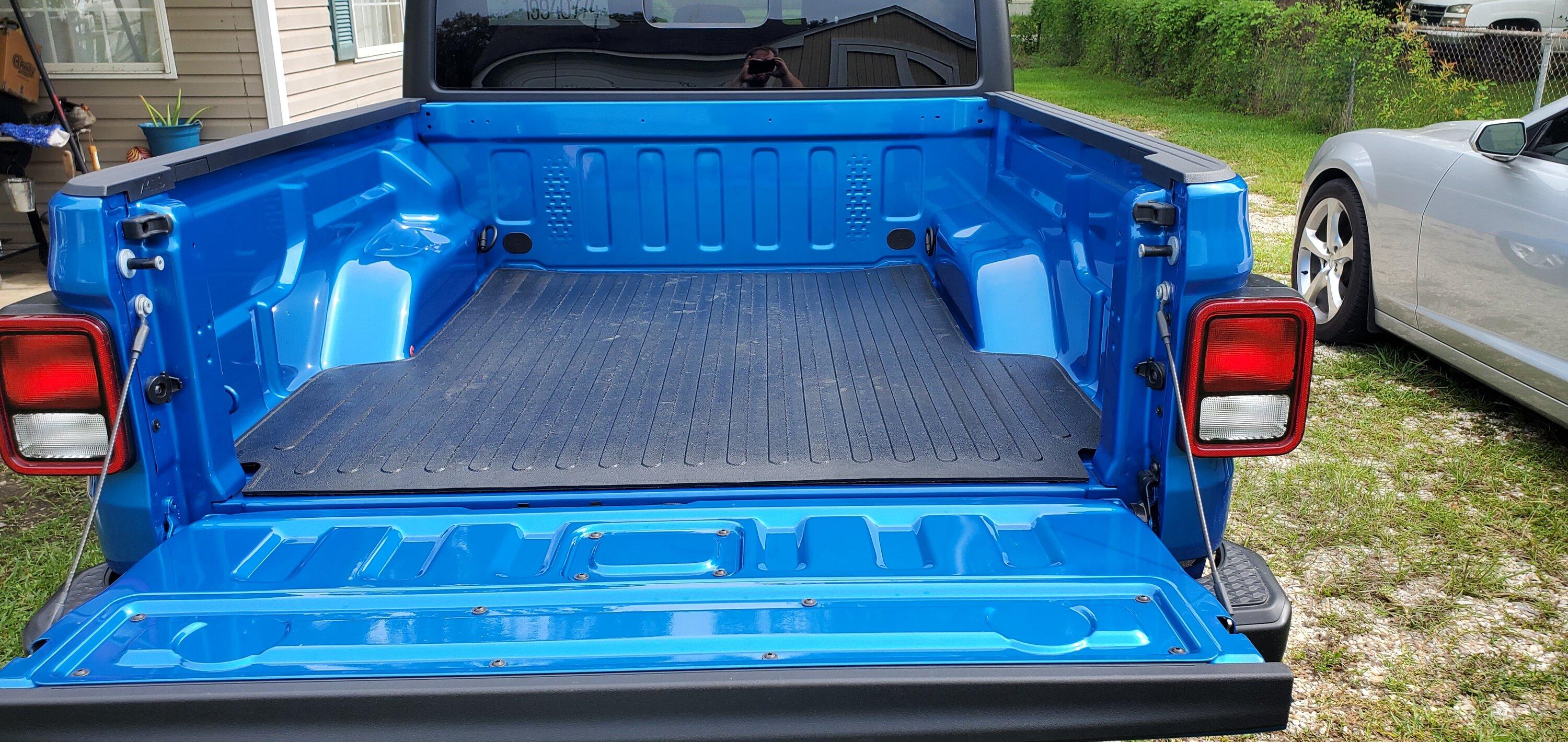

Ordered it from the local dealer the first week of June '22 - received the first week of August '22. Two months to the day, order to delivery. This is my second Jeep. My previous ride was a '16 JK Willys that I bought new in April '16. I traveled / wheeled all over the country in it, adding 87,000 miles to the odometer. Sold it to family and bought the truck because well - I needed a more suitable daily (more space, better towing), but still wanted a Jeep and 4x4.
Here is a snip from my Google Doc that covers the mods. It's current as of 5/4/2023.
2022 Jeep GladiatorDone?

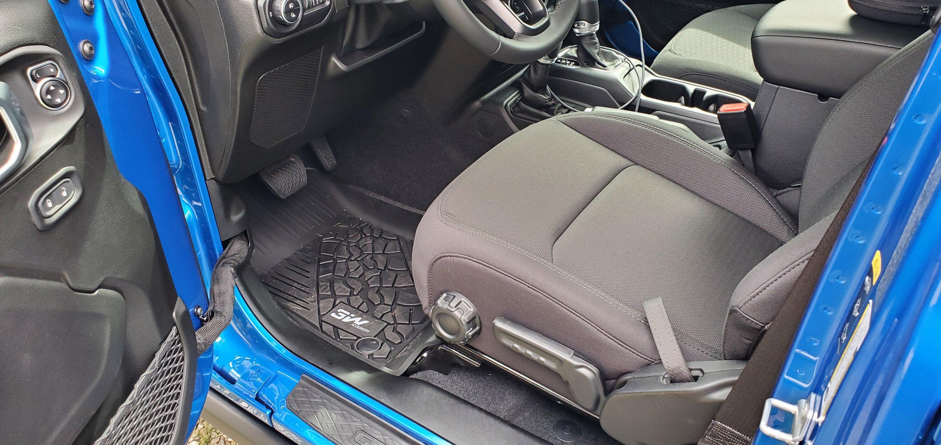

3W Floor MatsInstalled
Door Sill GuardsInstalled
LED Headlight BulbsInstalled
LED Fog Light BulbsInstalled
Bed MatInstalled
Rock RailsInstalled
TPMS SensorsInstalled
Rubicon Wheels/TiresInstalled
Window TintInstalled
Air CompressorInstalled
Leveling KitInstalled
Smittybilt X20 WinchInstalled
LOD Winch PlateInstalled
Fairlead MountInstalled
Fairlead SpacersInstalled
Dead PedalInstalled
Tool Box, TSCInstalled
Spare TireInstalled
Power Outlets, Back SeatInstalled
MudflapsInstalled
Bed Tie DownsInstalled
Bulletpoint Phone MountSold
Metalcloak DisconnectsHere
Mopar Lower Control ArmsHere
Apex AutoLynx Sway Bar DisconnectsInstalled
Bulletpoint Rubi GridInstalled
Bulletpoint Radio MountInstalled
Samsung A7 TabletInstalled
KB VooDoo Max Modular RackInstalled
KB VooDoo Rack Mount ClipsRemoved
KB VooDoo Rack Mounts 1Installed
KB VooDoo Rack Mounts 2Stored
Ironman 4x4 Awning & RoomInstalled
DIY Bed Rail MountsInstalled
Pelican Vault V800 CaseInstalled
Body Armor 4x4 Pike Roof Top TentInstalled
Aluminum 1/8" x 8' flat barInstalled
Trash CanInstalled
Alpicool 35QT FridgeInstalled

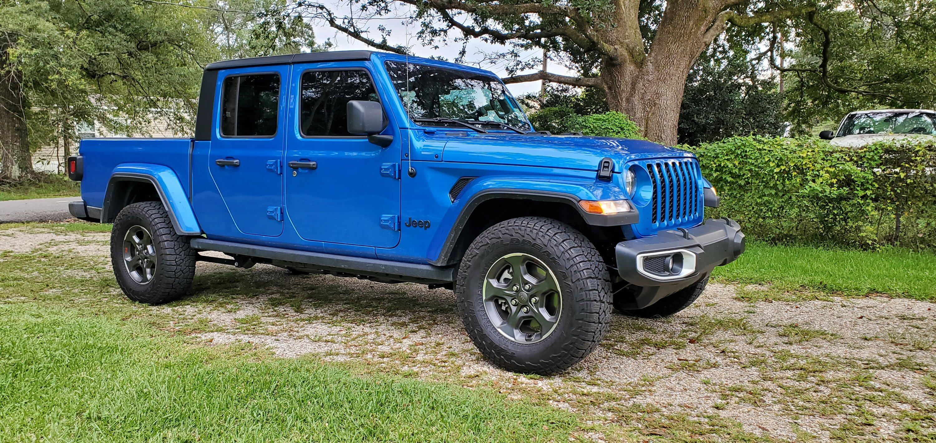

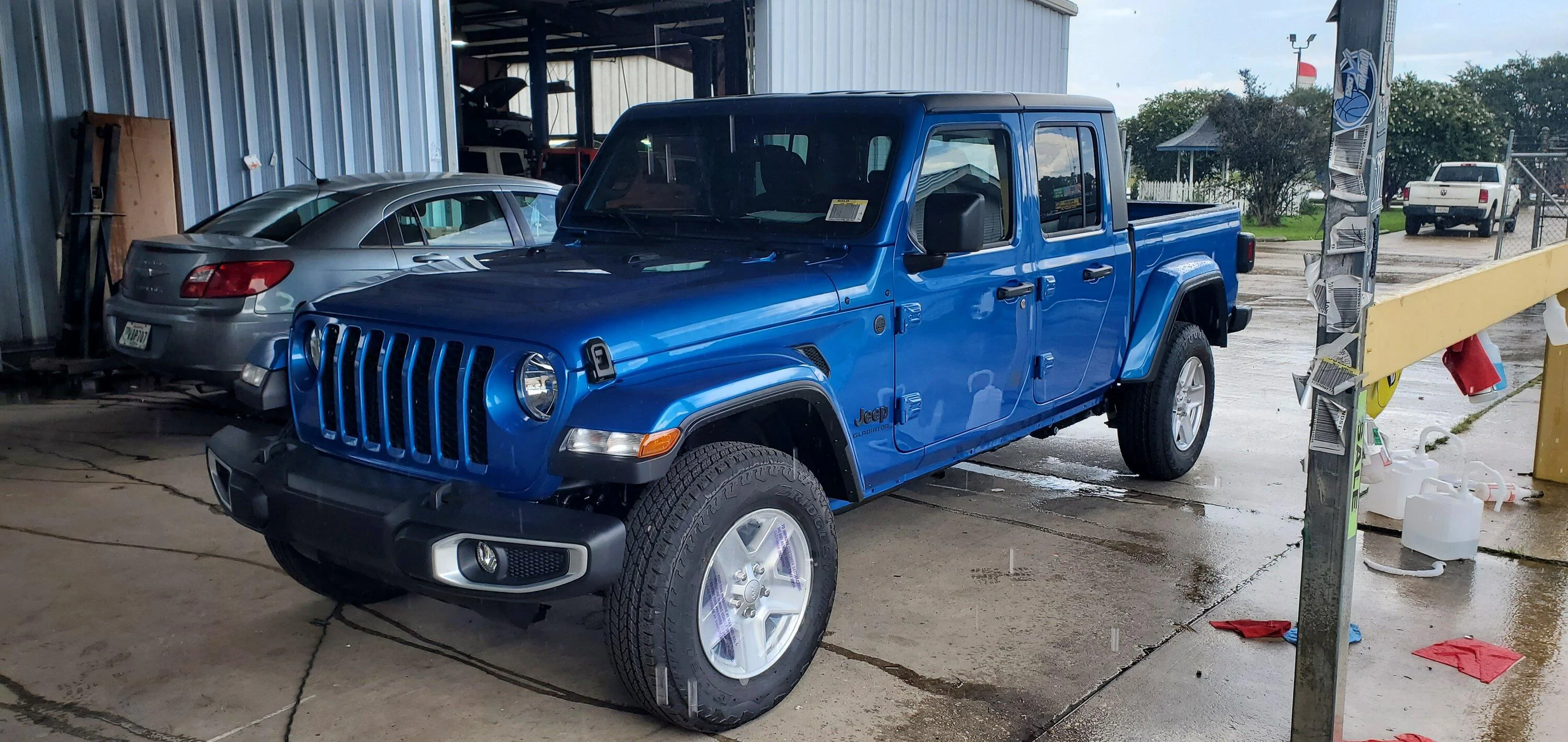

First two pics - my first time seeing the truck at the dealer, only a couple hours after coming off of the truck.
Jeep Gladiator Chris's Sport S Max Tow - Boring Daily 'Build' 20220805_124110
Jeep Gladiator Chris's Sport S Max Tow - Boring Daily 'Build' 20220805_124450

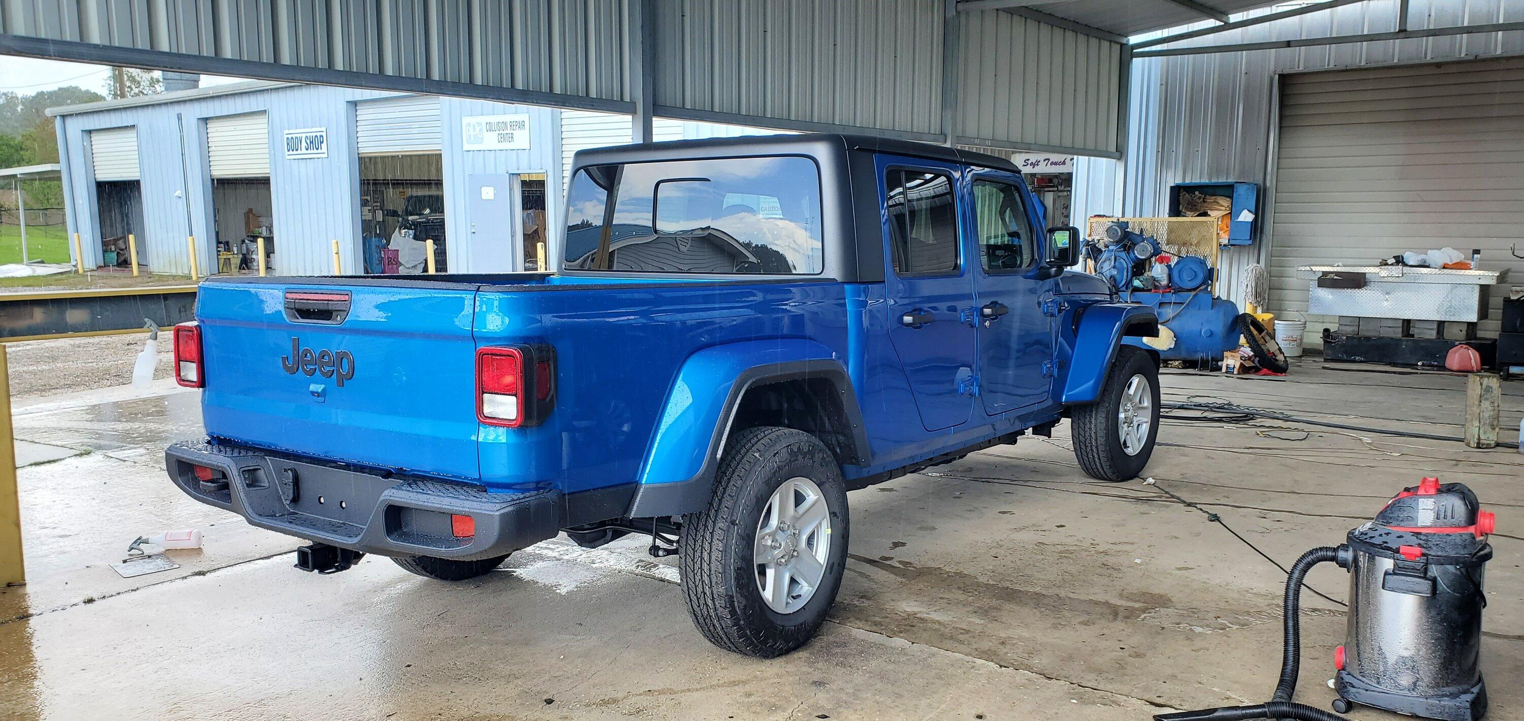

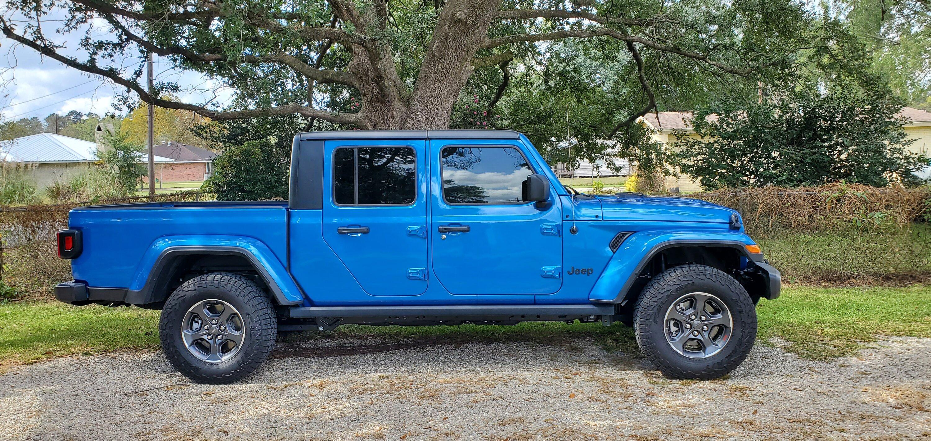

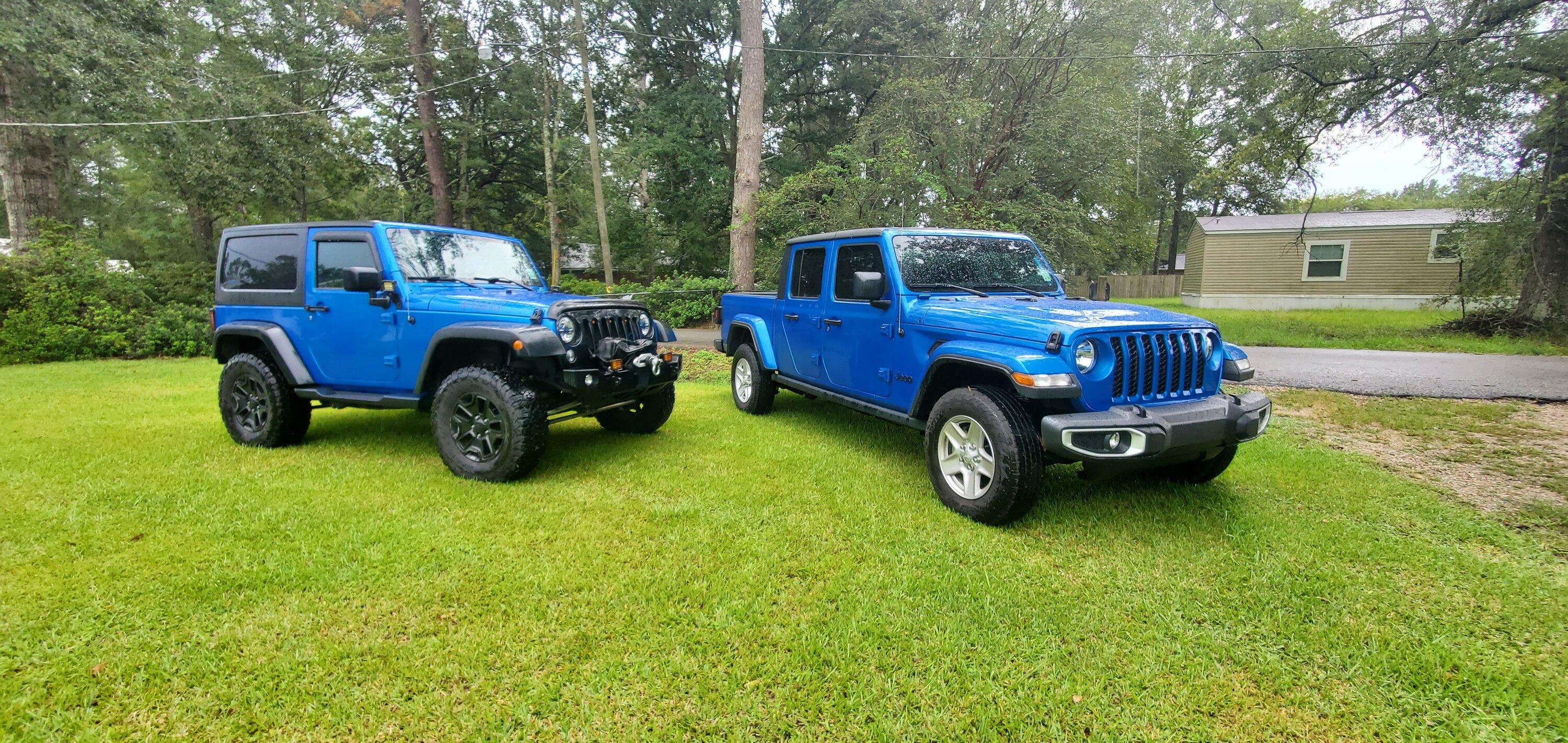

My previous 2016 two door with my new Gladiator.
Jeep Gladiator Chris's Sport S Max Tow - Boring Daily 'Build' 20220903_125833

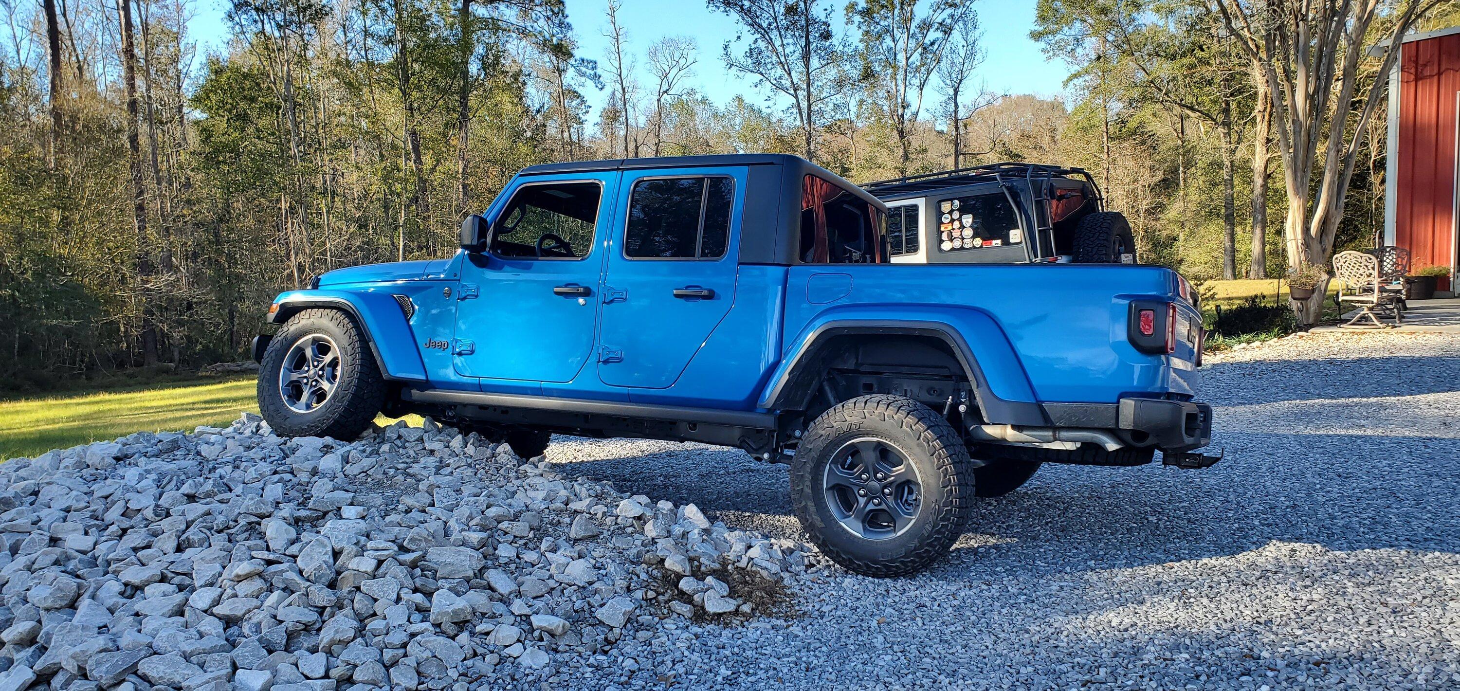

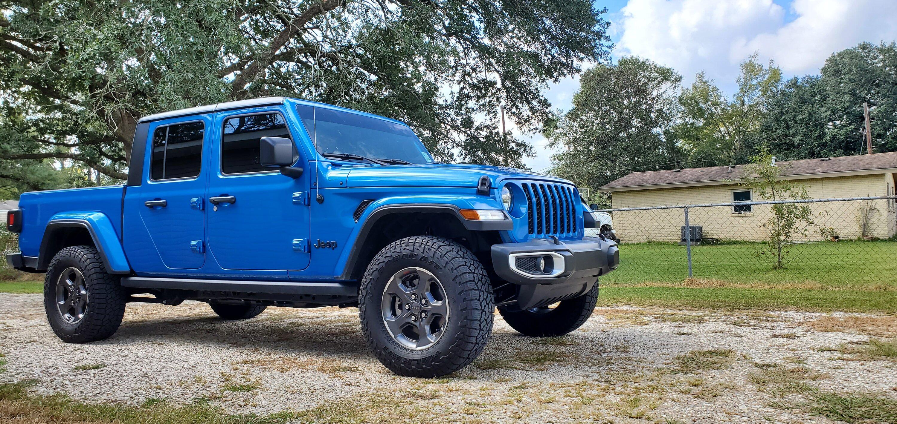

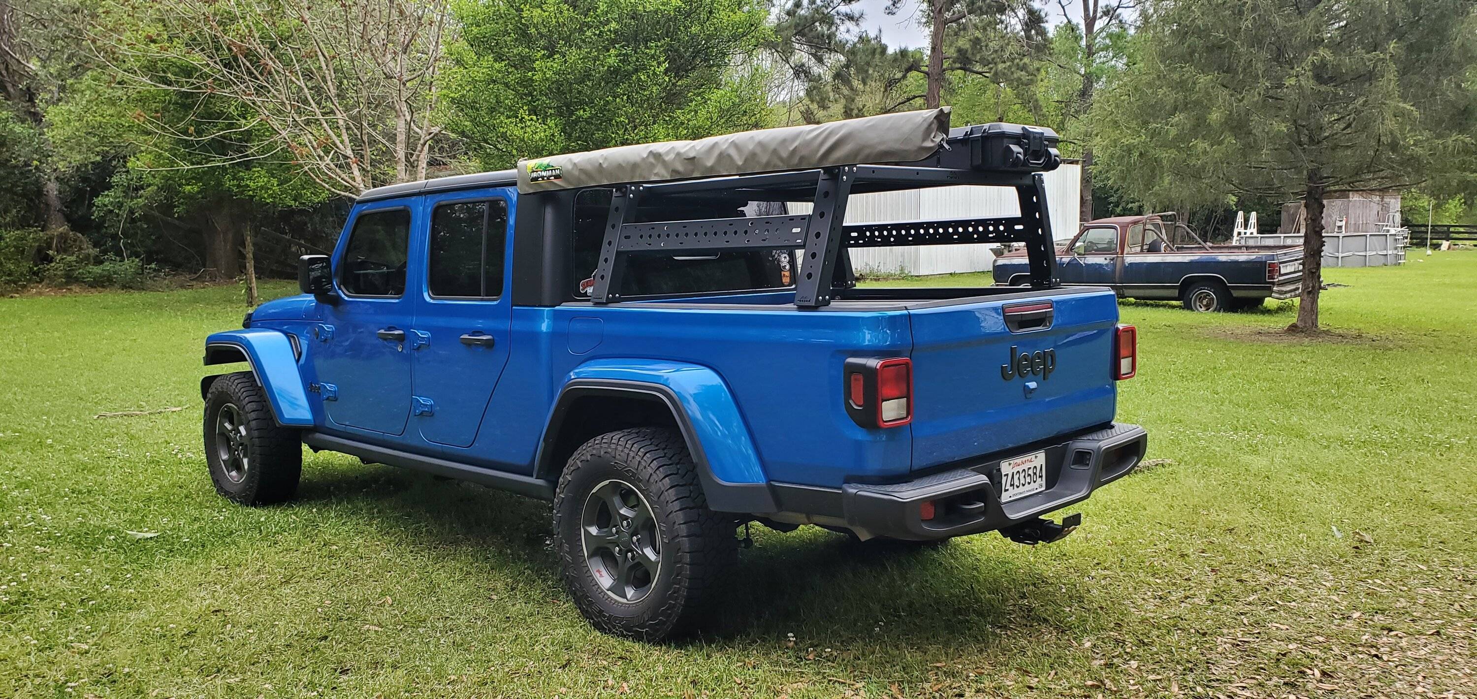

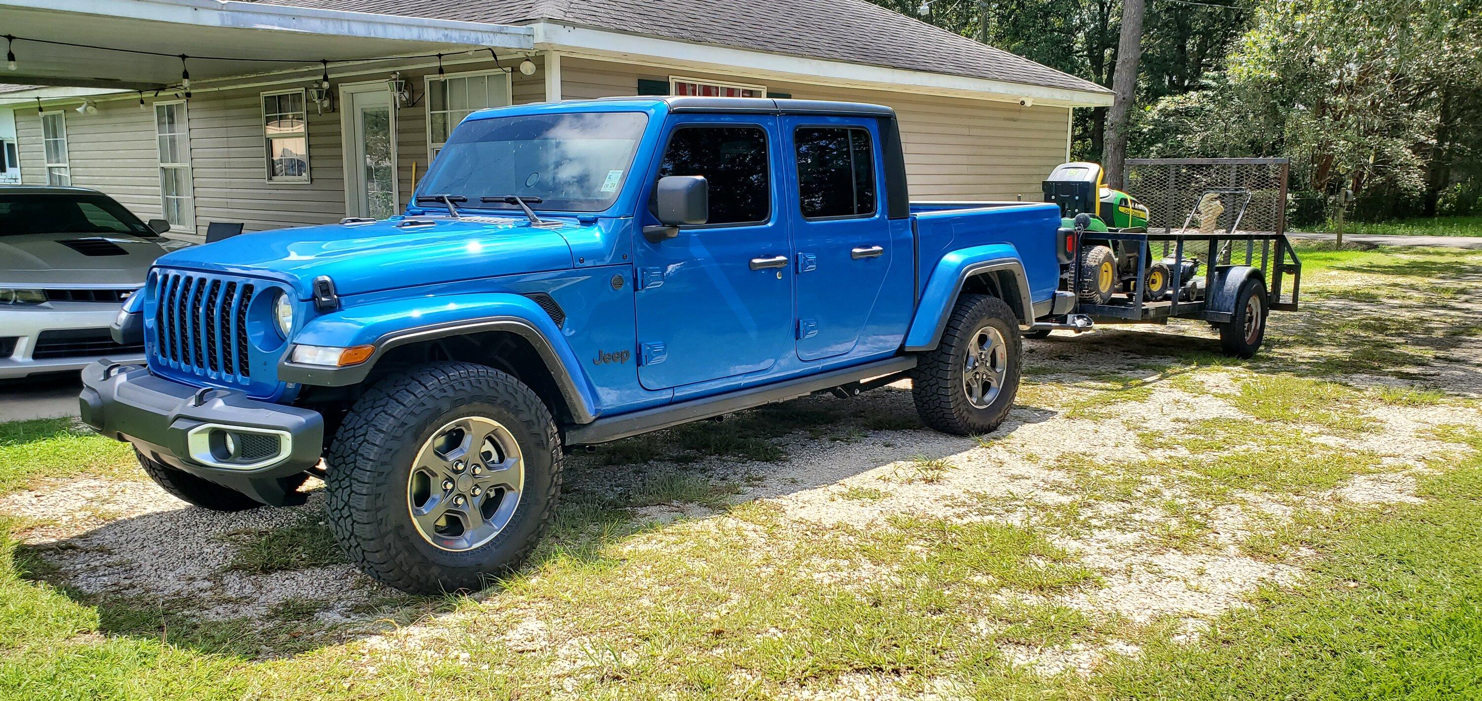

Current picture from Mid April 2023.
Jeep Gladiator Chris's Sport S Max Tow - Boring Daily 'Build' 20230416_165549

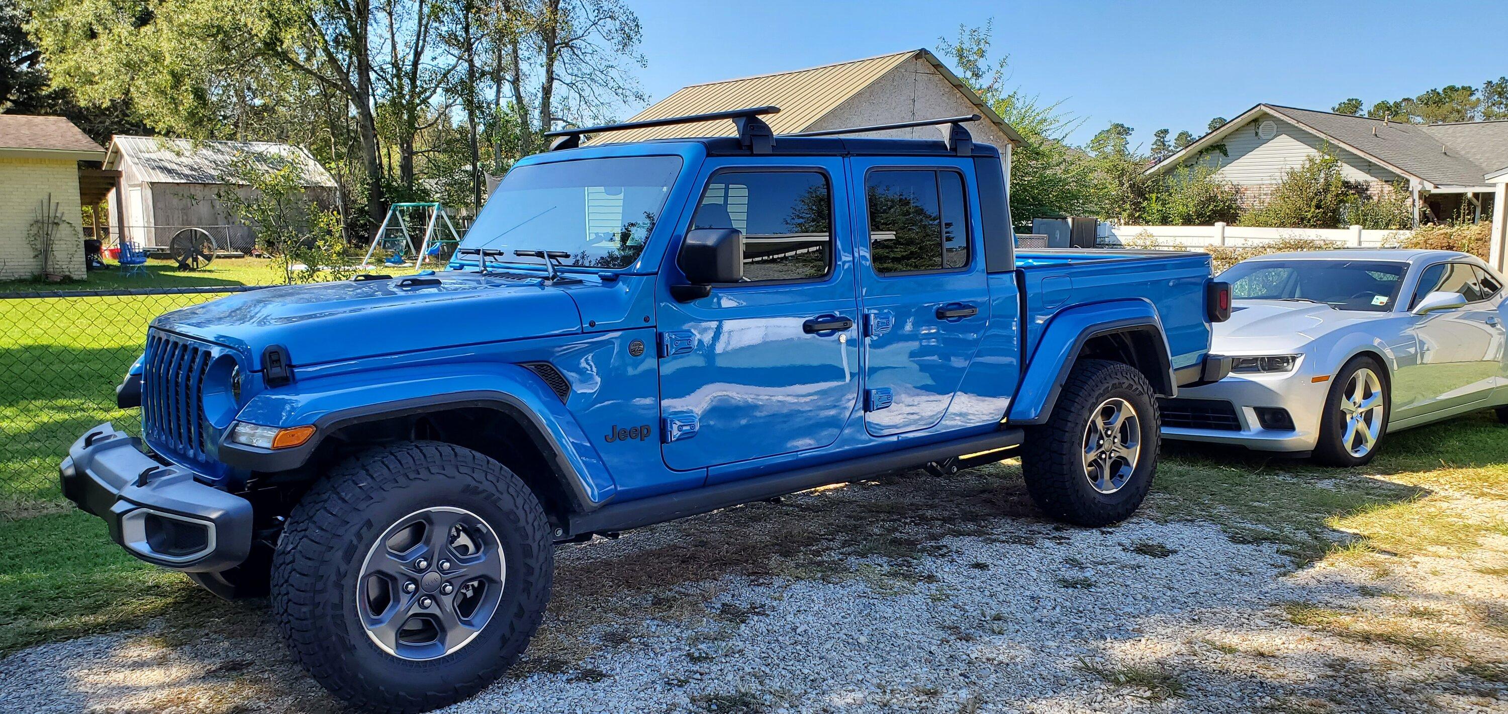

Test fit some Mopar roof rails that I got for cheap locally. They'll work for the kayak. Removed them for now.

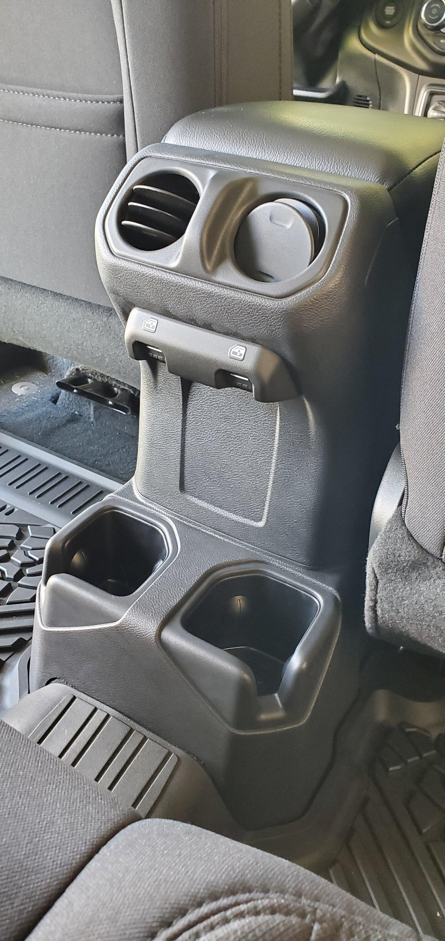

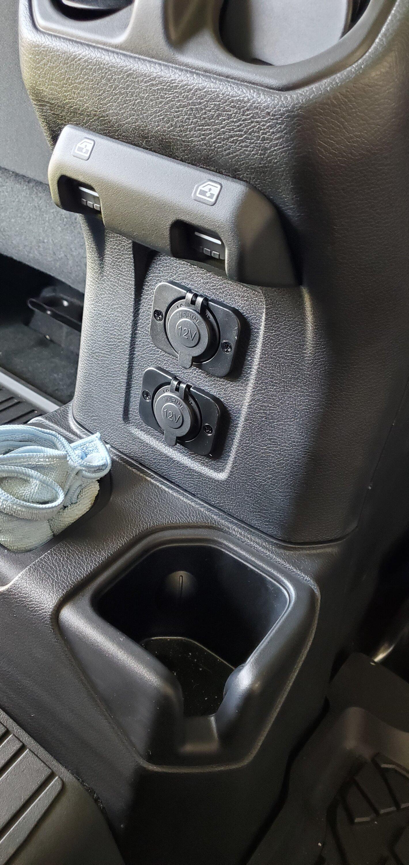

Also added two 12V outlets to the back of the center console.
Teraflex 1.5" Leveling kit is here, waiting to install. The lower control arms from the Mopar lift kit also arrived. While I hear they aren't necessary for the level, plenty folks suggested the extra caster really helps, so why not. I also have an LOD winch plate on the way to try a 'hide the winch in the stock bumper' project.

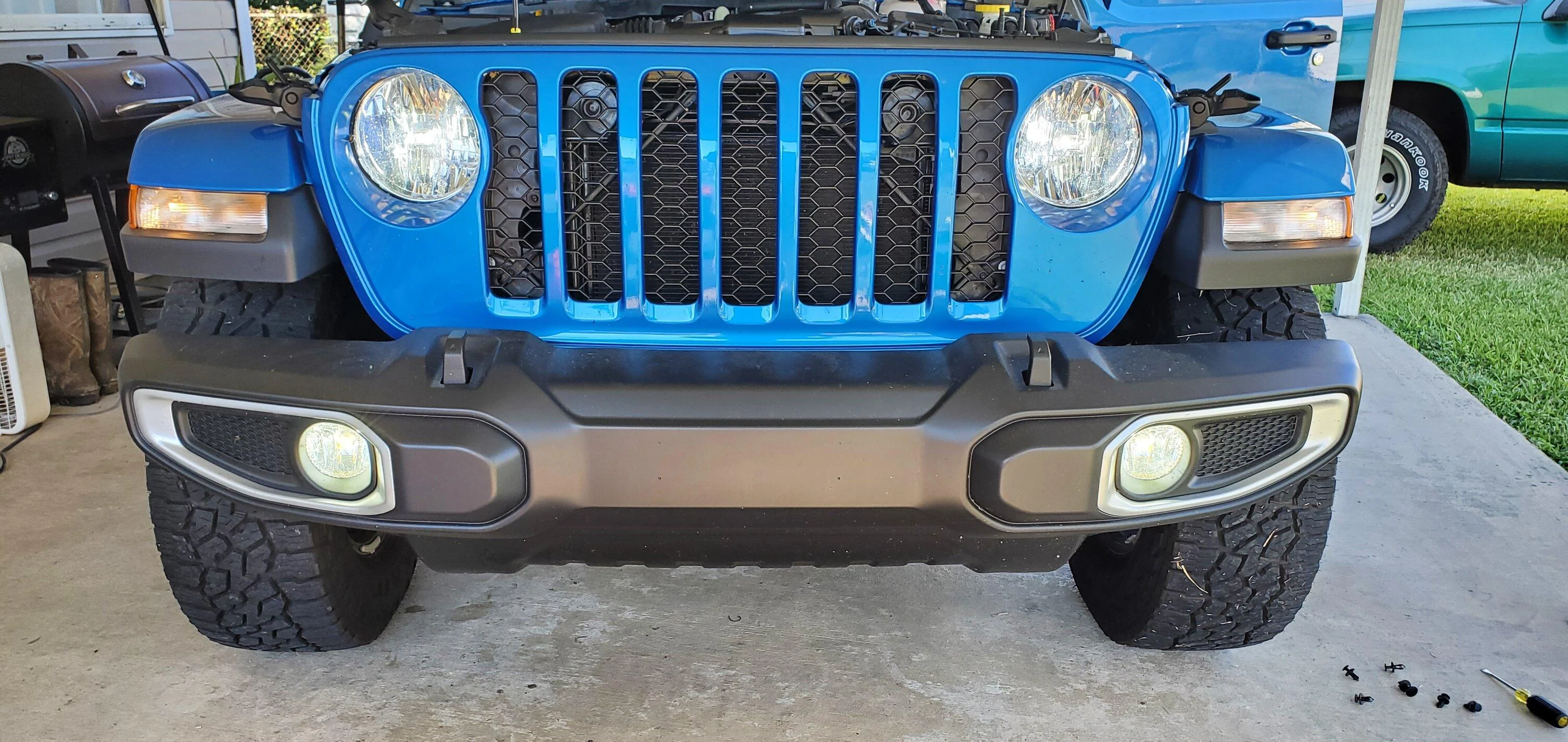

Installed LED headlight and fog light bulbs (Beamtech for headlight and SNGL for fogs) no flash or programming required (I had OEM halogens).

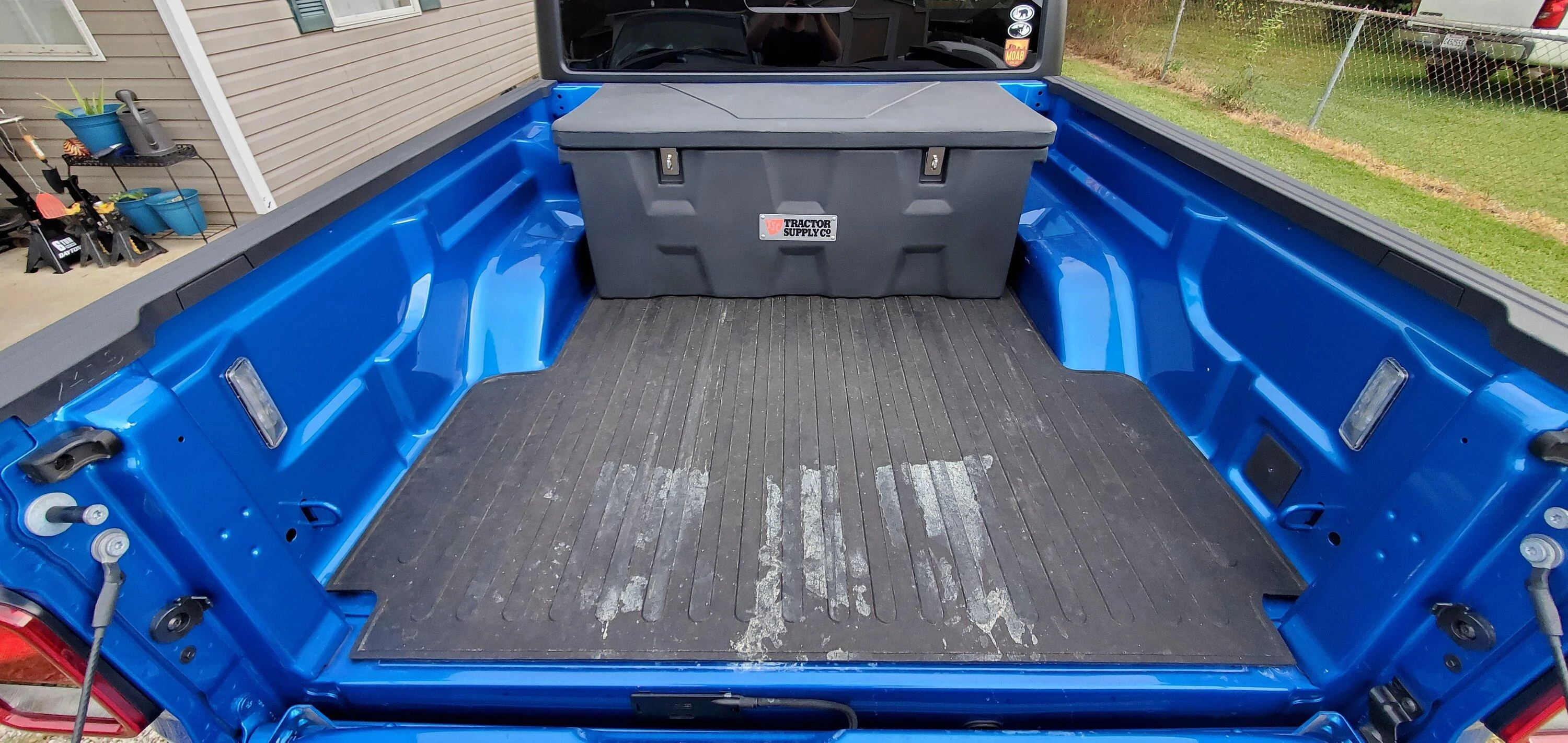

Found a great fitting box at Tractor Supply for $125 for some bed tool storage. This is an interim solution until I want to spend $1300 on the final bed cover - then this box will go in another truck of mine. Waiting on some parts to secure it to the bed with no modifications.

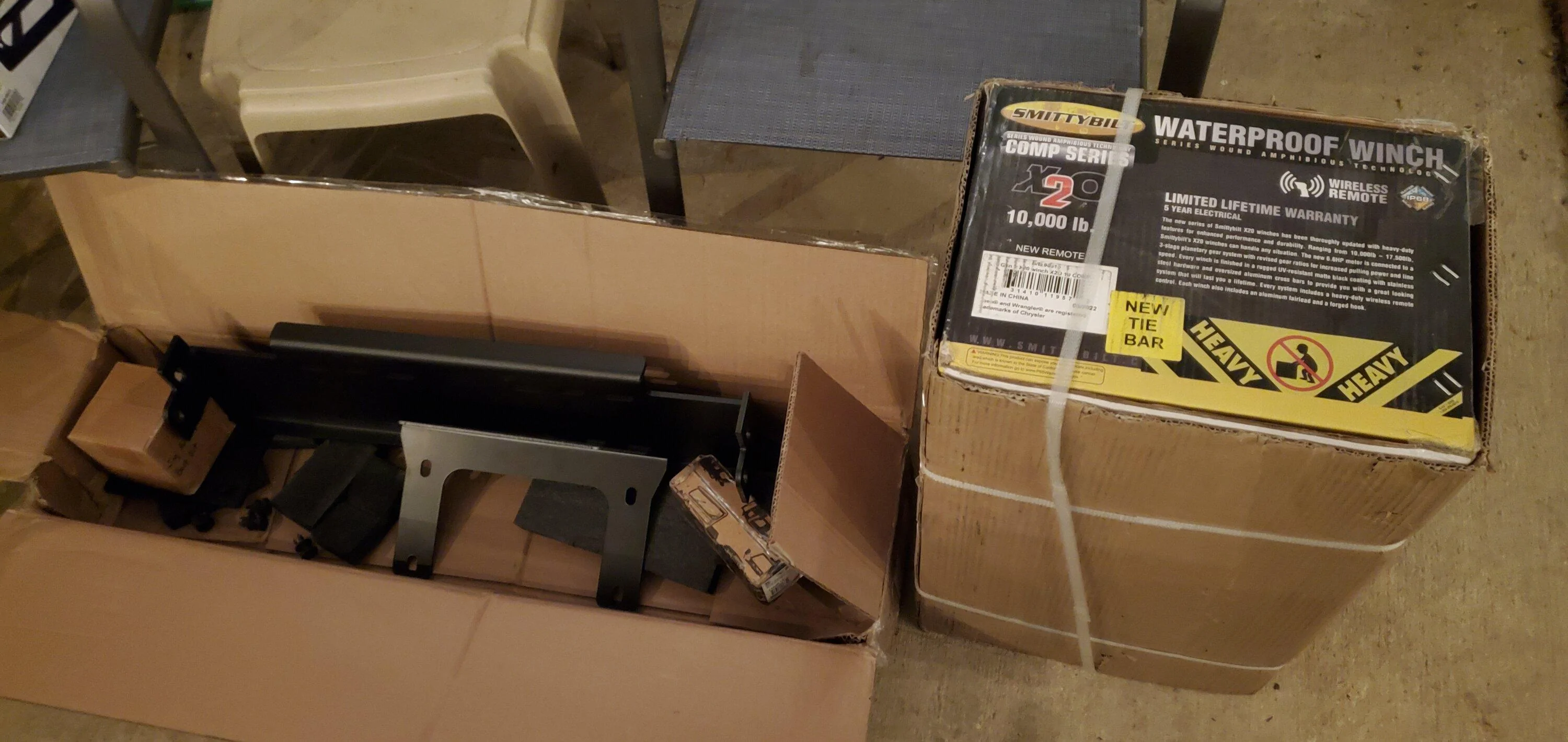

Tomorrow my winch arrives and then i am going to modify the stock plastic bumper to accept it using an LOD winch plate and a universal fair lead mount. Also have some bed tie downs and a dead pedal coming, and some materials to make removable front mud flaps.

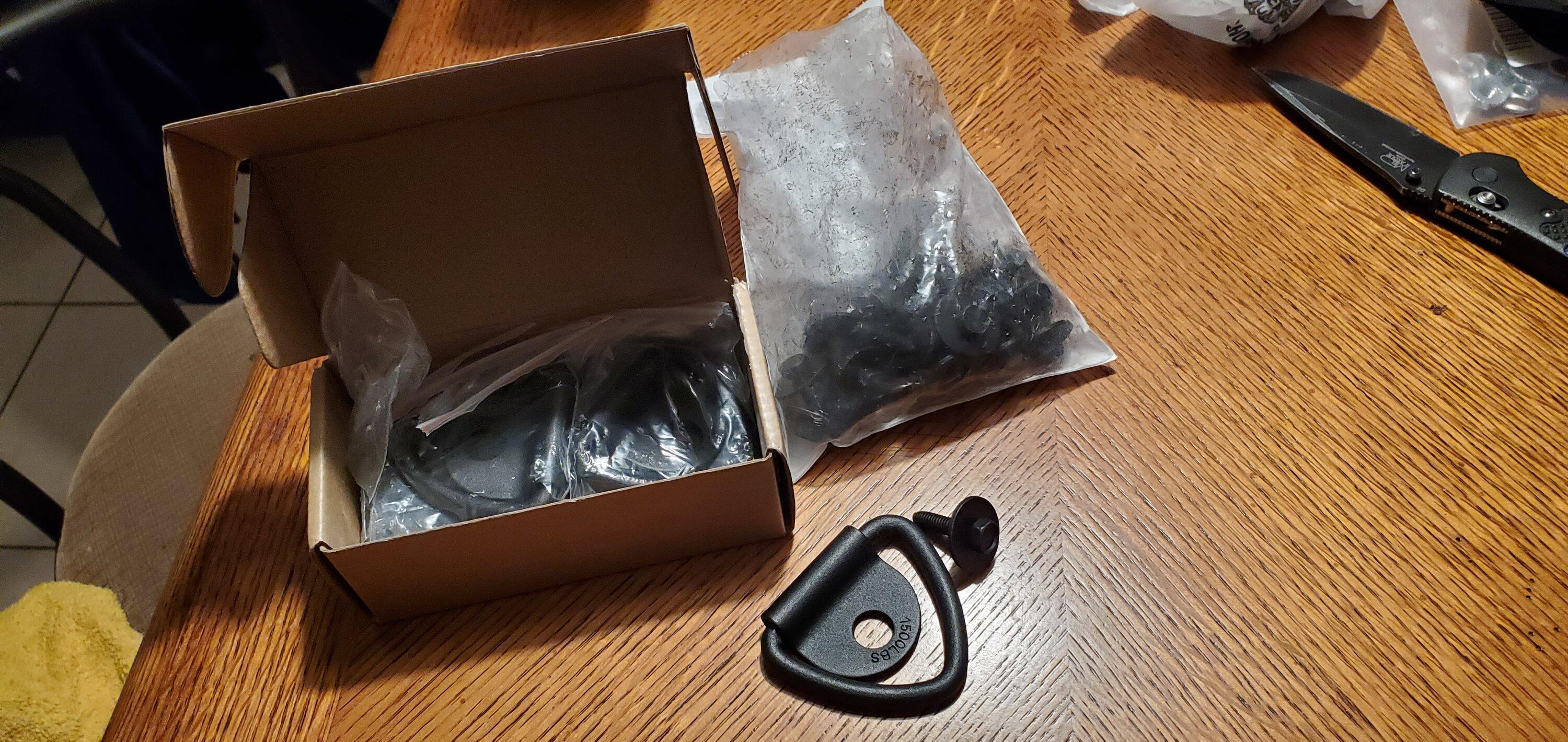

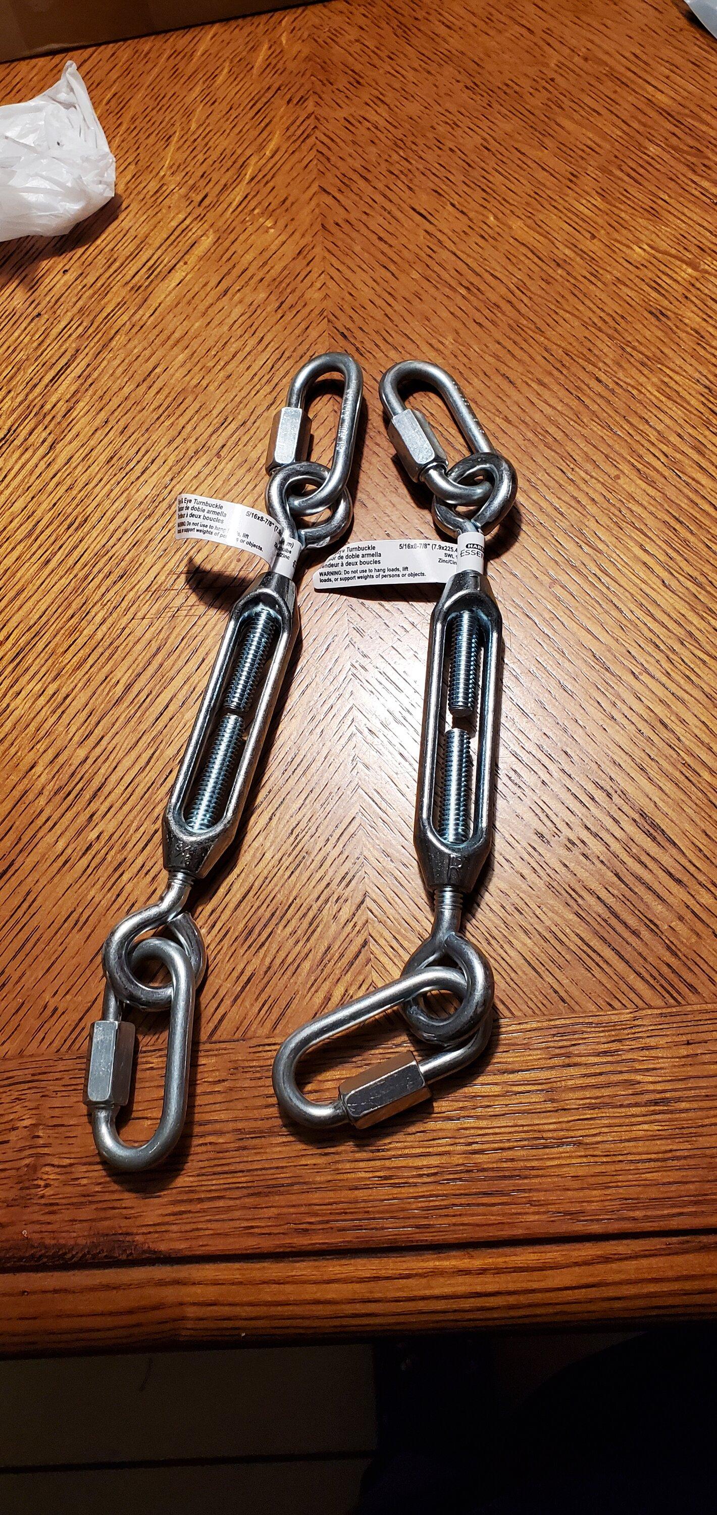

Stuff for additional bed tie downs since I don't have the trail rail system.
Jeep Gladiator Chris's Sport S Max Tow - Boring Daily 'Build' 20221019_200444

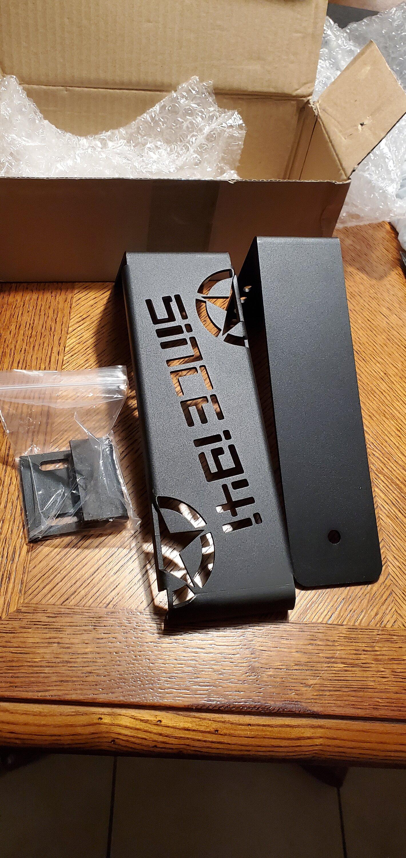

A dead pedal. Really miss having one like on my previous JK.
Jeep Gladiator Chris's Sport S Max Tow - Boring Daily 'Build' 20221019_200624
And the put a winch where it wasn't supposed to be starter kit.
Jeep Gladiator Chris's Sport S Max Tow - Boring Daily 'Build' 20221019_200817

So - I crammed a Smittybilt Gen 2 X20 Winch into the stock front bumper. Used an LOD Signature winch plate, a Harbor Freight fairlead mount, a couple cheap aluminum fairleads from Amazon to act as spacers, and a lot of cutting and fitting. Love the result.
Read more about it here.

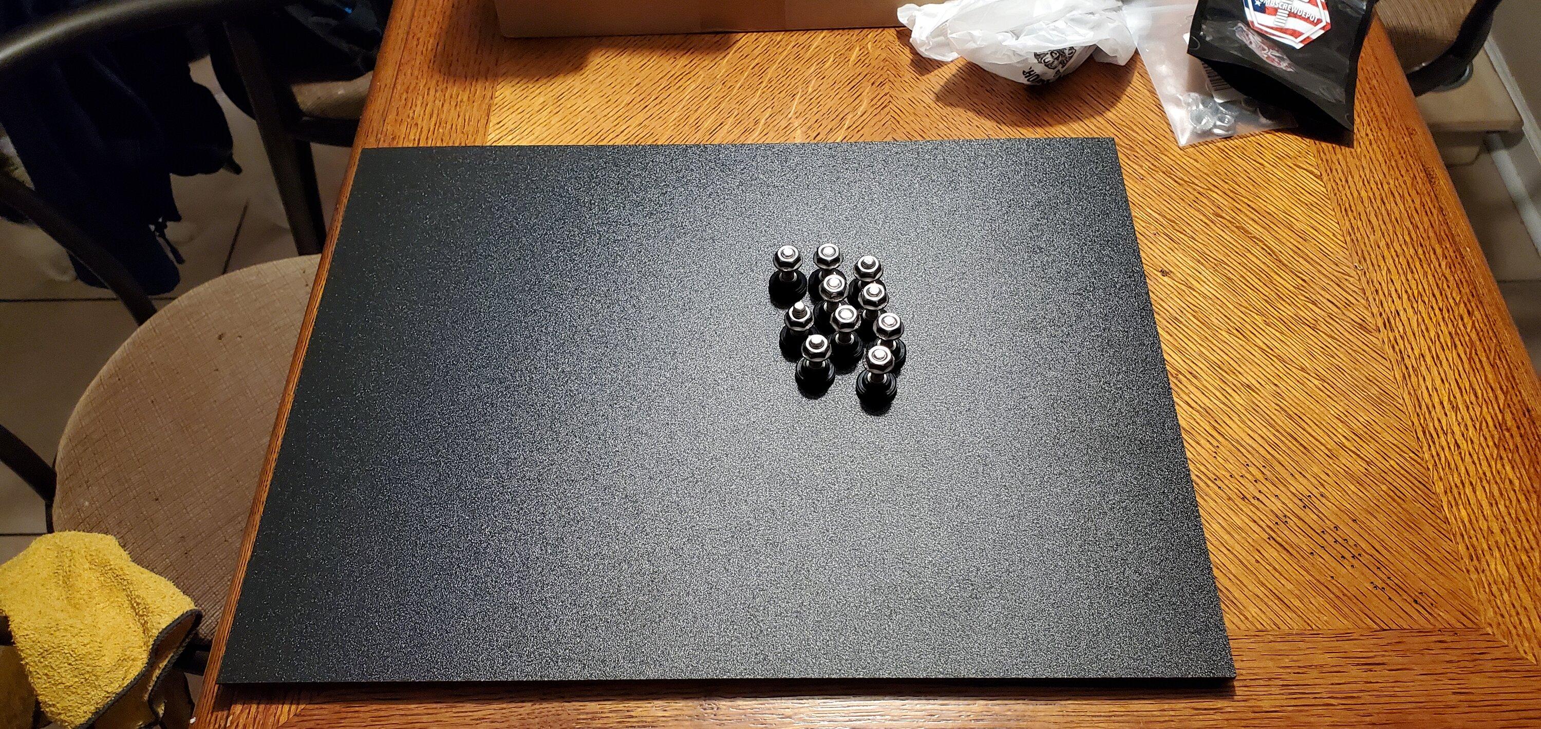

Made some custom quick release front mudflaps. It's just plastic sheet from Amazon (I forget exactly what kind) and some thumb screws and flange nuts to attach them where the push clips used to be at the bottom of the fender. On and off easily, seem to hold up fine enough for trips down forest roads. Was $25 worth of materials and I had enough stuff to make four sets, lol.
They aren't RockBlokz, but it was a fun project.
Jeep Gladiator Chris's Sport S Max Tow - Boring Daily 'Build' 20221031_163509

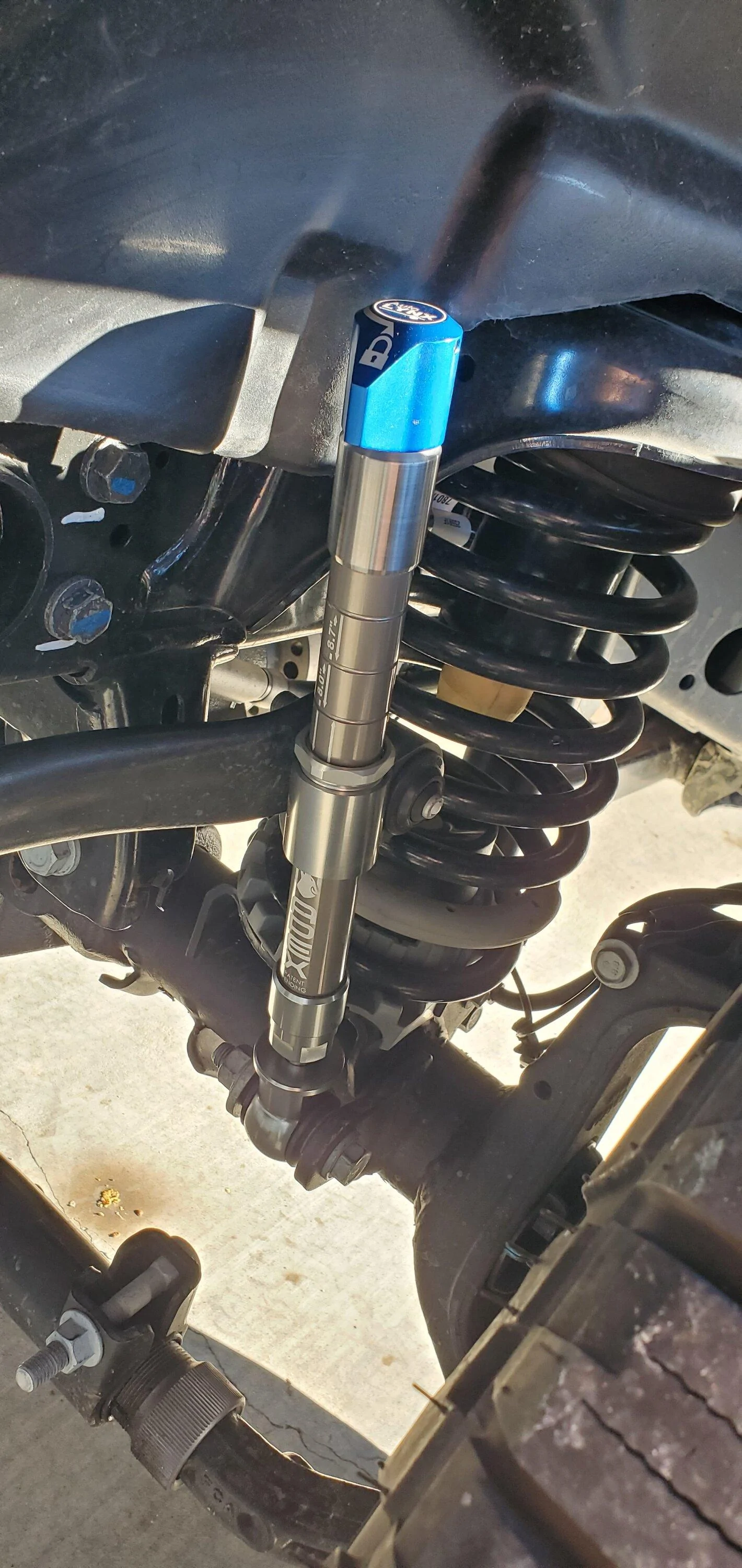

Installed Apex Autolynx Disconnects. This is the 8" version. Love them so far.
Jeep Gladiator Chris's Sport S Max Tow - Boring Daily 'Build' 20221120_150546
Jeep Gladiator Chris's Sport S Max Tow - Boring Daily 'Build' 20221120_145510
Jeep Gladiator Chris's Sport S Max Tow - Boring Daily 'Build' 20221120_145441

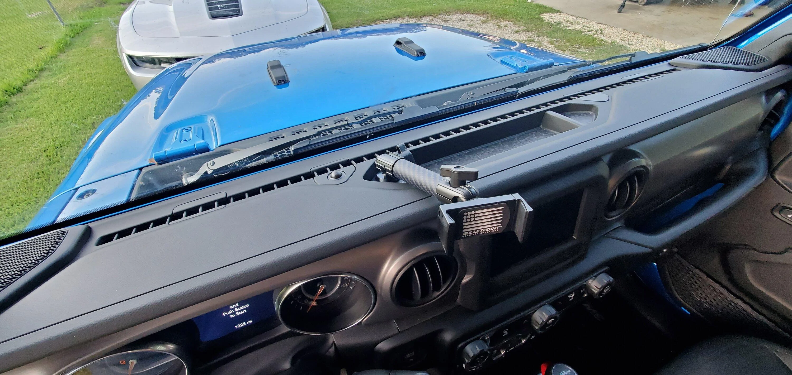

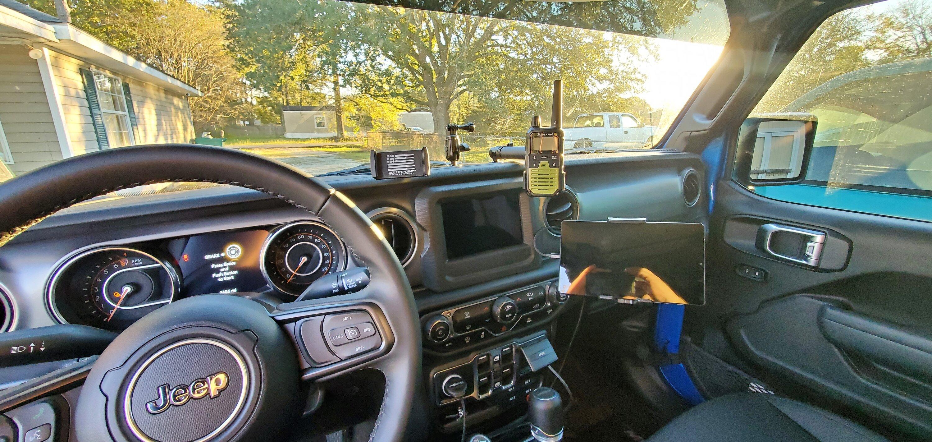

Upgraded my Bullet Point phone mount to include the Rubi Grid system. I have a Go Pro mount now (may swap this to hold an InReach device), a place for my handheld GMRS finally, and I added a Bullepoint tablet mount off the passenger grab handle and picked up a new (basic) Samsung tablet to run Gaia with on future trips we are planning.
Jeep Gladiator Chris's Sport S Max Tow - Boring Daily 'Build' 20221130_162735

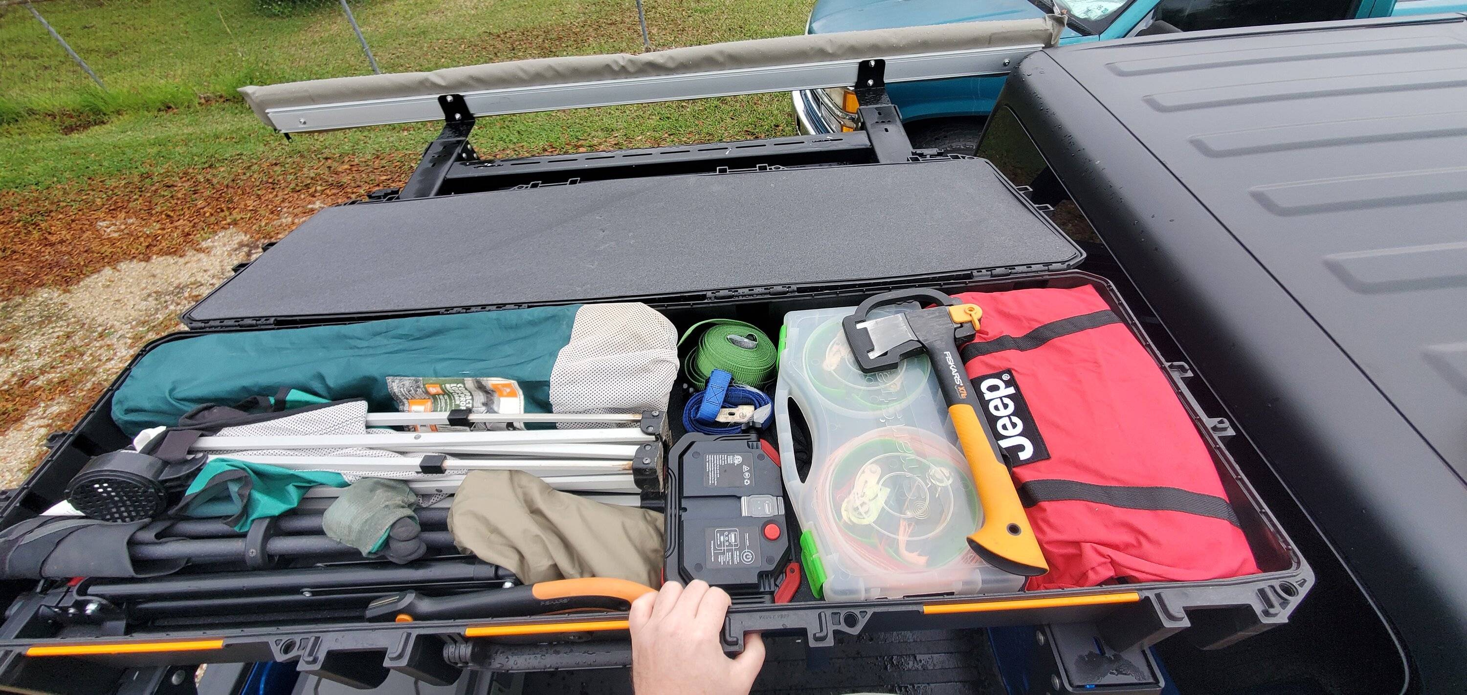

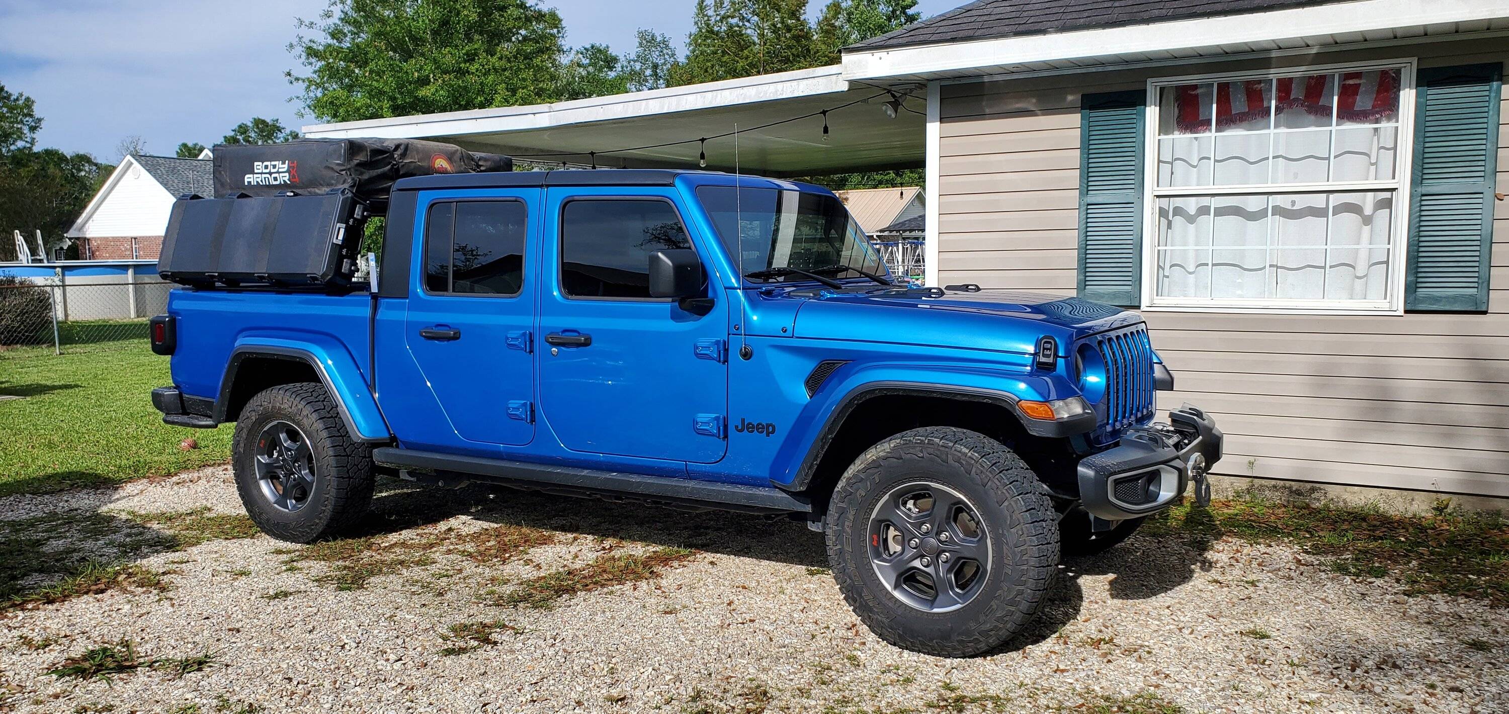

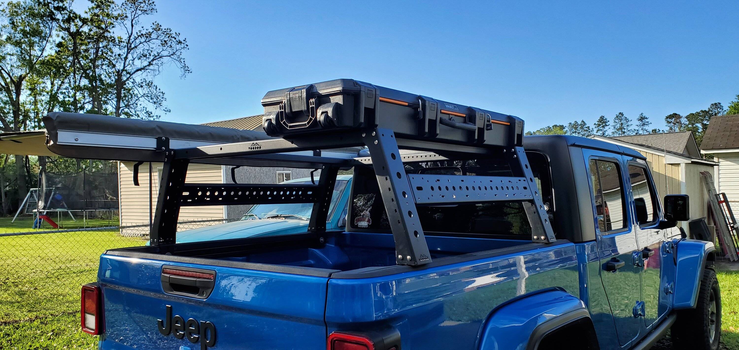

So my buddy was selling his KB VooDoo 18" aluminum bed rack and I picked it up for a good deal. We do some camping and road trips (I'm not a fan of the term 'overlanding', lol), so I wanted an awning like I had on my teardrop a few years back, and more storage up high. I want to keep the bed as empty as possible when not on trips so I can use the truck like a truck.
Rack, Ironman 4x4 6.5 awning, Pelican Vault V800 case.
Jeep Gladiator Chris's Sport S Max Tow - Boring Daily 'Build' 20230313_172403

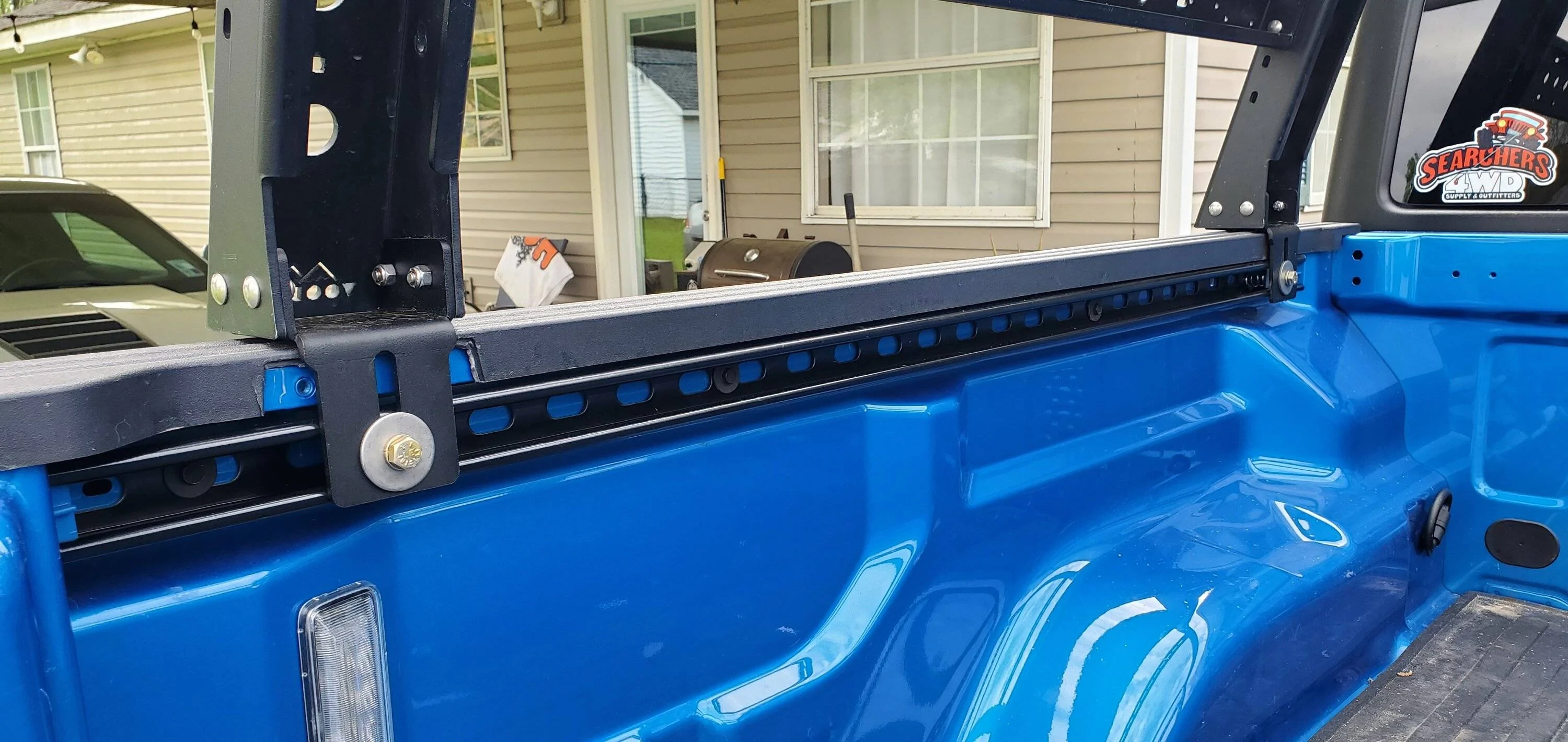

Made my own rails to mount the rack with. This is the deep galvanized super strut from Home Depot. I primed it and painted it matte black.
Jeep Gladiator Chris's Sport S Max Tow - Boring Daily 'Build' 20230312_104311
I don't typically keep my hatched, hand saw, or tripod and light up here but this gives you an idea of the space. My two camp chairs, foot stool, straps and ropes, gloves, awning stakes, and recovery bag stay up here all the time - leaving a little space for mission specific extras.
If I like the box over the next month or two, I'll buy another one for the driver side.
I'm going to take the straps out of their fancy box and make them more compact to give me more space. If I took the 2.5" of foam out of the lid I'd have even more space to use.
Jeep Gladiator Chris's Sport S Max Tow - Boring Daily 'Build' 20230318_112529
