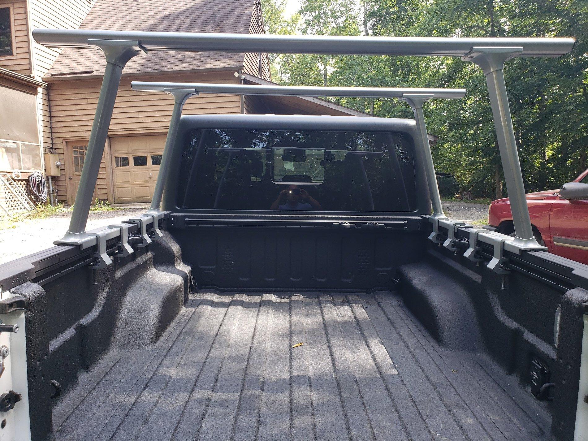

I got an Thule Xsporter because I like how the uprights are vertical like the cab of the truck. I've been looking around on the forum here and cannot see the same issue I ran into. When you really tighten down the clamps, it compresses the plastic bed rail cap and over a short time period, the clamps come loose because the plastic cap isn't solid. See the deformity circled in the picture.
Does anybody have any idea's on how to prevent this? Just don't tighten it that much?

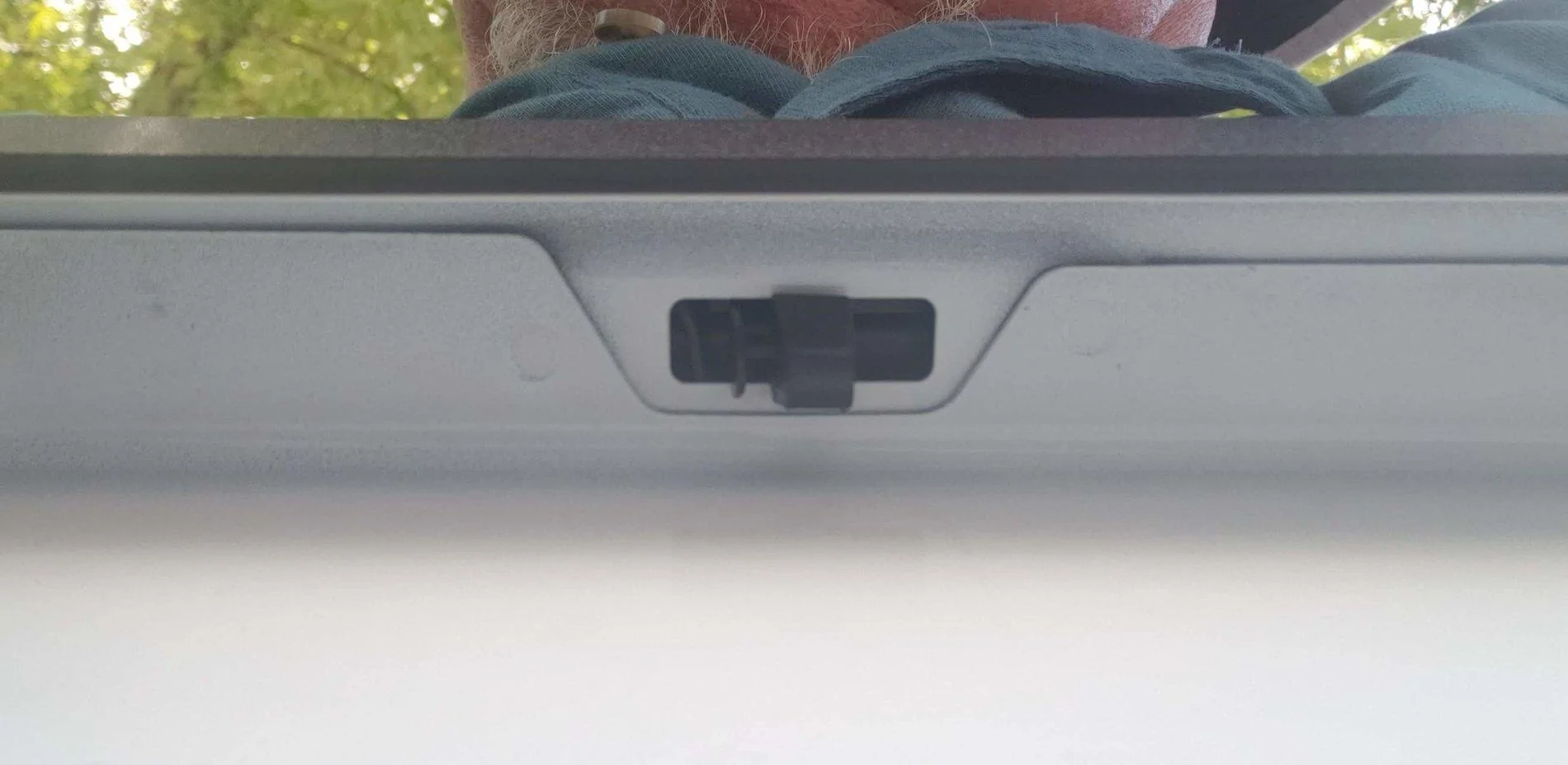

My only idea would be to add some material at the top and the bottom of the clamp to spread out the load and not warp the plastic as much...
The top of the clamping surface is pretty solid 15" of aluminum, the bottom is the steel edge of the bed and each clamp has a 4" bar on the bottom spreading the load there. The problem, I think, is there are voids in the bed cap allowing it to compress at those points. I don't know how to pop it off to check. If I could, I could fill those voids with epoxy or something to make them solid.
Here's a pic of the clip on the underside, any thoughts

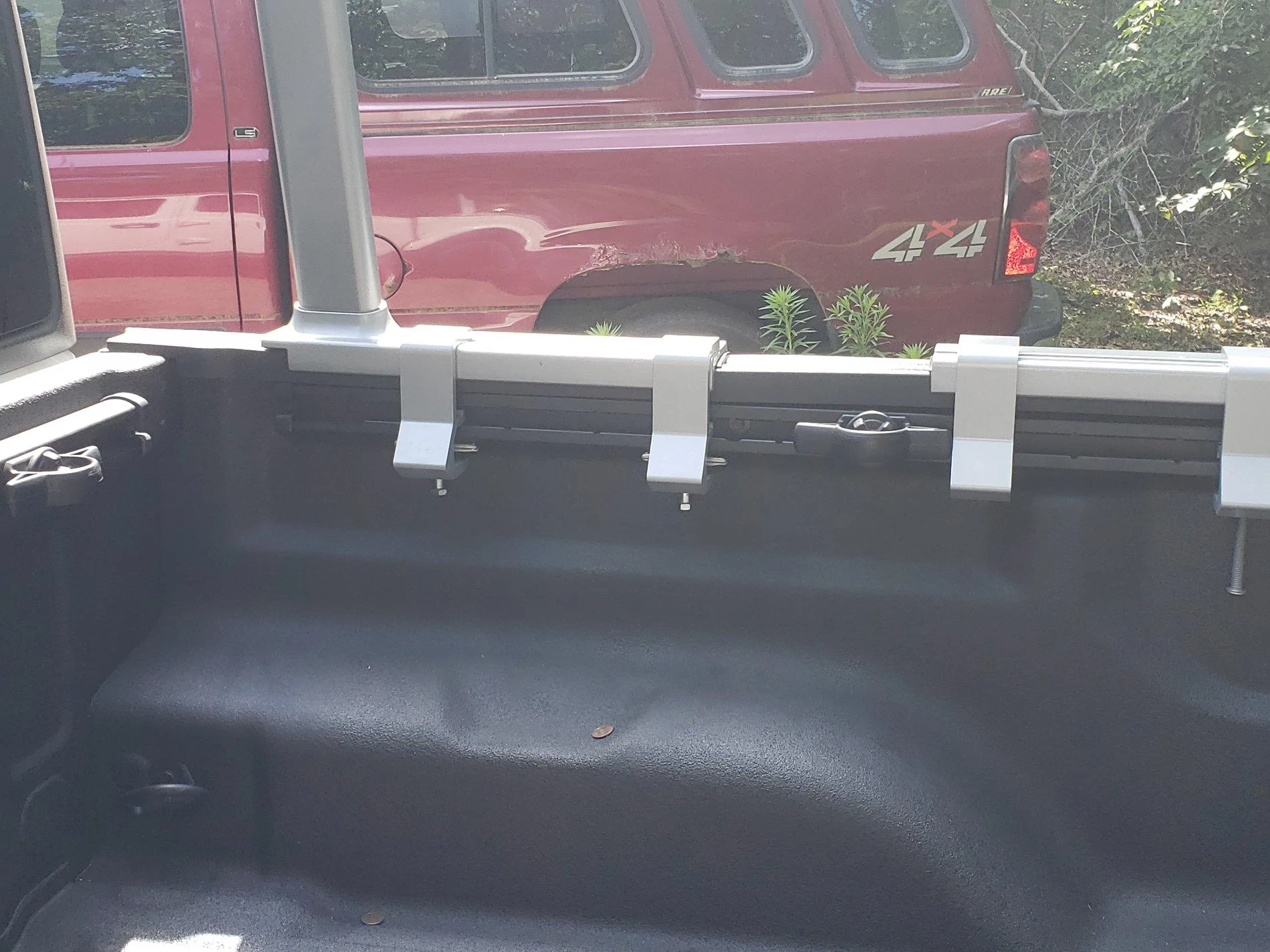

Does it on mine too, but within a day after removing the rack they flattened back out to where you can't tell anything was mounted. I didn't have any issue with them coming loose, they stayed tight for the 3 weeks they were on. I have the TracRac.
If anything, based on your picture, they're not tight enough...Here's a better pic that shows how much they compressed on mine:
Thanks for the comparison, I'll crank down a little harder next time I put the rack on. And you're right, they flattened out fine shortly after taking the rack off.
