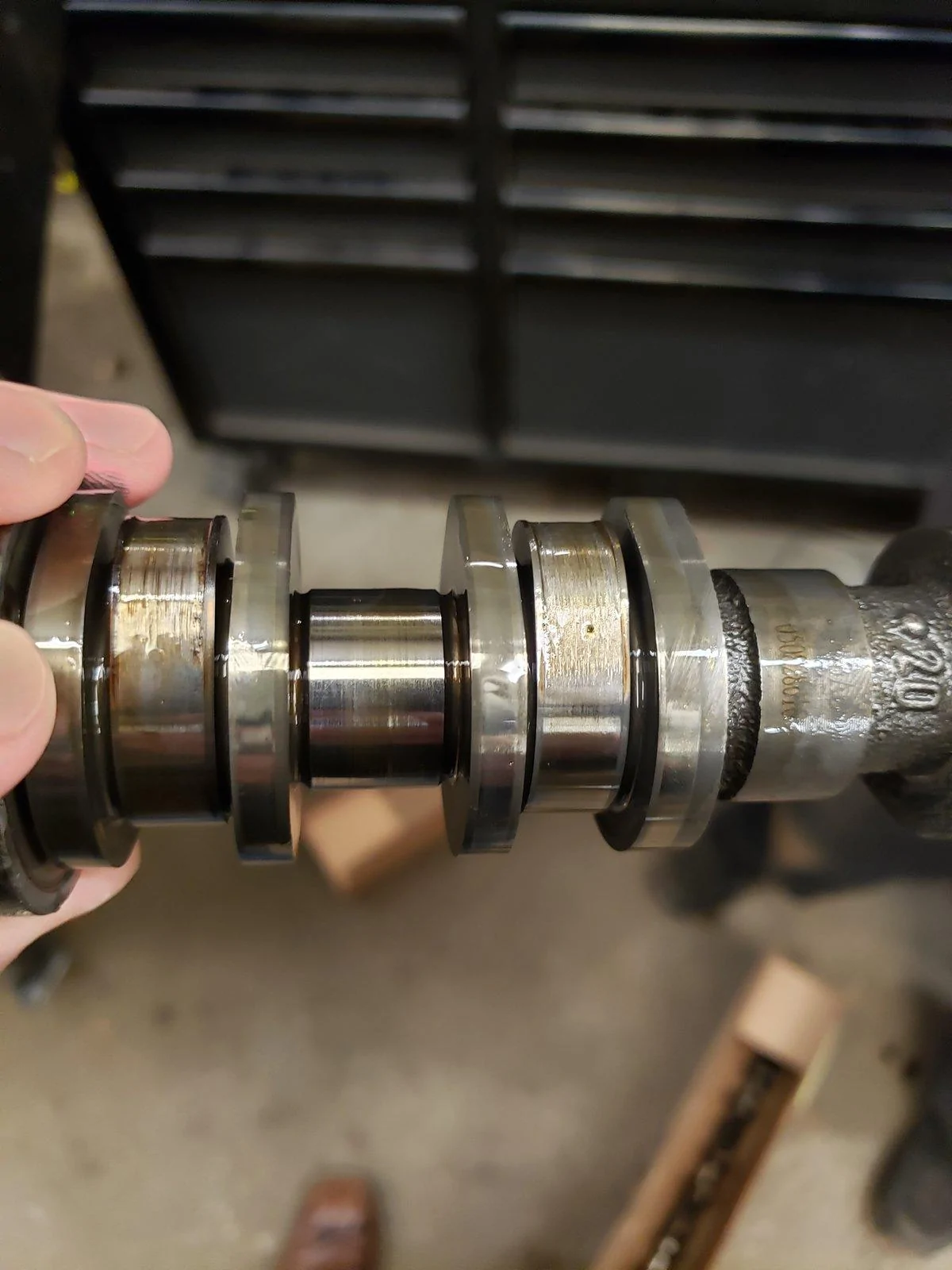

This is a Jeep Gladiator 3.6 cam and followers -
Jeep Gladiator Class action lawsuit against fca 0225221846a

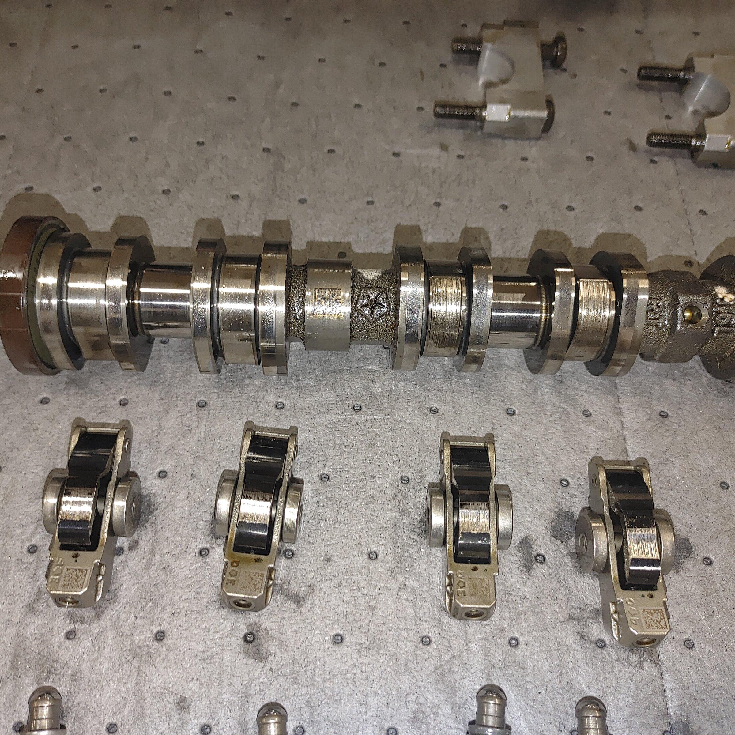

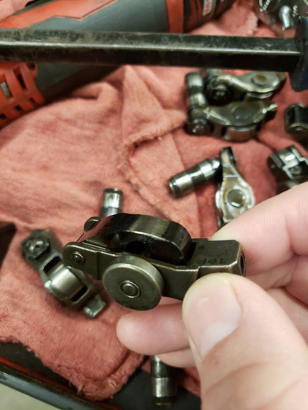

Here is a 2019 Wrangler cam and rockers - showing both the 2019 Wrangler and the 2020 Gladiator used the same engine, same cam design, same rocker design, both have variable valve lift (VVL)
Jeep Gladiator Class action lawsuit against fca wranger-cam
Jeep Gladiator Class action lawsuit against fca wranger-rockers
I’m well aware that both models had VVL. I don’t think there was any dispute on that. I was simply stating they may have made a change in how the part was manufactured which would exclude certain model years. From the photos you posted that doesn’t necessarily look to be the case.
