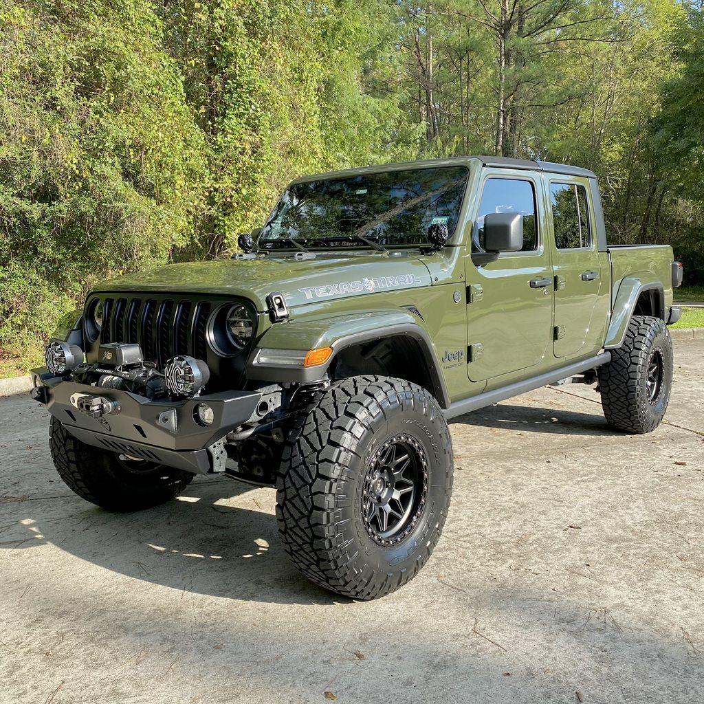

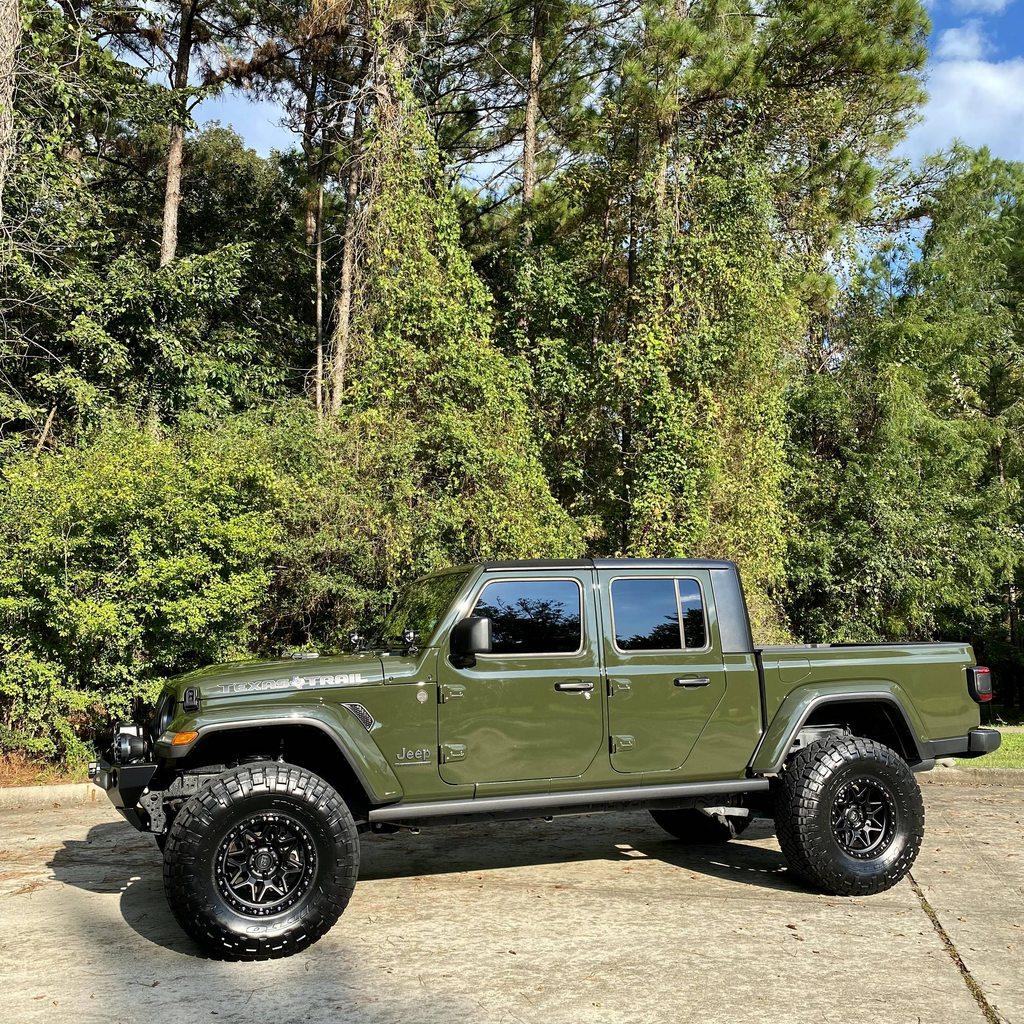

Just got my Clayton lift installed and man, what a difference! It looks great and rides great. I'll eventually replace all the control arms with Clayton adjustables, but for now, this is working just fine. For factual purposes, I did install a .75" spacer in the front to account for the weight of the winch and bumper.

Looks great! I just ordered this kit. How much lift over stock did you gain?

havent measured but it’s considerably more than my old Mopar 2” lift

That's good. I'm on Rubicon Launch Edition springs now.

If you didn't install the spacer, would you have a rake to the front??

Gonna revive this thread. Did those who installed the 2.5 ride right, install or add bump stop spacers? I'm looking to run 35s on +25. Sport. Thinking about the metal cloak stops so I can add them as needed.

Might want to verify the lift will work with your planned +25 wheels. I think Clayton's control arms forces you to a - offset

Yes, I recently had some bump stop spacers installed on the front to keep the tires from mashing into the wheel well so much. It was tearing up my JCR inner fenders without them.

Do you recall how tall you went ?

Thanks for the heads up. @BlueScapegoat thoughts? I know you run +25. Did you have contact on the control arms ?
