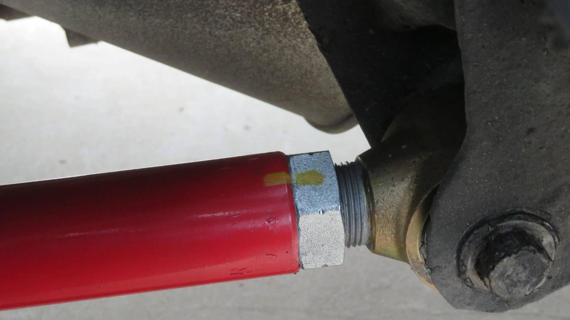

The jam nuts on Core 4x4 arms are 250 ft lbs on the lowers and 200 ft lbs on the upper fronts. 250 ft lbs on all rears. After you tighten everything up. Put a paint stripe across the nut and the bar. So if does loosen up. You can see if it happens.
Jeep Gladiator Clayton Jam Nut Torque 1735870494968-q8
