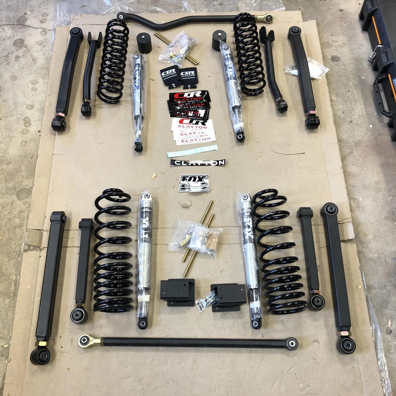

Thanks @Clayton Off Road. Everything is here and arrived in perfect shape. Your sticker overhead must be insane!!!
Now... can I convince the wife to watch the two year old for a few uninterrupted days while I get dirty... ;). 2.5" Overland with Fox 2.0's

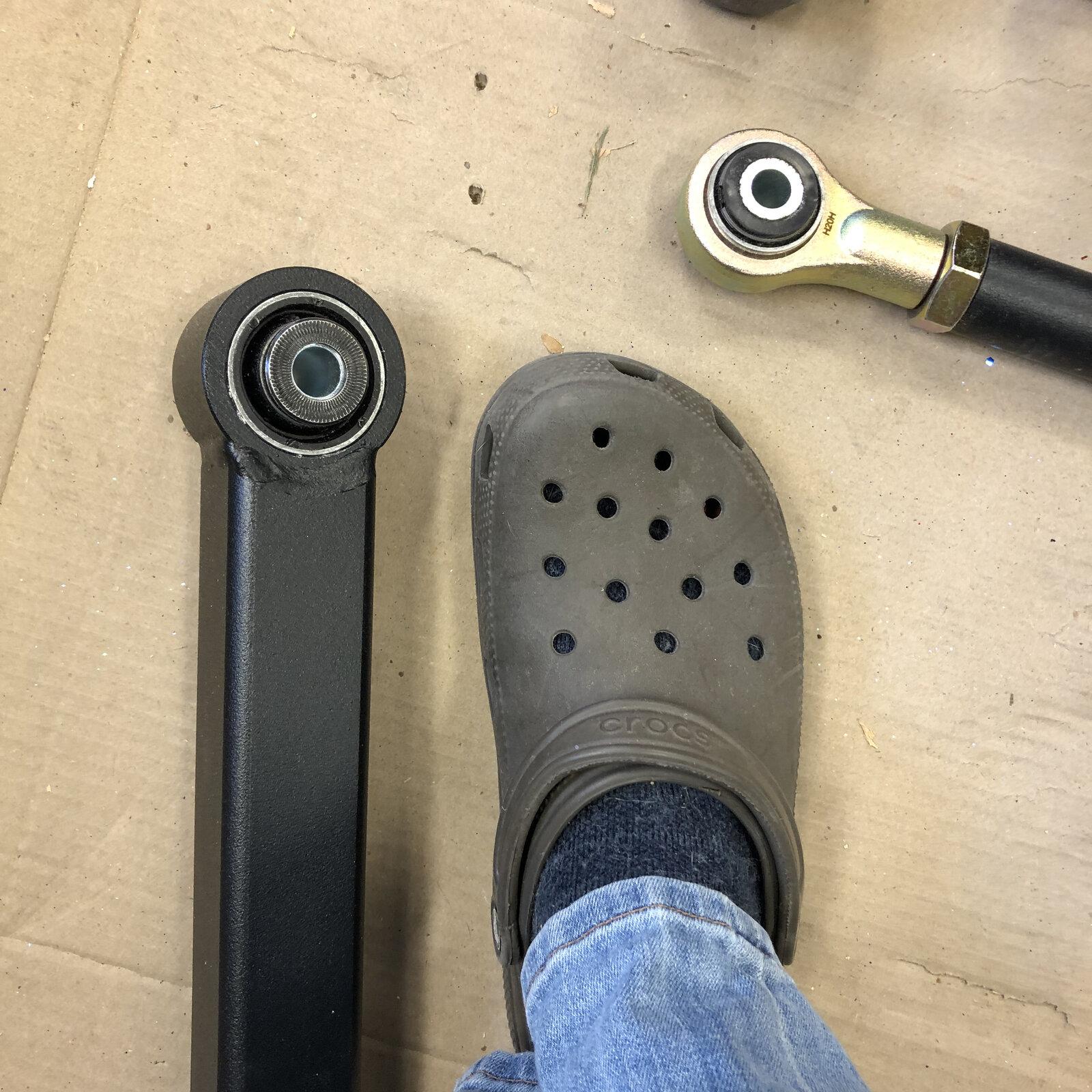

Size 11 Croc for size comparison, these are BEEFY!

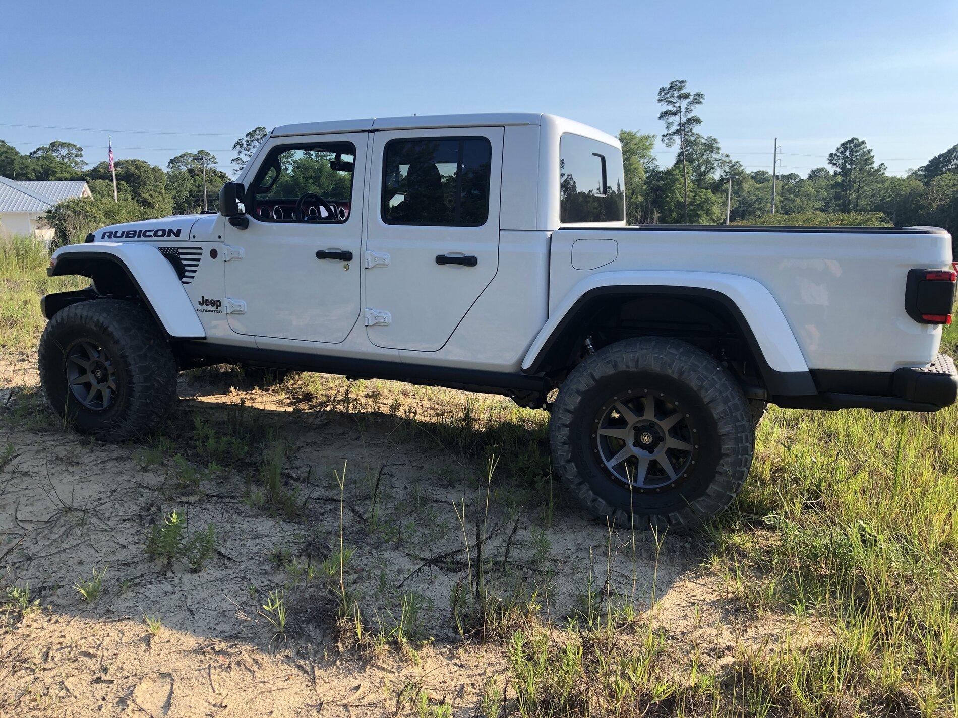

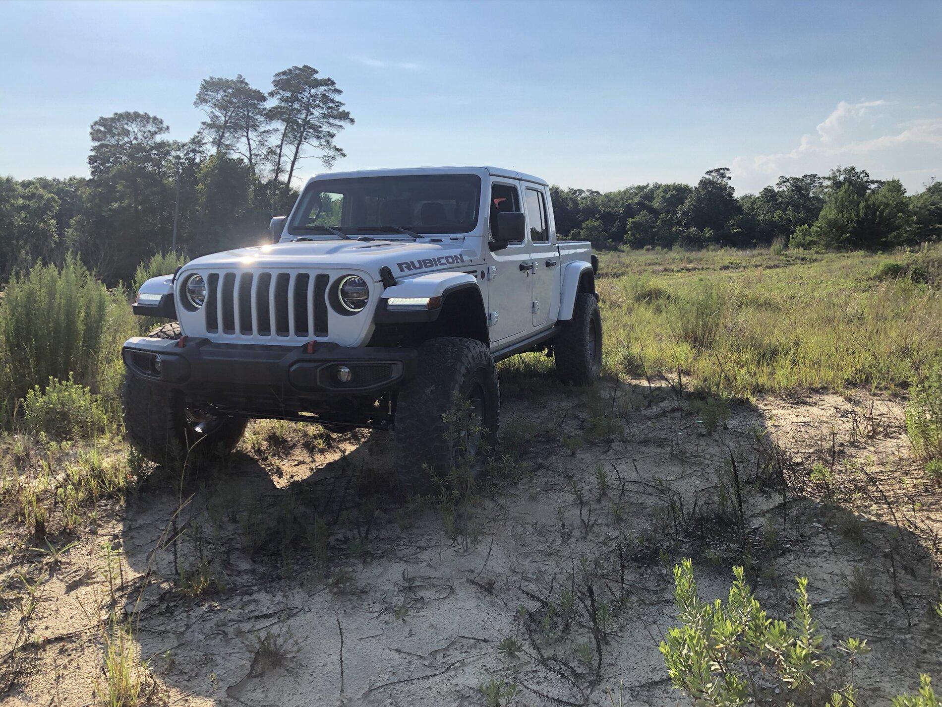

Guys this is the Clayton off-road 3.5 inch overland kit. Any questions let me know. Great kit Adam and the boys are very supportive and will take your call anytime. Tires are 37 13.5 18. I can fit 40s. No problem.

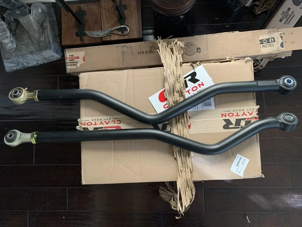

Here it is !! Just got mine. It's bent for success! The new JT rear bent track bar to clear 37" tires is on the top of the picture. Yea !
Jeep Gladiator Clayton Off Road JT Suspension Systems gHHOCM
Those are some nice looking track bars! ;)

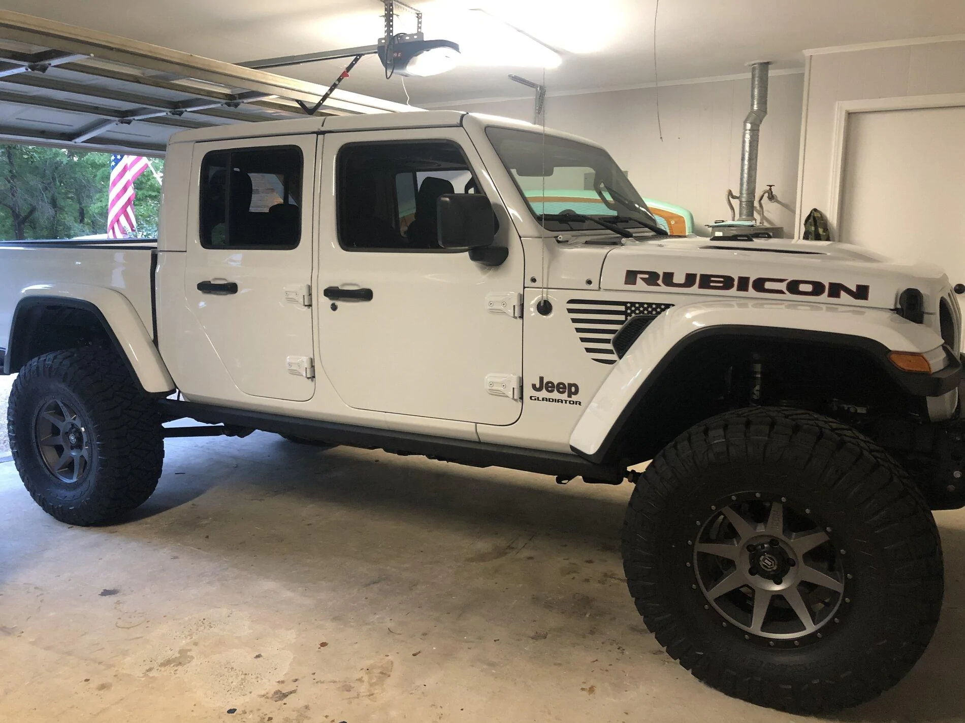

Can someone with the 3.5" Overland system and 37's measure from ground to rooftop for me please? I'm changing my order of a 3.5" ride right with 35's to the 3.5" overland with 37's and want to make sure it will fit in my garage. Thanks!
