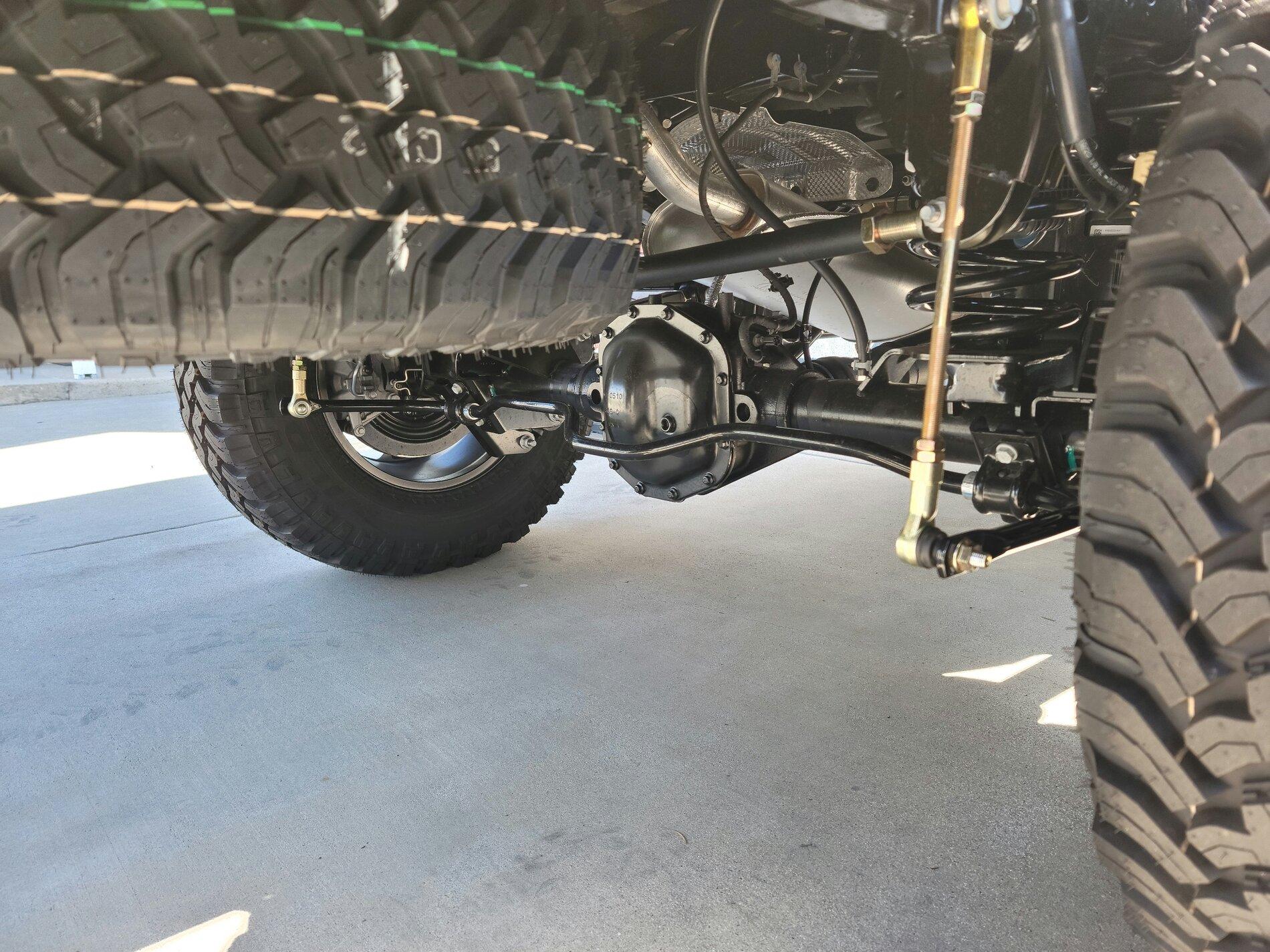

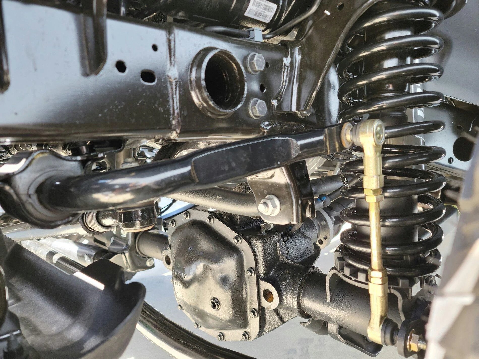

Congrats on doing your own install, that's always a great feeling! If you'd like, feel free to PM or email us some photos of the underneath and we can check everything out for you the best we can. The sway bar end links actually have a spot for an allen key to help hold them in place while you tighten, so hopefully that helps you out some! Again feel free to send over any pictures or questions to our email so we can help make sure everything works properly!
Thank you. I think I need a longer allen key.
Going to post some photos of the under belly on here so others can chime in and also may be helpful for other first timers like myself.

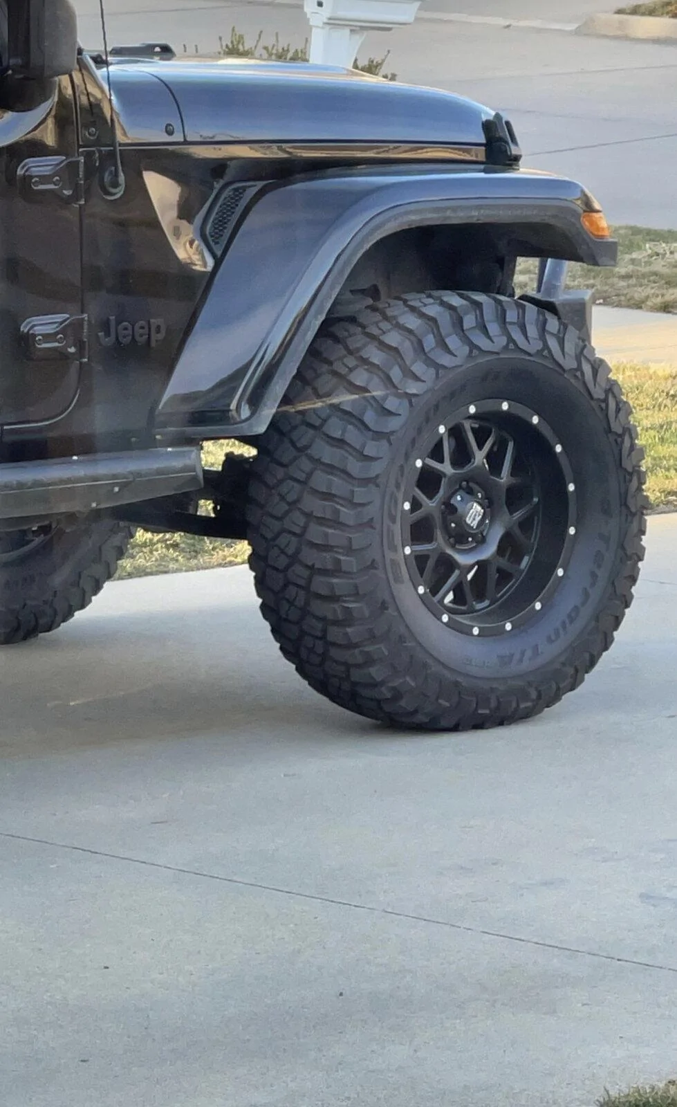

I really like your setup. I just bought the 2.5 Clayton. Do you think 37x13.50 would fit on those rebound 17x8.5" rims without rubbing inside? I'm torn between the 12.50 or the 13.50s.
I think they would clear fine. Truck is a beast in person. Huge difference over stock, so I’m not sure you will care about 12.5 vs 13.5 after you’re done installing everything.
RaiderGladiator
Chase
Dec 13, 2020
48
Iowa
2020 Jeep Gladiator Overland
I put 13.50’s on. 37x13.50r18 and they fit perfect. Absolutely no rubbing. 2.5” Clayton.

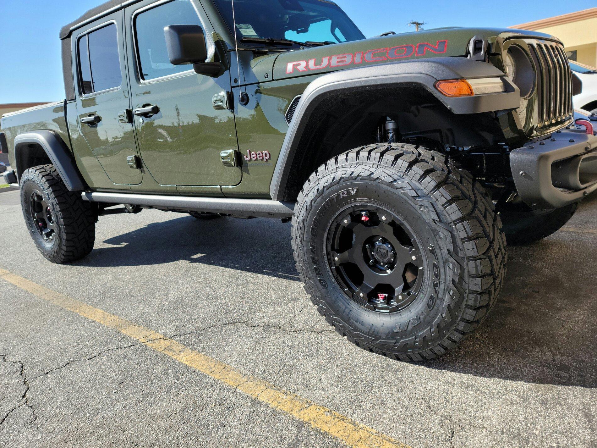

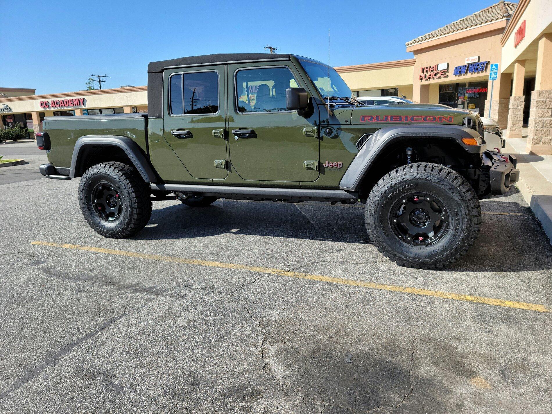

13.50 is sick. Thats real meaty looking. Got my Toyo RTs on. Will take a pic later.

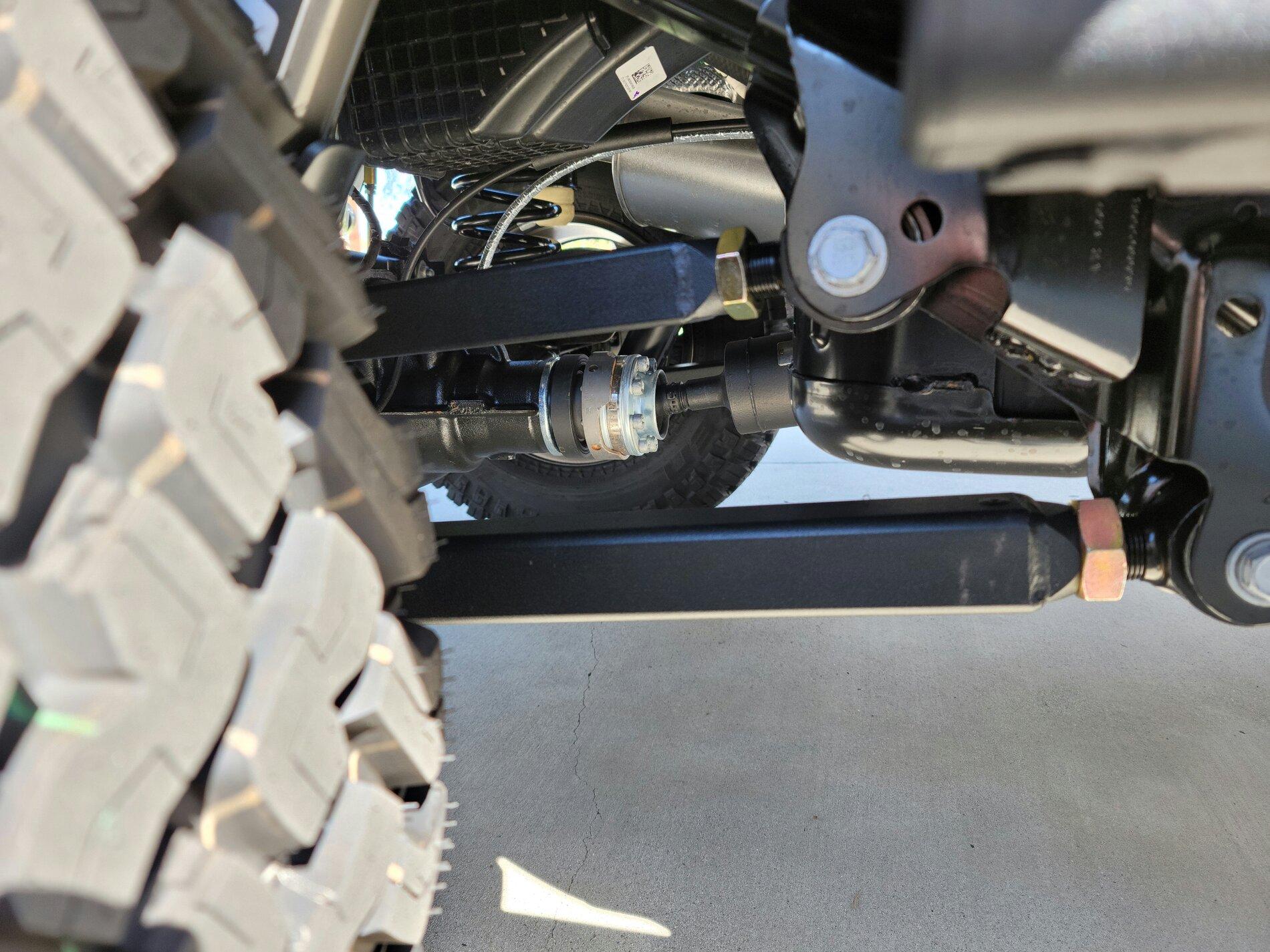

I'm still getting clunking noise at low speed over uneven rough road or backing out of the driveway. I've loosened all swaybar links then retorqued them on the ground. Any suggestions?
Hmm there shouldn't be anything else lift kit wise that would be causing a clunking sound in this scenario, give us a call when you get some time and we can help make sure everything is okay with those end links! Phone number is (203) 691 8593

since you have a Rubicon, disconnect the sway bar using the switch, and turn the Gladiator off. The sway bar will be disconnected unless you move it to be in line with the other side, then, it will automatically connect again. Now with no load on the sway bar, shake your end links. Mine were loose even though they seemed tight when the sway bar was connected and under load.

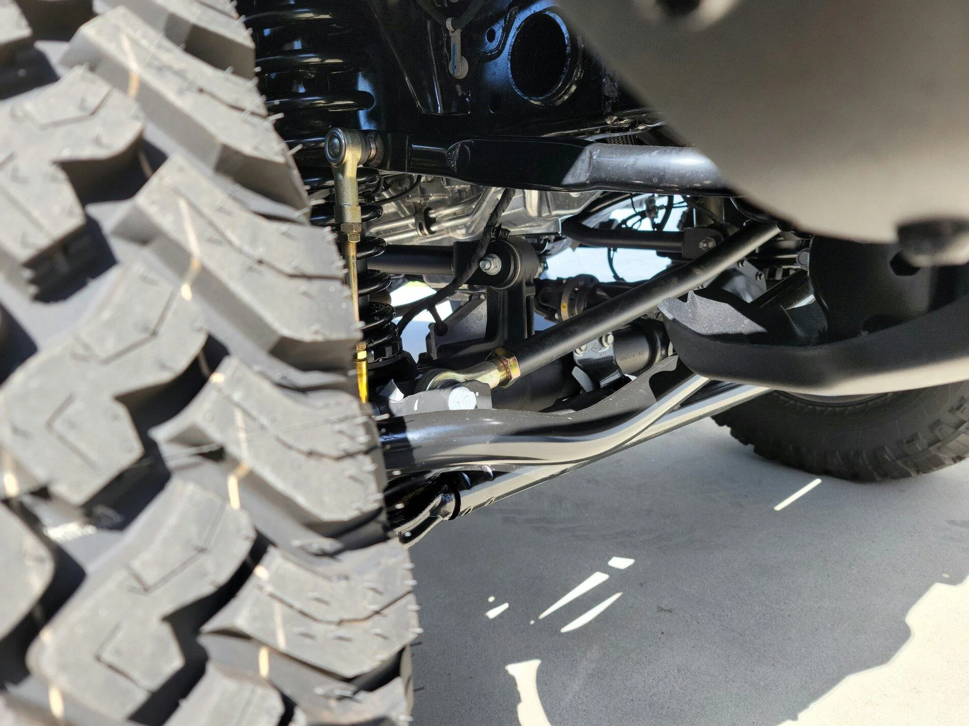

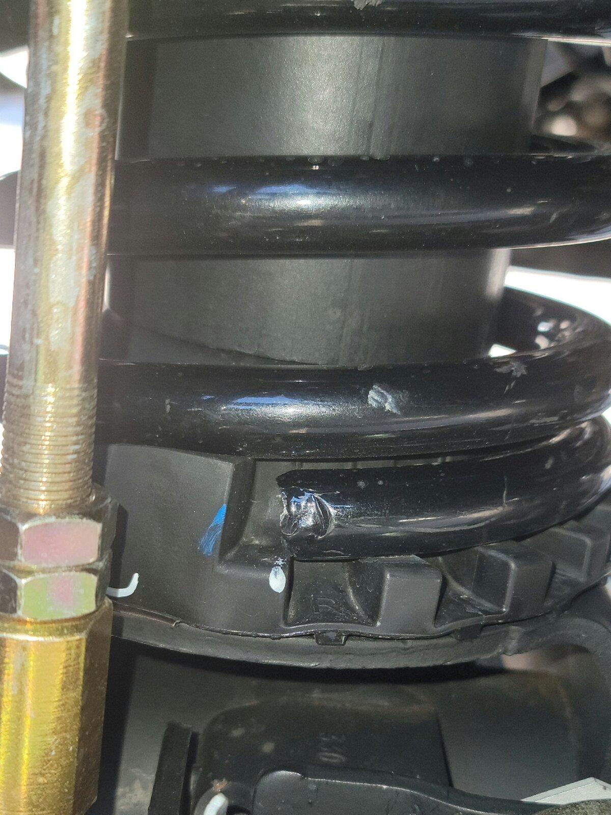

The front passenger spring isn't quite flush against the ridge. See photo. Would that be a problem?
Yes this coil spring needs to be rotated and flush up against that perch.
