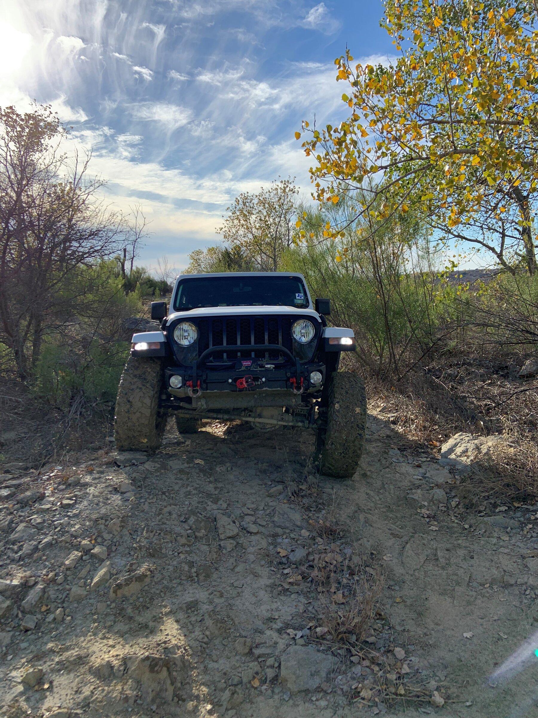

They don't stick out bad but I like the looks of a little "poke" on Gladiators and Wranglers. -18mm is just the right amount of offset IMO, I still just barely rub on the lower control arm at full lock with the 12.50" tires so any less offset would take away from my turning radius. I also rub just a tad on the inner fender at full flex, but I plan to do some aftermarket inner fenders and possibly a fender chop sometime soon.

I agree that they don't poke out too much, at least not for me. I like the look. Also good to know that you need at least -18mm to keep 37x12.5' on a 9.5" rim off the control arms.
I really appreciate your help!
Your wide axles give you a little more room for inside sidewall clearance.
I'm running 35x12.50 on stock 20x8 wheels with 1.5" wheel spacers. Equivalent to about +6mm offset. No rubbing on mine.

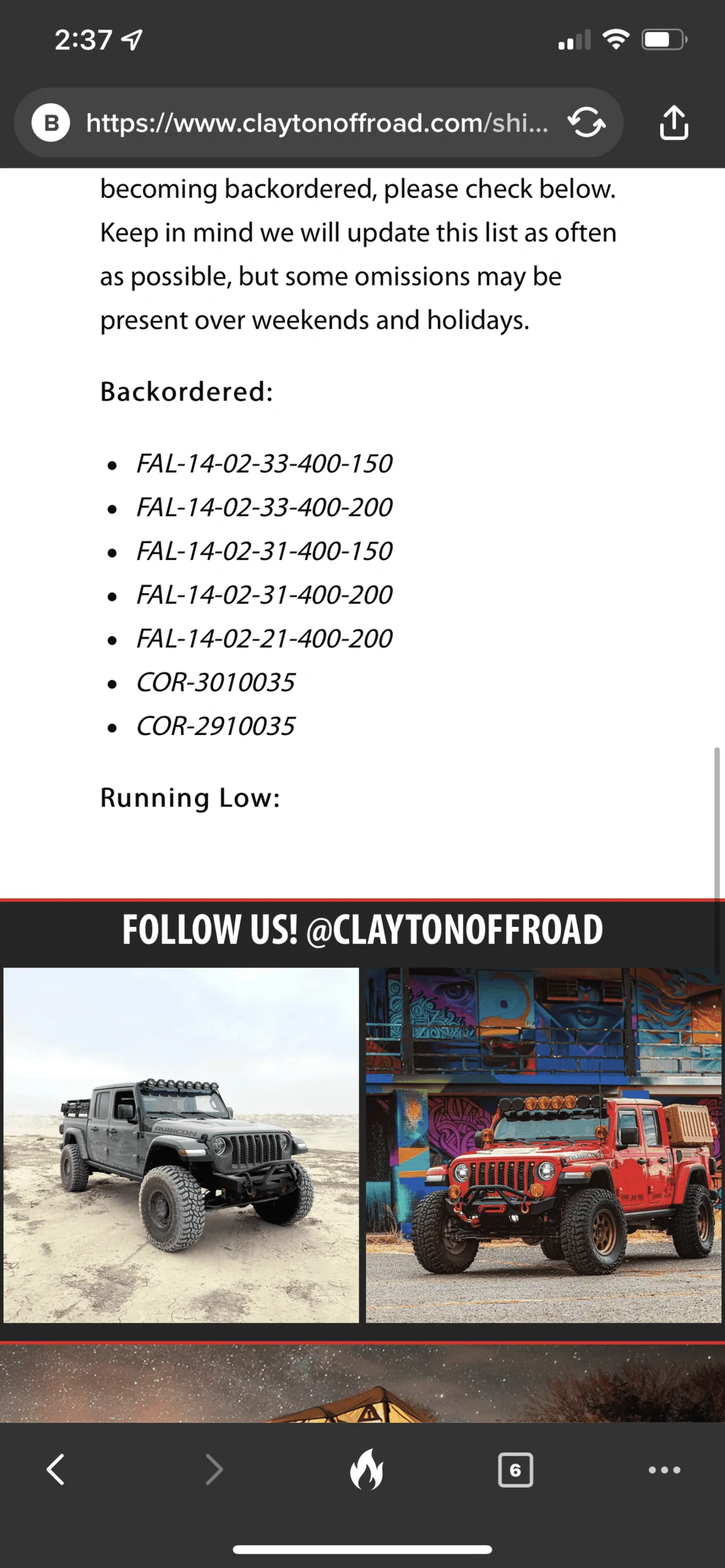

So…I haven’t heard any updates regarding your Diesel rated front springs for some time now. I visited your site last night and saw that several of the lifts were no longer in inventory. Any idea how long before you can stock back up?
Diesel springs are due in April! The kits listed as back-ordered have been taken off back off order status as of yesterday and are shipping again within 1 to 2 business days :like:
