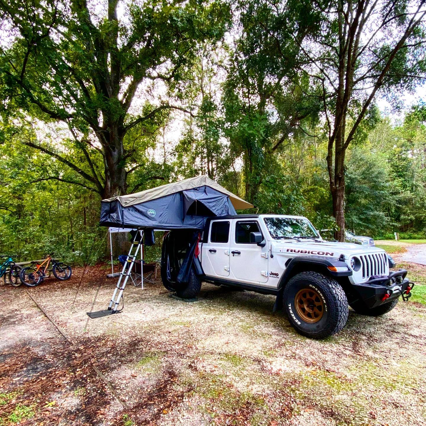

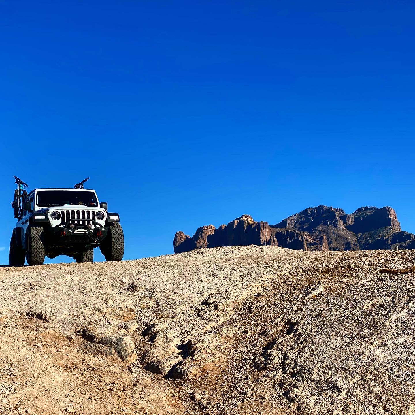

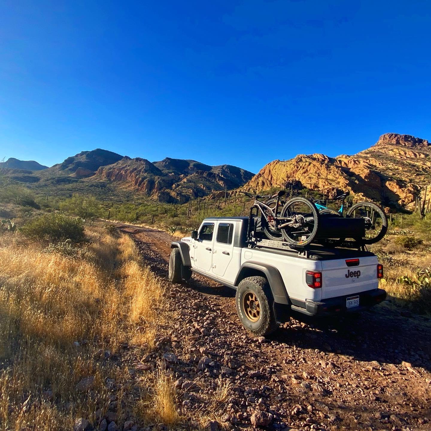

If this helps, I've been running 37's on the factory suspension & fenders for 16k miles now.
I've done some local off roading, as well as trails like Broken Arrow and trails in Bulldog Canyon.
I had a few mild rubs at Broken Arrow, but not bad at all.
If I could, I'd totally go 1.5" lift to make sure of proper clearance while keeping as low of C.o.G. as possible an hopefully keeping a few mpgs also.
Mind you, my rig was also loaded down with rack, RTT, gear, bikes, molle panels, winch, bumper and recovery gear and still had only minor rubbing.
Again, I'm not rock crawling (max flexing), but I feel really good about how well the JTR did off road.
I personally have my sights set on a Clayton 2.5 kit. (Also important to note, my understanding is that they actually are closer to 3") or Rock Crawler's kit because they have triple rate front and quad rate rear springs!
