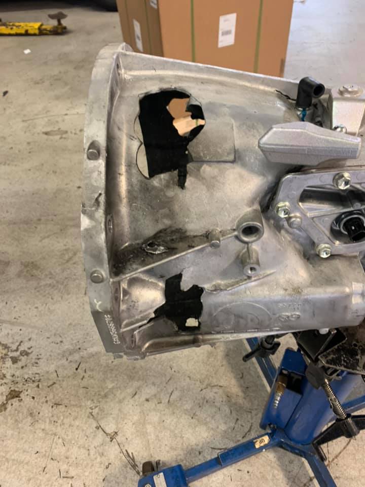

SUMMARY:
In some circumstances, the clutch pressure plate may become overheated through friction, which may lead the pressure plate to fracture. A fractured pressure plate may crack or fracture the transmission case, allowing heated debris to contact ignition sources on the vehicle, potentially leading to a vehicle fire. A fractured pressure plate may also lead to a loss of propulsion, or generation of road debris.

EDIT: The pressure plate in the Aisin D478 is being recalled but dealers do not have a fix yet. I assume this applies to ALL manuals, and Jeep has put a stop sale on all 6 speeds for the time being. I checked mine this morning and sure enough, risk of fire or basically a bell housing "explosion" when the clutch plate shrapnel goes flying through. To check your VIN go here https://www.mopar.com/en-us/my-vehicle/recalls/search.html
This was the recall info posted when I looked up my VIN. I assume this applies to the JL/JLU as well since its the same transmission. Maybe Jeep will swap us out with a better clutch now and junk the original setup....especially with the Bronco about to roll out with a 7 speed. It never made any sense that our tow rating was so drastically affected from the auto, maybe the speculation about a weak clutch was correct.

I'll be curious as to what the fix is for this. I also want to know what extenuating circumstances there were to it. I saw the JL guy saying he only had 96 miles on his JL when the thing exploded. What did he do in 96 miles that made it fail? Bad batch of pressure plates? Why is it suddenly an issue? I've got 8100 trouble and clutch-smell free miles on mine. I'm very leery of letting FCA do the work I'm going to take mine to a local indy Jeep only shop and have them do it. But I'm curious as to what they come up with as a fix. I really hope a much more robust clutch assembly which they've admitted was crap from the beginning.

It says there is a bad batch of pressure plates, which is part of the clutch assembly. There is no mention of a transmission problem, or a bad transmission
Very true, the actual transmission itself (i.e. the gears/splines/teeth/bands/etc) are not a defective unit as a whole. But given that the D478 is the only transmission to have said issue it becomes a "manual transmission recall". Considering it can blow out the bell housing its not far fetched to say it could easily shrapnel through the aluminum cab floor. Add the risk of fire and it is now easy to consider a "major" recall lol. I for one do not like the idea of driving a claymore mine with or without the option of spontaneous combustion.

If FCA, adds "Scatter Shield" instead of bell housing to the "pressure plate" parts list recall, then, you will have your bullet proof solution. lol.
