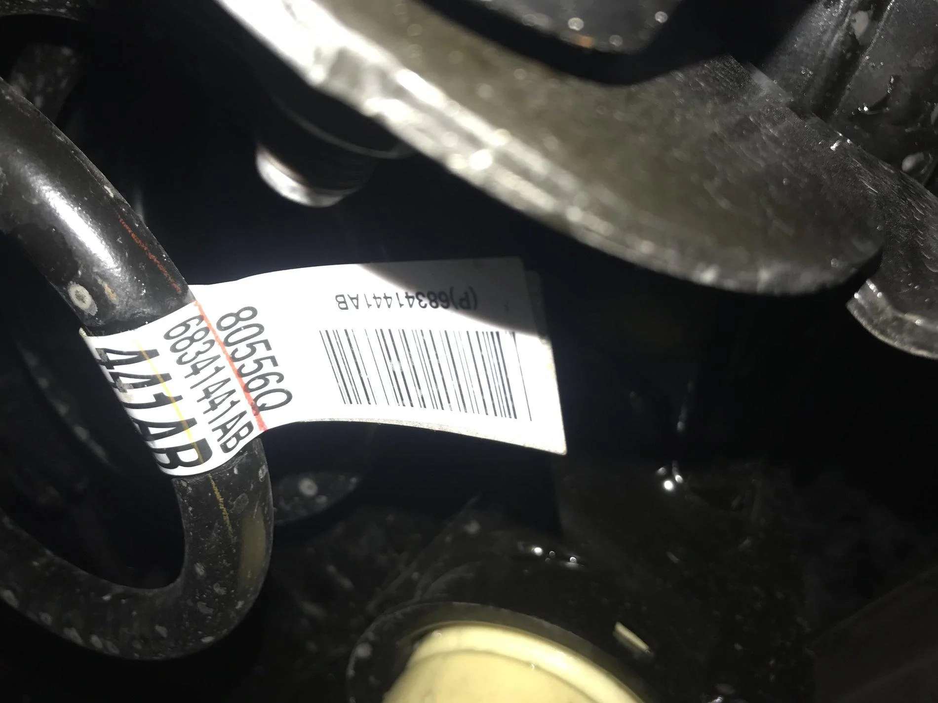

This is the tag on the passenger side rear coil spring from a Max Towing model.
Can someone with a Rubicon post pictures of the same tag? I'm curious if the numbers match or are close in sequence.

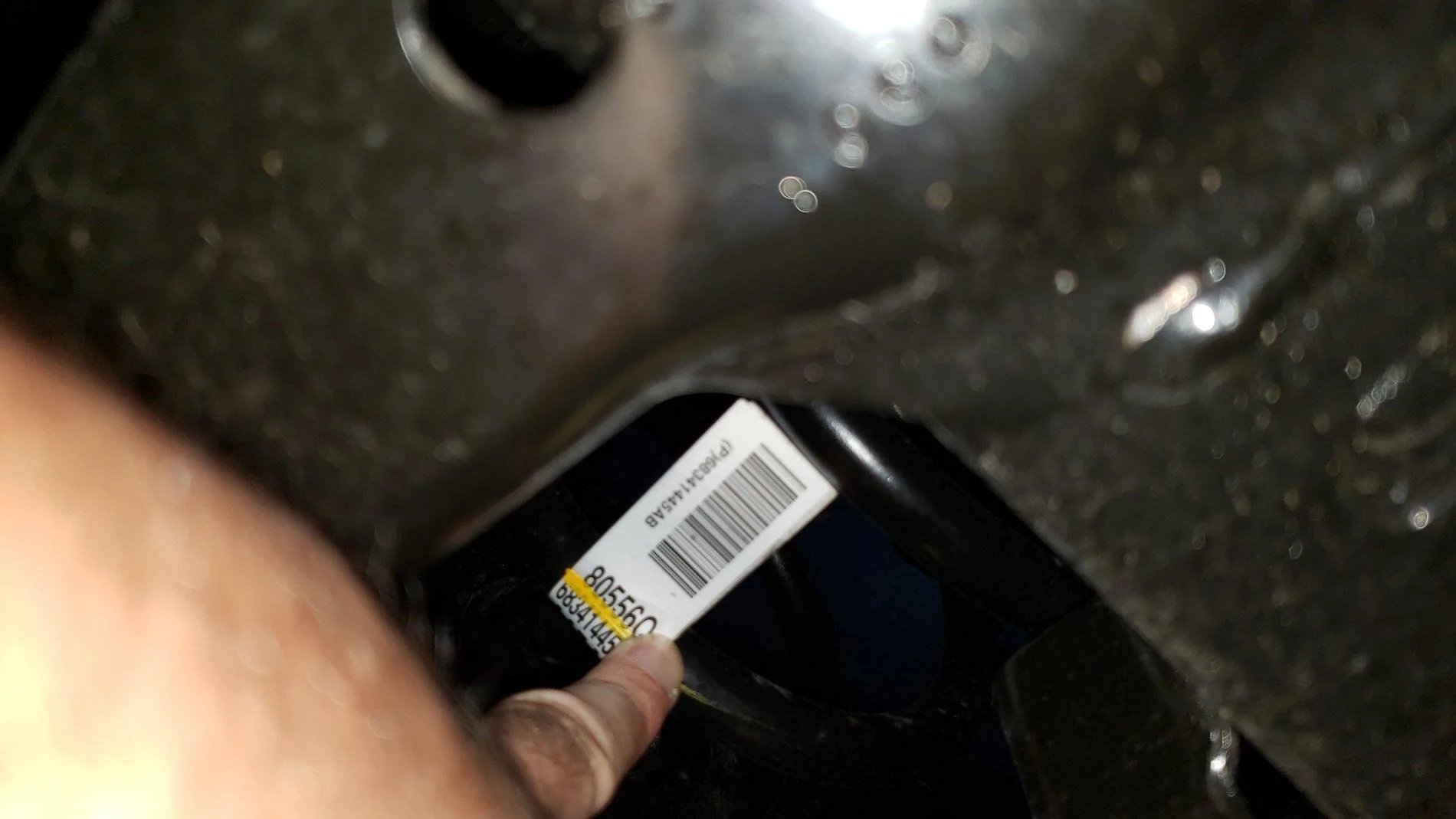

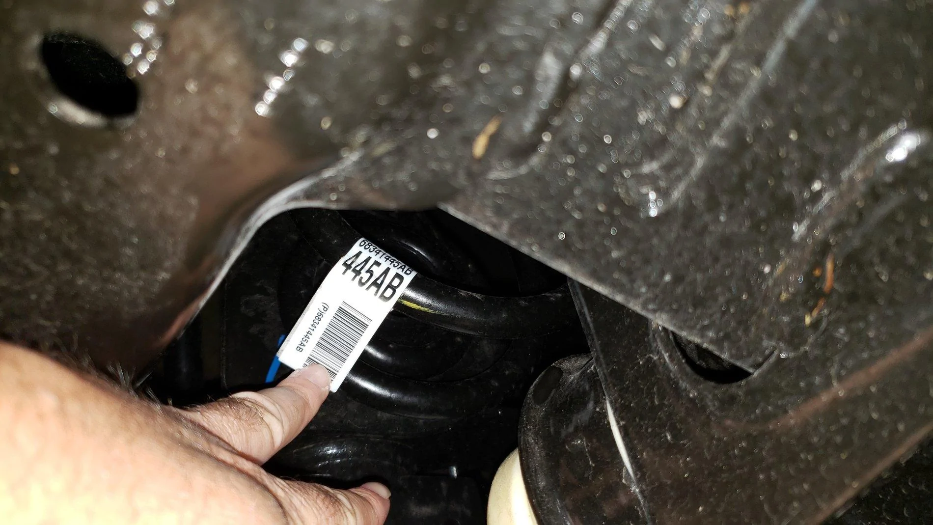

Well there we go, the rear coils on Rubicon are different.
So it really is a combination of spring rate, axle width, gear ratio, and transmission that causes there to be so many payload and towing numbers across the Gladiator lineup. It's like Baskin Robins... so many flavors.

Overland front with tow package

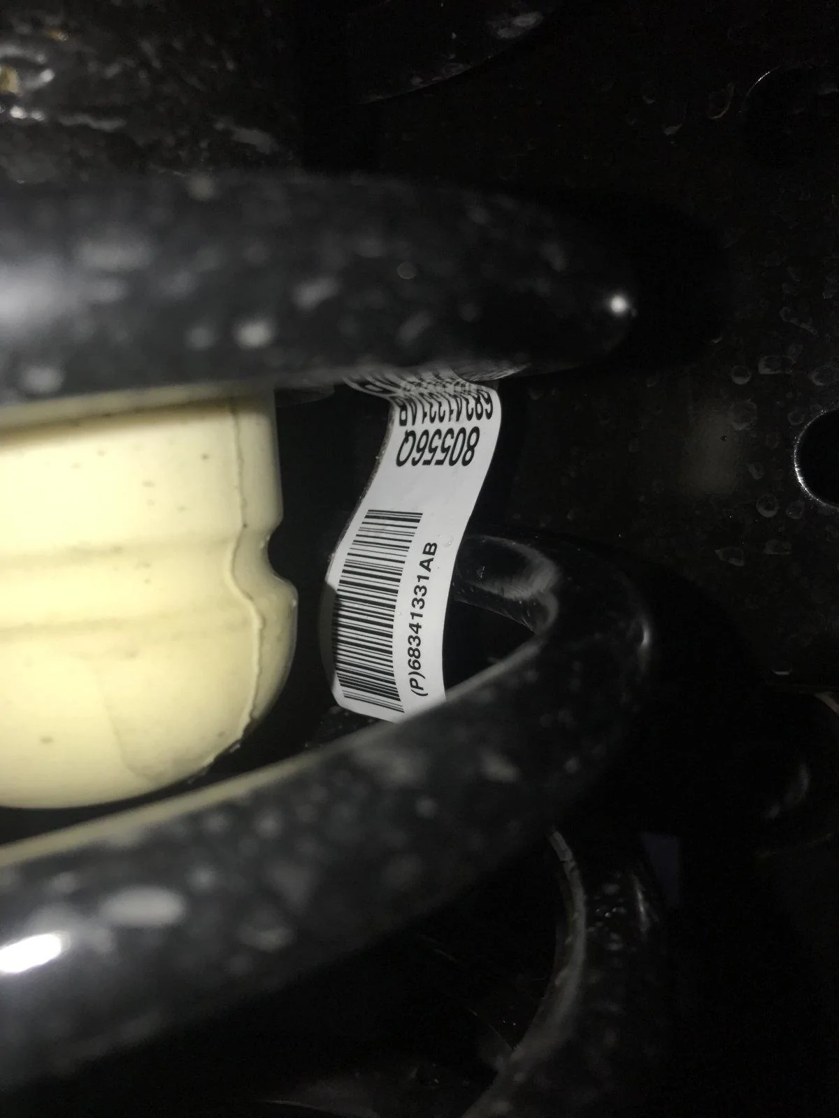

Overland rear with tow package

So, on the JK Wrangler the way this always worked was that the higher the part #, the taller/stiffer the coil spring.
Looking at these pictures, the Overland is lowest, then Sport with Max Towing, then Rubicon. So, it seems that all makes sense.
Can some other folks post your rear coil tags? I'd like to see a few more Overland, Rubicon, Sport and Sport w/ Max Towing JTs just to confirm.
