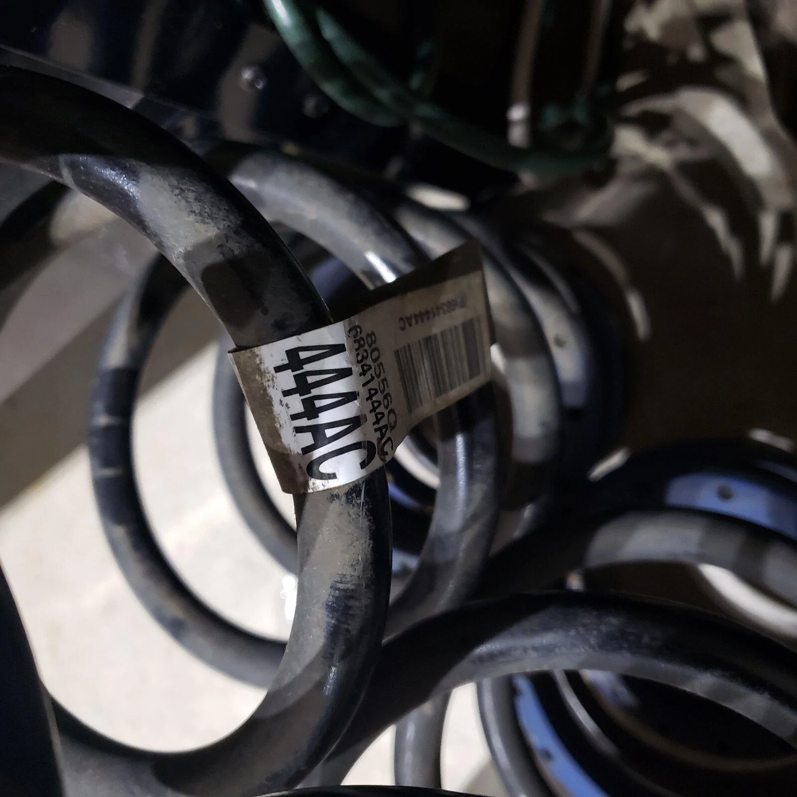

I picked up a set of sport s max tow and they are 445ab and 444ac. I'm curious if someone knows which code is for which side? These numbers don't match what's posted previously.
Jeep Gladiator Coil Spring Part Numbers 20210913_145214
Jeep Gladiator Coil Spring Part Numbers 20210913_145218
Higher number on the right passenger side.

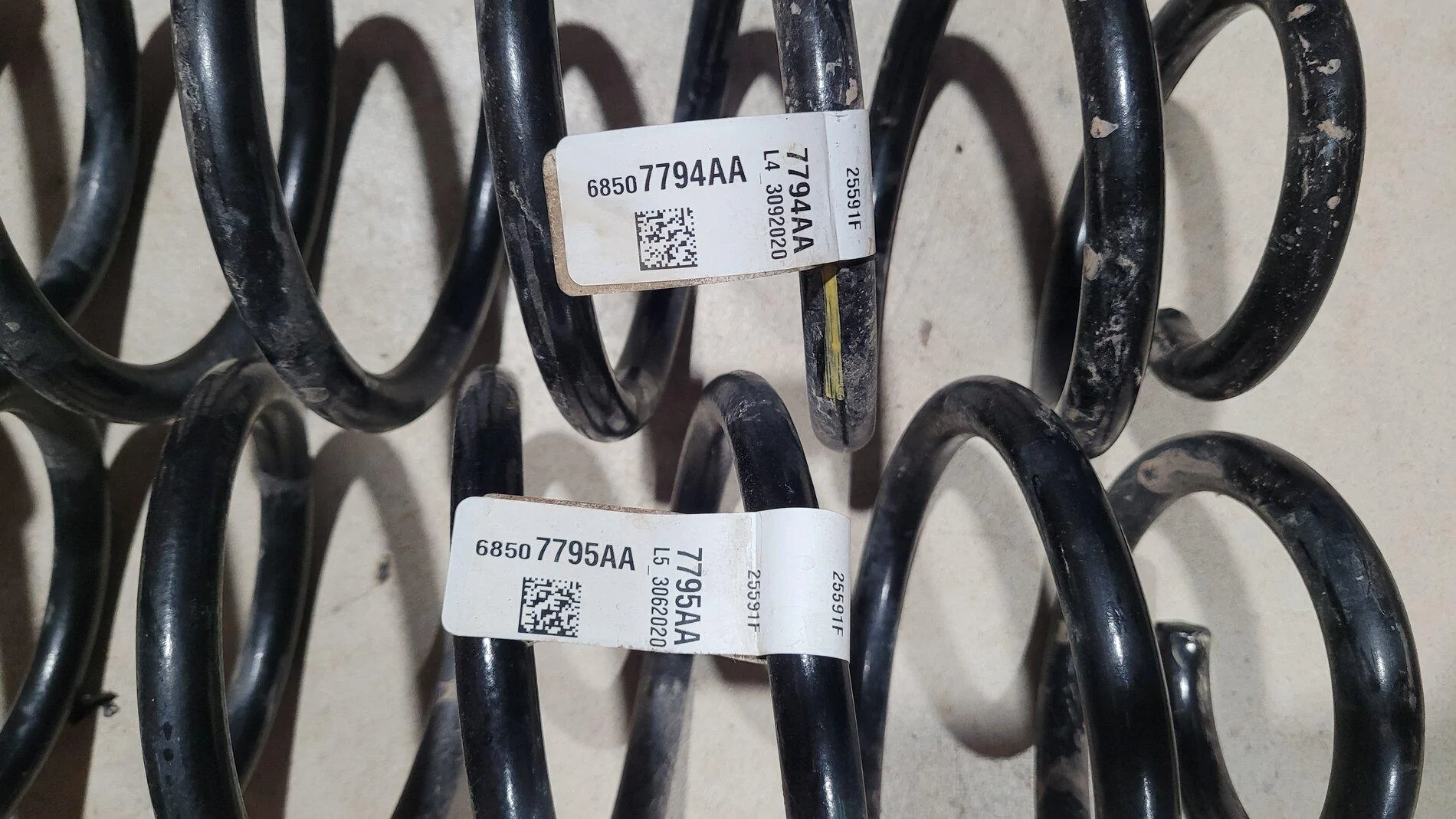

These came off my 80th anniversary edition:
Jeep Gladiator Coil Spring Part Numbers 20210912_082633
Possible Overland models use these same soft front Springs.
