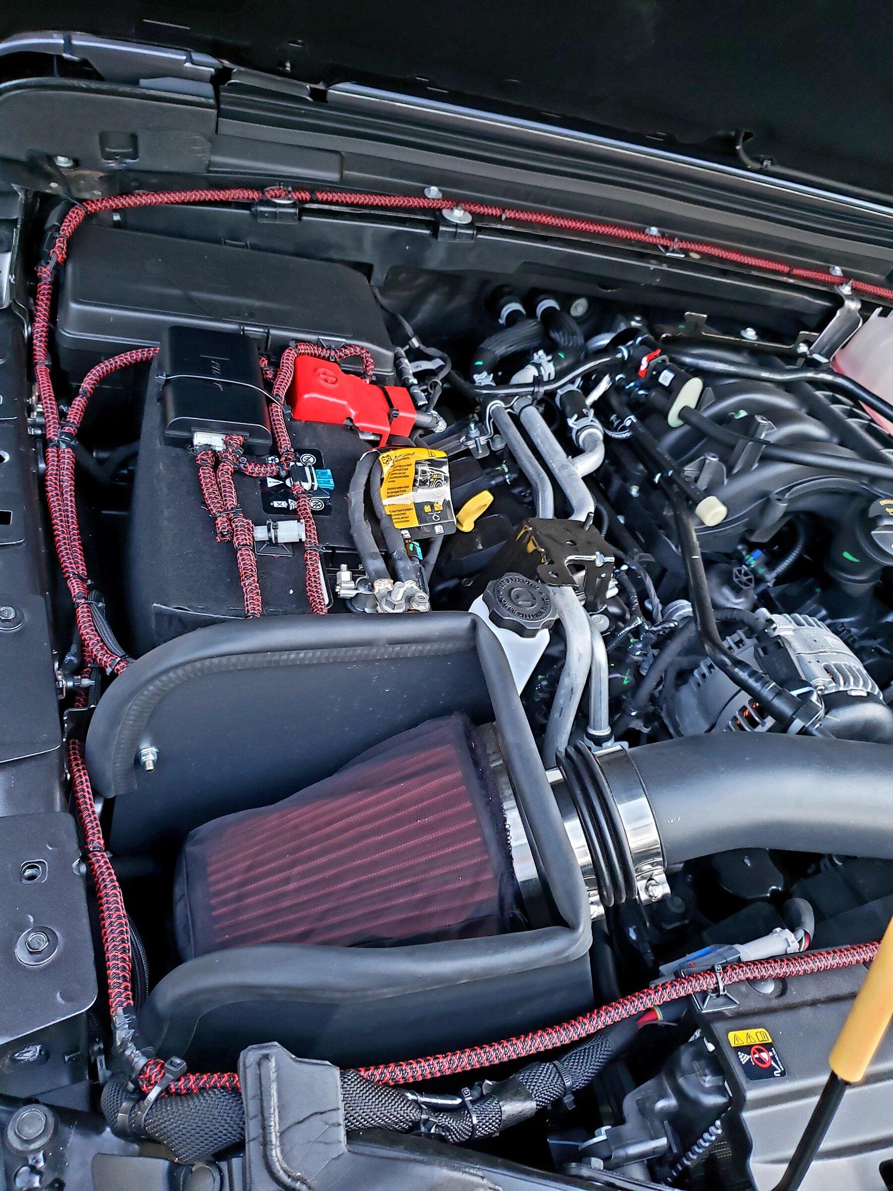

I've got the Rough Country Intake in mine. I won't even pretend there are any actual benefits to it, I just enjoy the sound. Especially with a manual transmission, it's much easier to hear the engine revving.
Jeep Gladiator Cold Air Intake 20220320_193805
