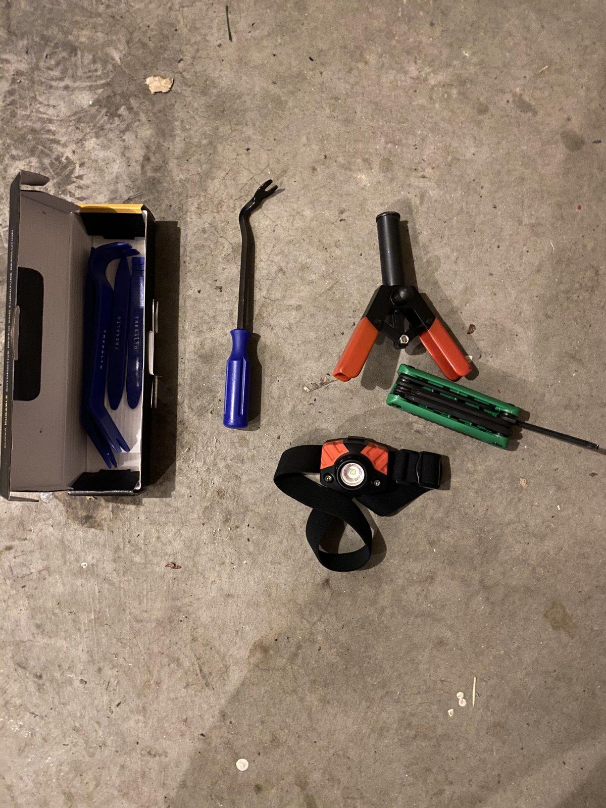

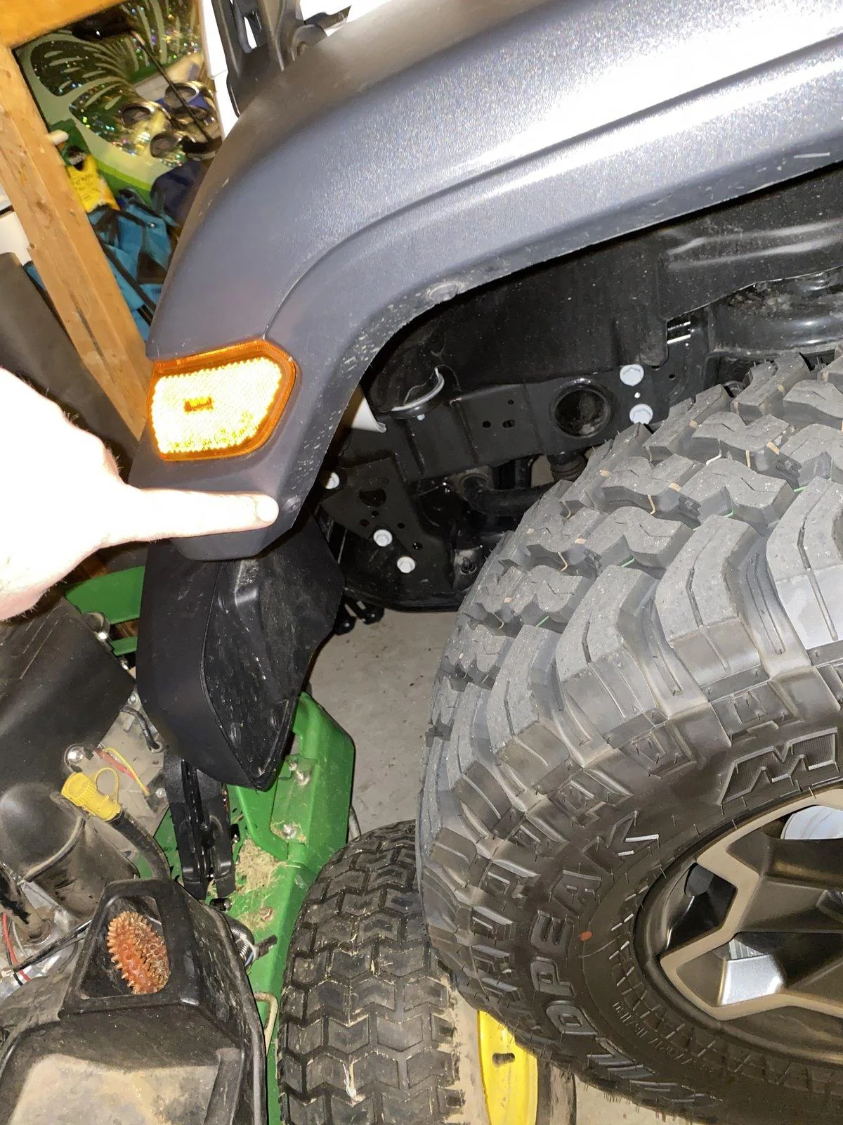

So I completed my install of the oem led package from halogens. I had zero background in this and I’m not that strong mechanically. For anyone that is considering it, it’s totally worth it. I think the fender drl leds/turns were the hardest part but I definitely recommend not cheaping out and getting a rivet set with the plier things that install the rivets and a set of those plastic pry bars with the skinny metal prybar as well. Probably the best 30 bucks I spent out of the whole install...saved me a ton of time. I did the fogs, headlights, turns and tails in around 5 hours total. Not sure if that’s good or bad....here’s a pic with the low beams and fog lights on. The cut off is crazy, it’s like a sunny day right to pitch black with no transition. Thanks to everyone that helped answer my questions. If anyone needs any tips on the process just ask. I’ll post some pictures and sources/videos that helped me out when I get a chance

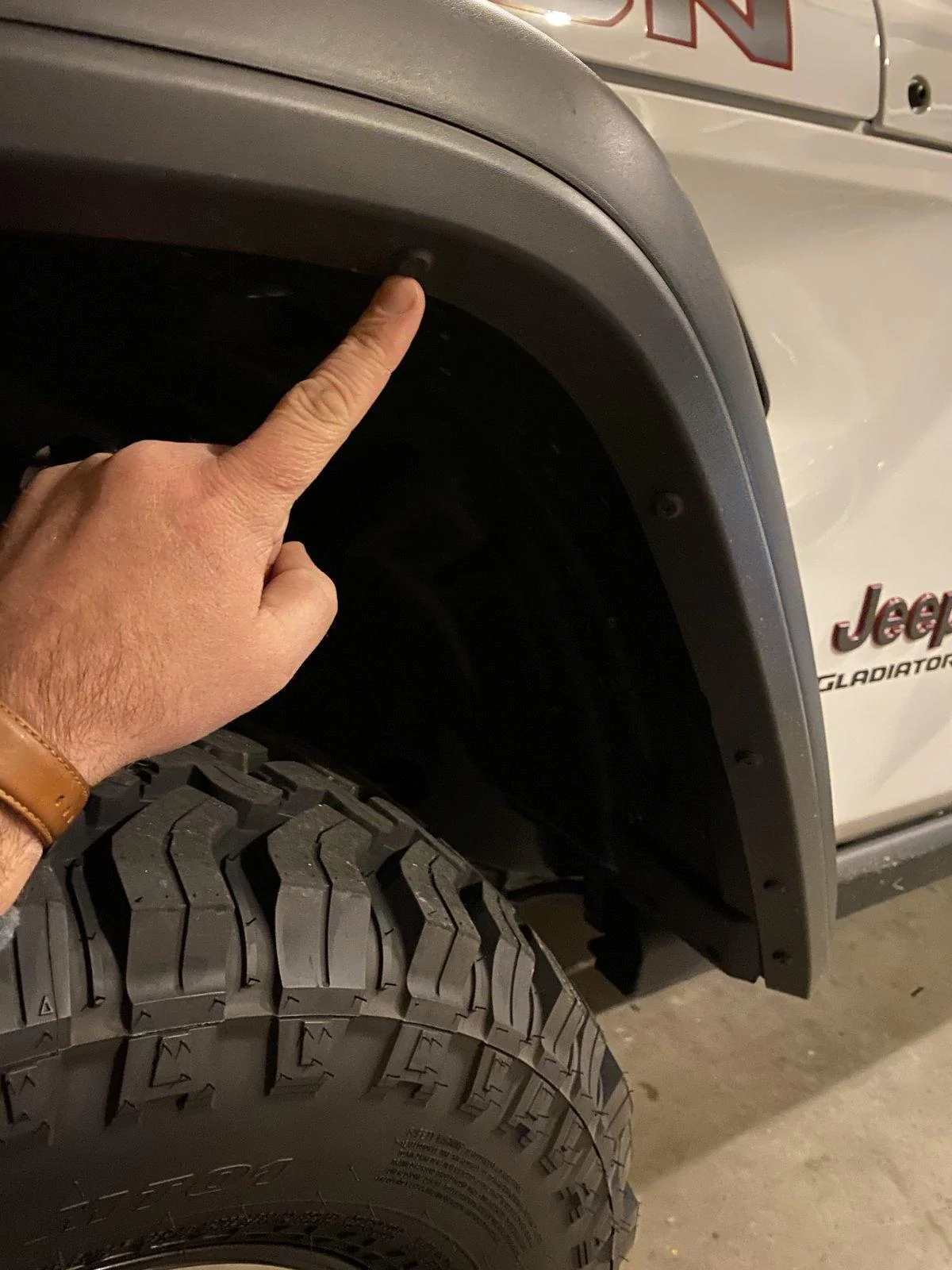

So I expected the headlights to be the hardest but not gonna lie the fenders were the hardest. That being said I’m in no way a mechanic. I did it just fine with some patients and taking my time....I used two videos that helped a lot...I’ll post them below. But here’s what i found. All rivets can be reused with the exception of the outermost on the fender(the ones that have the pin in the middle of the head). It is possible to do the install not removing any of the non reusable ones but it’s easier to remove the outer front rivet that holds in the bulky plastic bracket that goes behind the signal. If you take all the Christmas tree rivets and bolts out of the under part of the liner you can remove the liner all the way to the last three permanent rivets on the back outside of the fender, One of the videos shows this. The liner will just pull out of the outer fender without needing to remove the permanent rivets. With all fixtures removed back to those back three outer rivets there is plenty of room to see and remove the fixture and plug them into the wire harness. One other thing that helped was to take out one old signal and then once the new one was set into place I took out bolts from the second side while at the same time bolting in the first side. This helped verify I had the bolts correct and the placement correct as well. Basically use the second side to help you install the new one. I lost a lot of time trying to undo the old lights from the harness apparently you have to unlock the red clip then squeeze the bump above the clip. One side just randomly let go and I broke the harness on the old signal to get it off on the second. This didn’t affect how the new harness fit. Both fastened normally. Hope this helps I can pm you my cell phone when you get ready to install. You can shoot me a text if you get stuck. They look really good installed. Don’t settle for Led bulbs. You won’t regret the led fixtures.

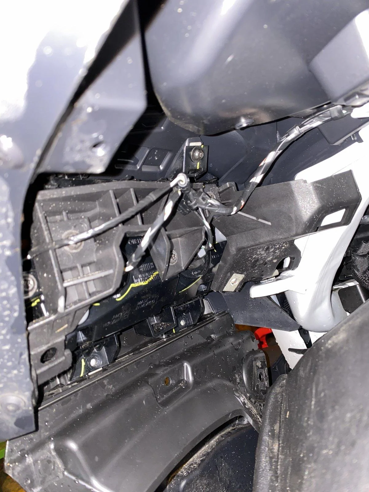

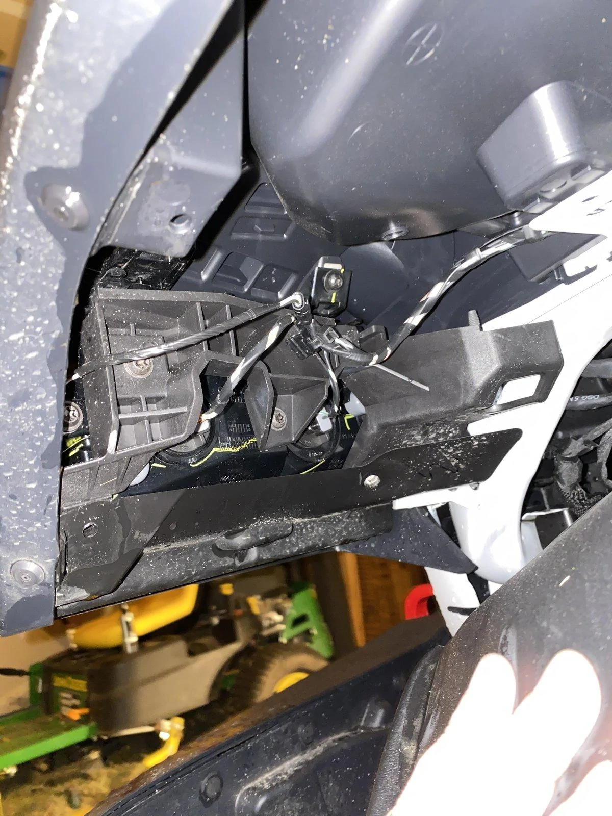

Here are two pictures first one is with the front of the lining removed the second his with the plastic flap unbolted that needs to be flipped down to get to the lower bolts. This is covered in the first video and it’s an important step for easy access

So the first picture shows the one use rivet that I remove but probably didn’t have to you can kind of swing the bracket out of the way but it’s easier if you do remove it. The second picture shows the point I removed the liner back to. YOU DONT REMOVE THE RIVETS TO HERE! The liner will just slide out and it has gaps were these rivets are. Finally the last picture are tools that made life easy but aren’t required...the pry tool and rivet plyers work great and save time. The head lamp makes it easy to have light and not have to worry about moving lights around and blinding you. The hex tool worked nice cause it was short and compact for the tighter area. The only other thing I used was a socket set for bolts.
