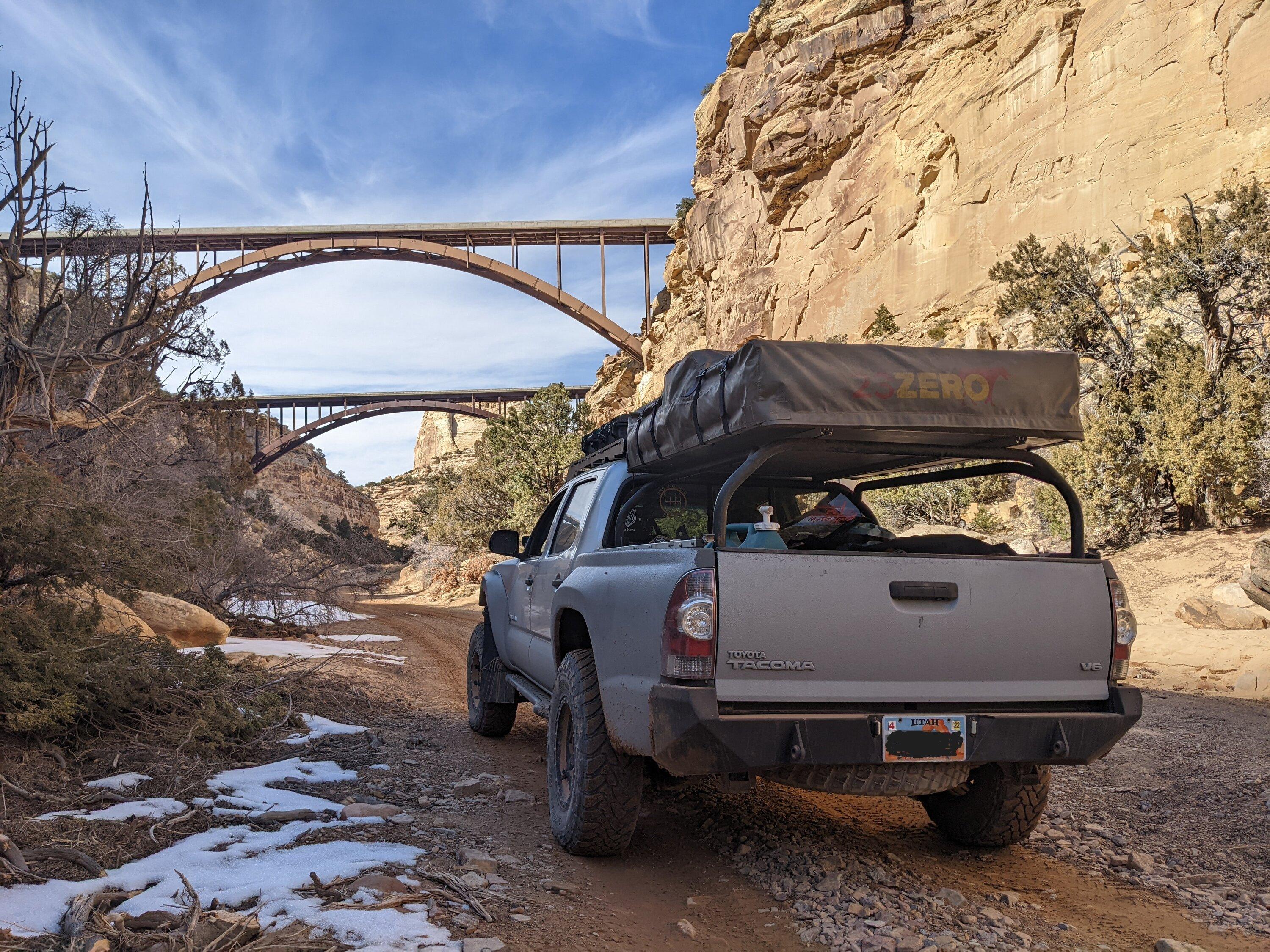

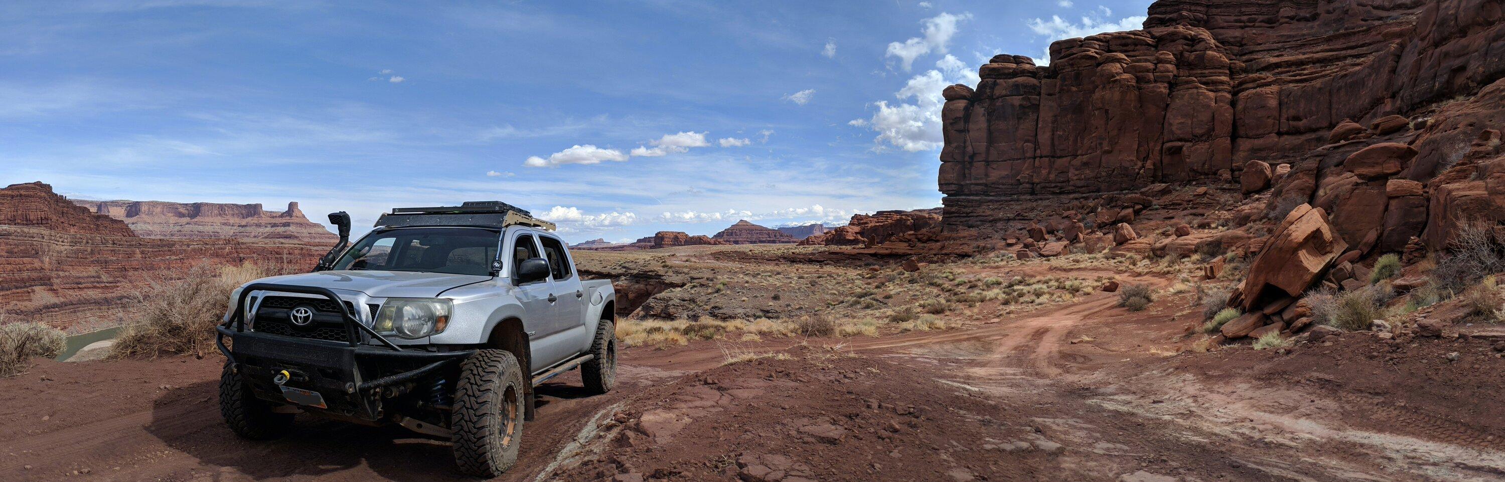

I have been wheeling for years in my 2011 TRD Offroad Tacoma. I built it from the ground up and have been the sole owner.
I plan on selling this to make room for the JT, but here is a list of mods and some pictures of it. I hope the JT lives up to my expectations.
2011 Tacoma TRD Offroad
6-spd manual
e-locker
4:56 gears
+3.5 Long travel Up front (14" travel with 4wd)
255/85/16 (Tall 33's)
Camburg performance 4x4 spindles
DMZ Spring under with 16" tripple bypasses thru the bed (18" travel)
Other Misc Mods.
This is where I am coming from. I know the JT wont have the same amount of travel that I am used to, but I do more crawling/ slow wheeling now vs. the fast high speed desert romping that I did when I lived in SoCal.

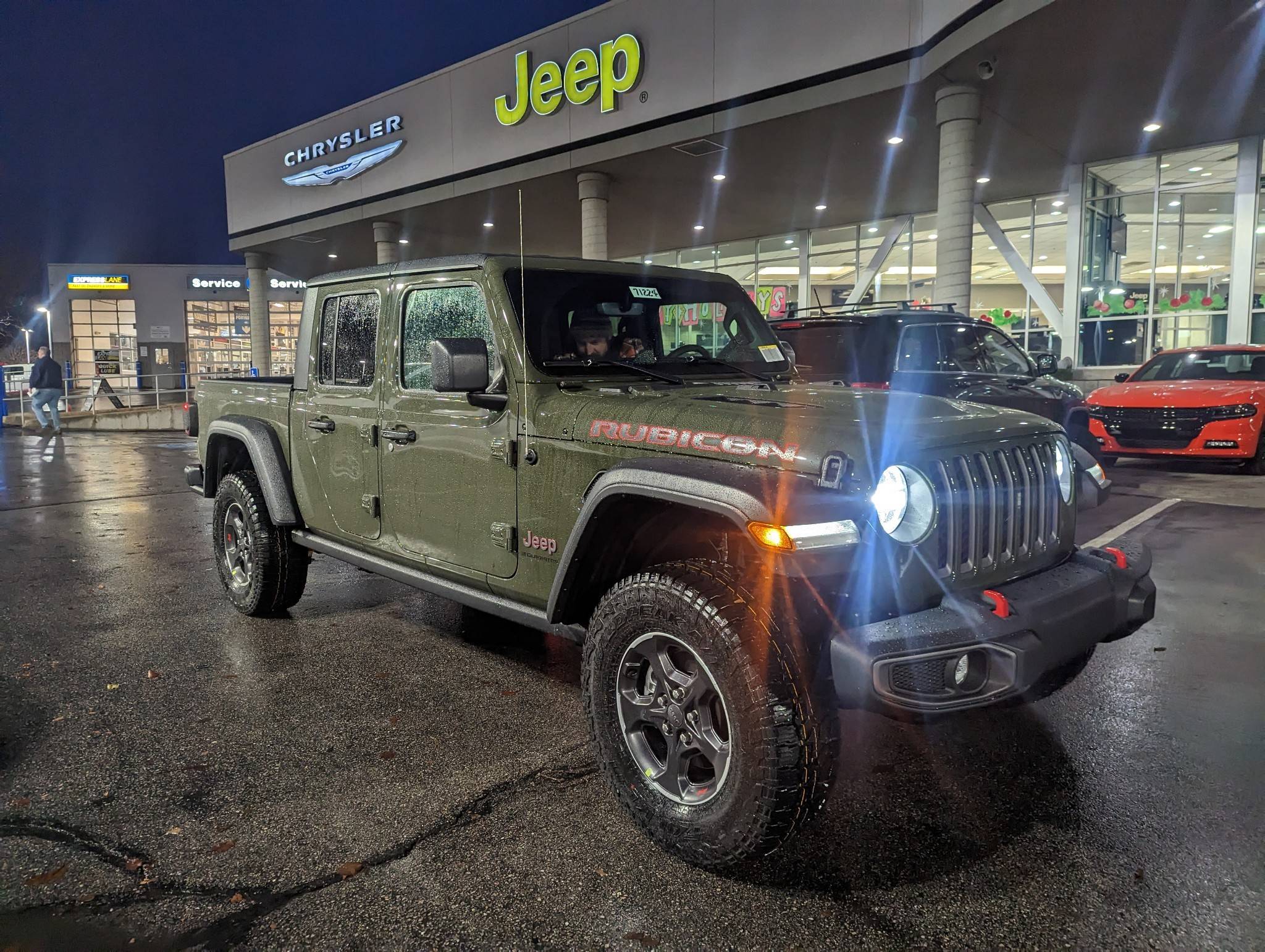

Finally picked up my ride (11/9/2022 order placed and 12/27/2022 pickup). I am excited to continue my off-road adventures in my first Solid Axle Rig.
2023, Rubicon, Sarge Green, saddle tan leather, LED package, aux switches, cold weather, 8-spd Auto.

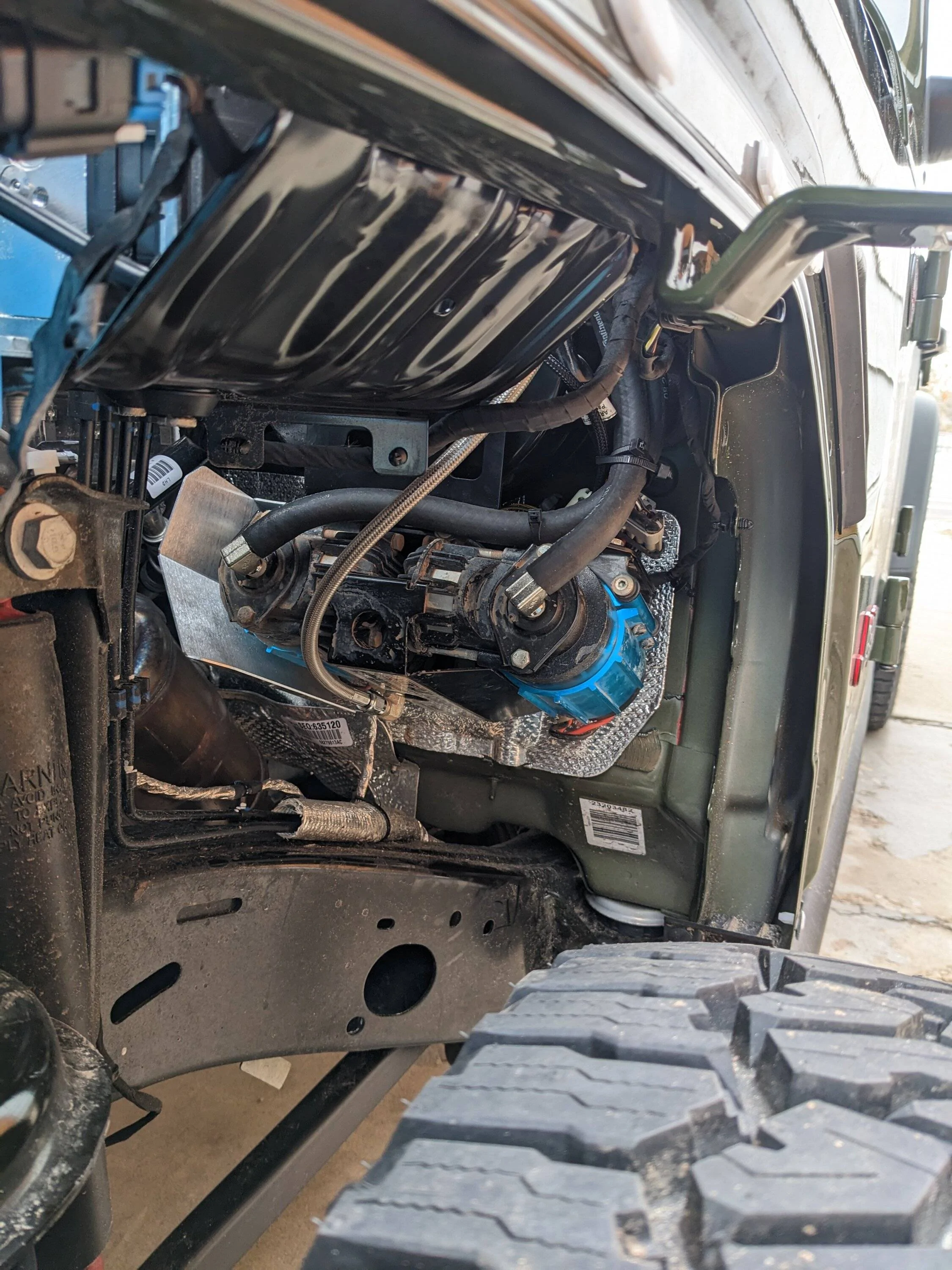

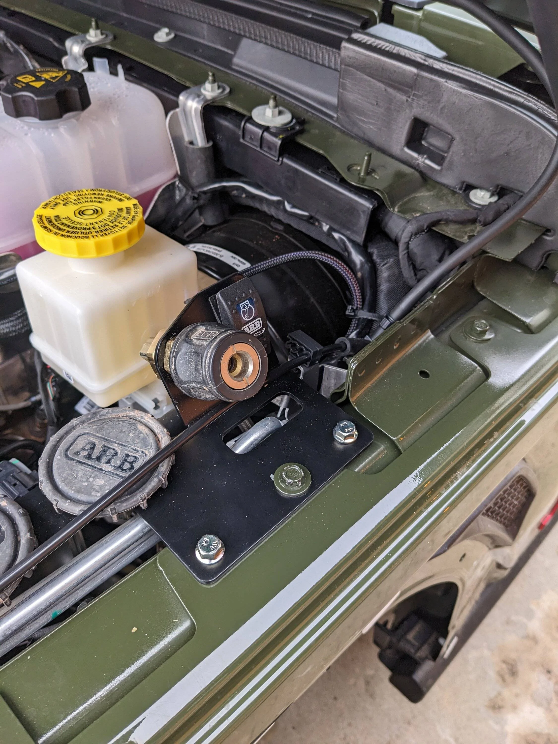

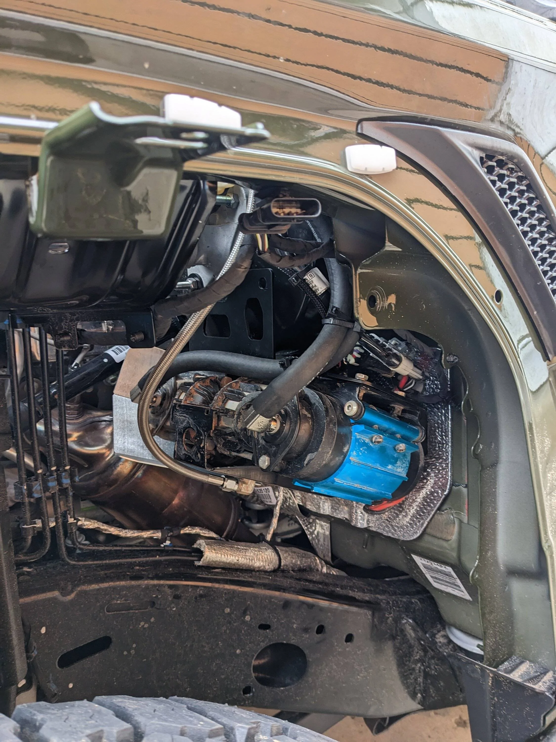

So my first mod will be installing the Grimm off-road ARB dual compressor mount. Airing down is a necessity and I have been using this dual compressor in my Tacoma for the past 5 years.
The hardest part was removing the fender and inner liner. I only managed to break one clip. It looks like the tire will hit the compressor at full lock and full up travel but apparently it doesn't.
I didn't want mount the compressor in the bed or under one of the seats. Due to the 23' rubicons missing the engine cover. The Grimm off-road version is the only mount that would work for me.
The compressor was an easy install, and I took time to route the harness and filter hoses.

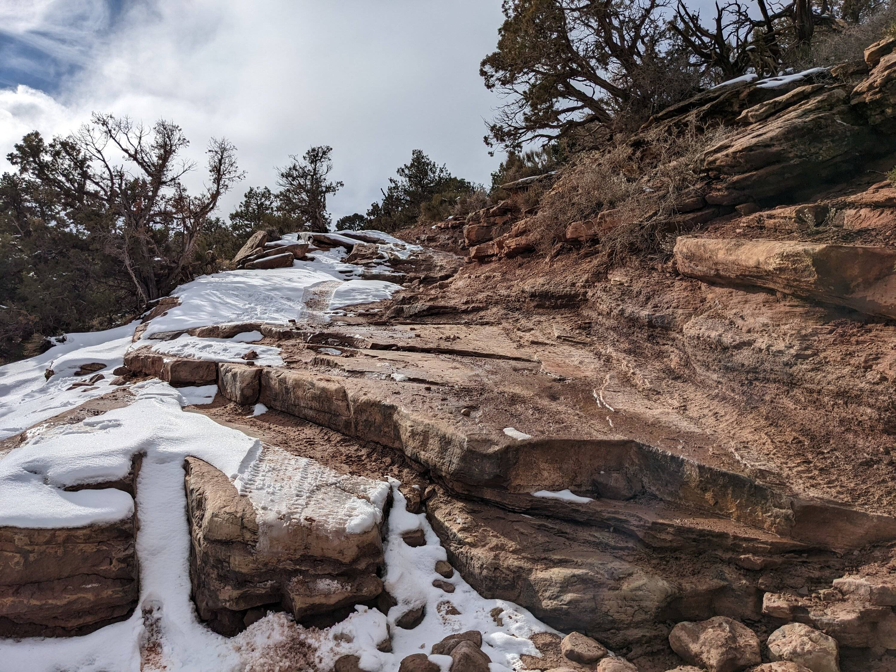

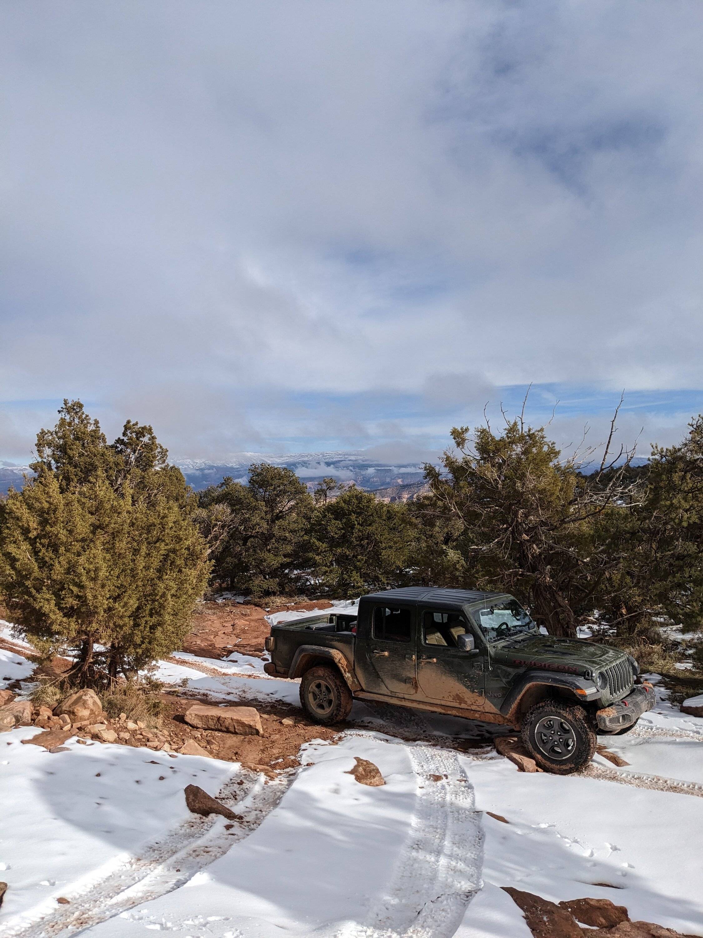

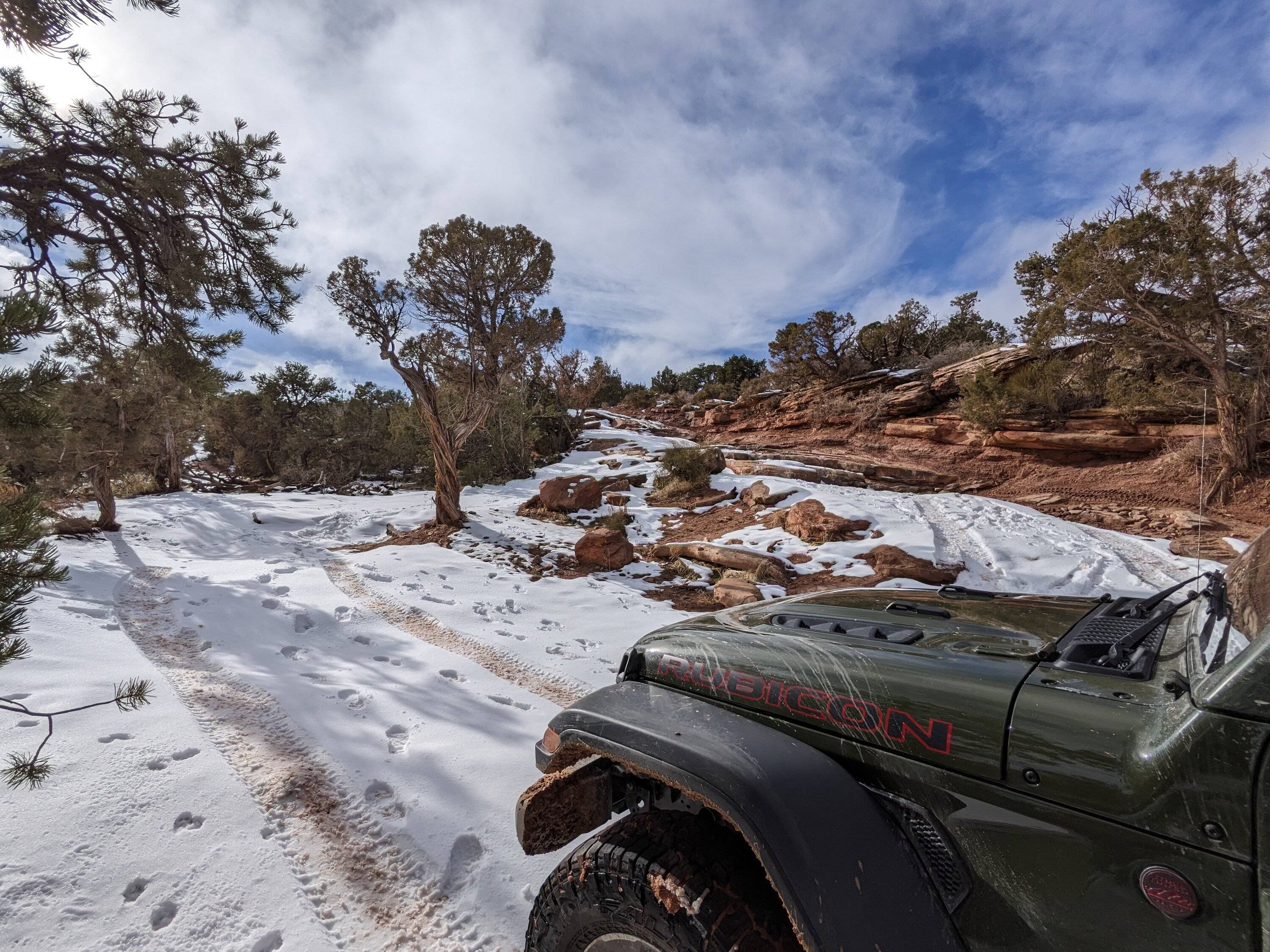

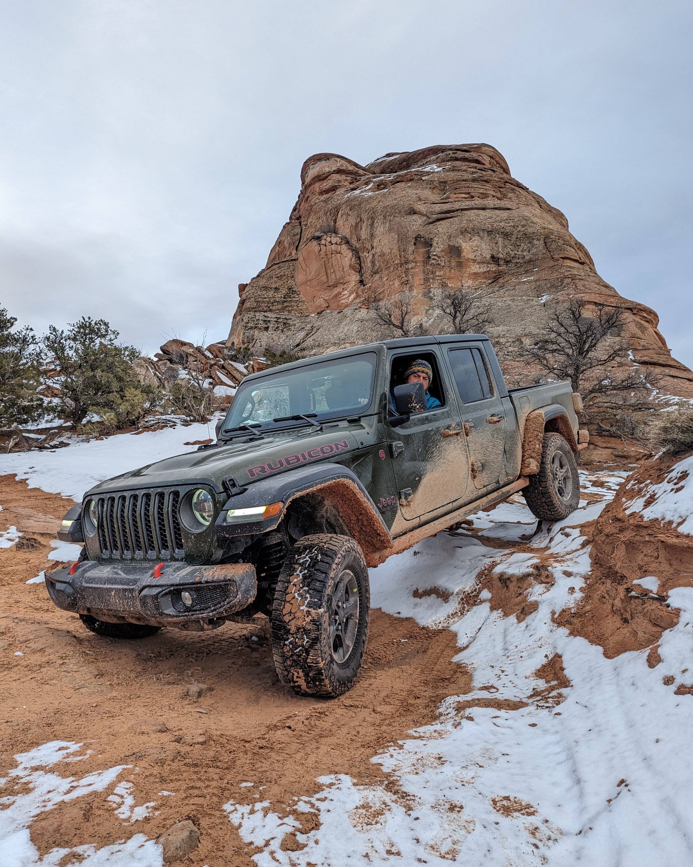

Went to Moab last weekend. And put about 200mi of off-road driving. Went and did eye of the whale and tower arch. Also attempted top of the world but it was too icy and I wanted to wait until I had my next venture uhmw skids. The trail is more tore up compared to when I did it in 2019. Sometimes it's good to call it when it is just you and the wife and the doggos. It would be a long cold walk back to Moab..
This thing needs mud flaps that actually flap in the wind. I'll probably make some.
Also I wish the auto sway bar connect was adjusted to 30 mph. Cmon, 18mph...
Overall the truck is pretty nimble on the trail. I didn't notice the length when compared to my Tacoma.

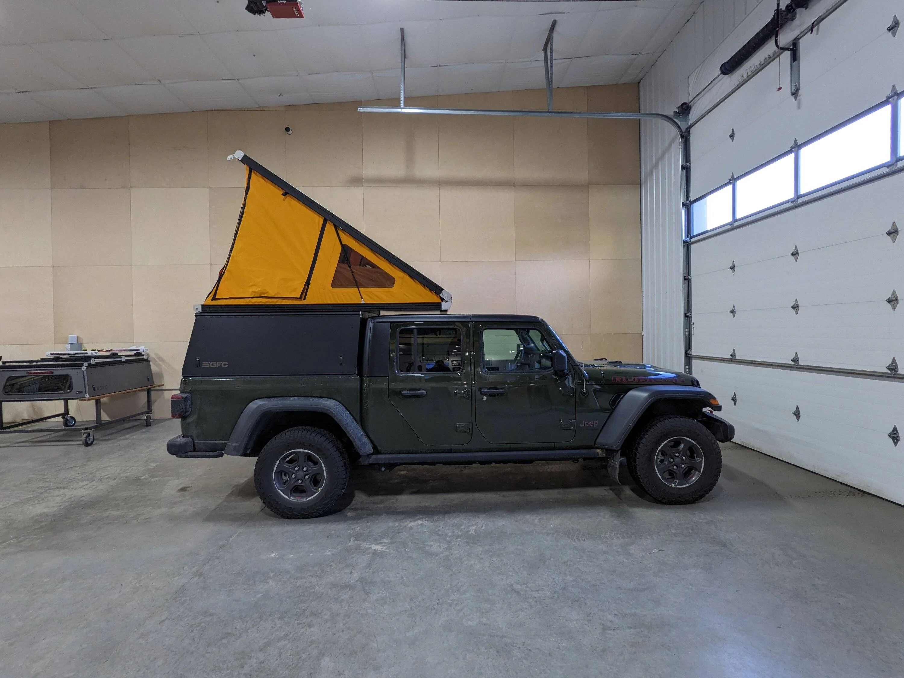

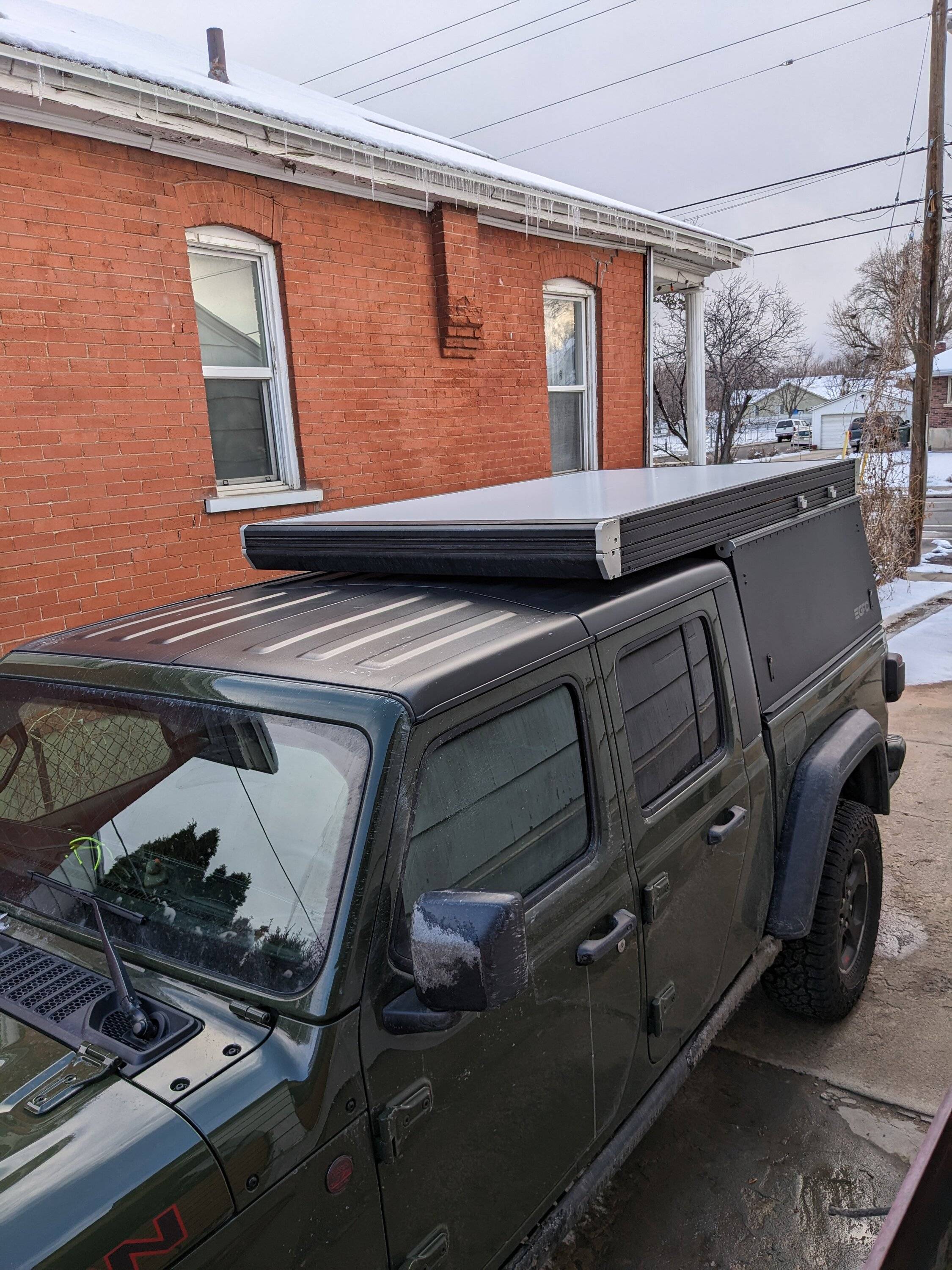

Got our GFC. This thing is awesome. We will use this in the up coming weeks.
I made some mud flaps out of some .09" ABS that I had in the garage and some Butyl Sheet. The mud flaps mount in the same locations as the Rokblokz. My mudflaps however actually flap and will be offroad safe. They work well.
I ordered the Next Venture Full Belly Skid. HD Diff Covers (Front and Rear), and Diff skids. I received the Diff covers and sprayed them with Raptor Liner.
