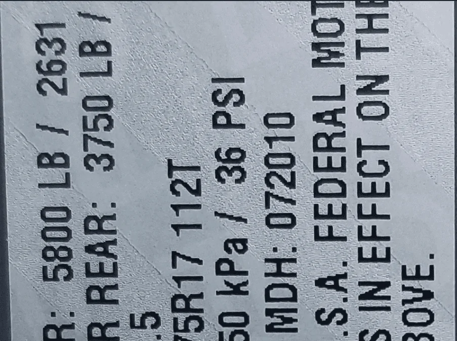

I want to learn if any 2020's were built with the steel steering box.(we have conformation that some 2020's were made with new steel box, now looking for date after 8/14 with of a 2020, basically looking for last day 2020's were built. An inmate here has confirmed the 2021's have the steel box. Another has confirmed his 2020 that was built near midnight on 7/21/2020 is the bad aluminum one. The reason I inquire is I'm hot to buy but can wait til 2021's arrive, the issue is I like gobi and gator so am looking at some 2020's and don't want the drama of the TSB. On door sticker is an MDH #(month, date, hour), on the same sticker is a simple (month-year) if year is 20 post your MDH # if after 072123(7/21/ 23rd hour) and let me know if your steering box is aluminum(silver) or steel(black). It's easily viewed by lifting the inner fender liner on front driver side kinda in front of wheel). Help a brother out.

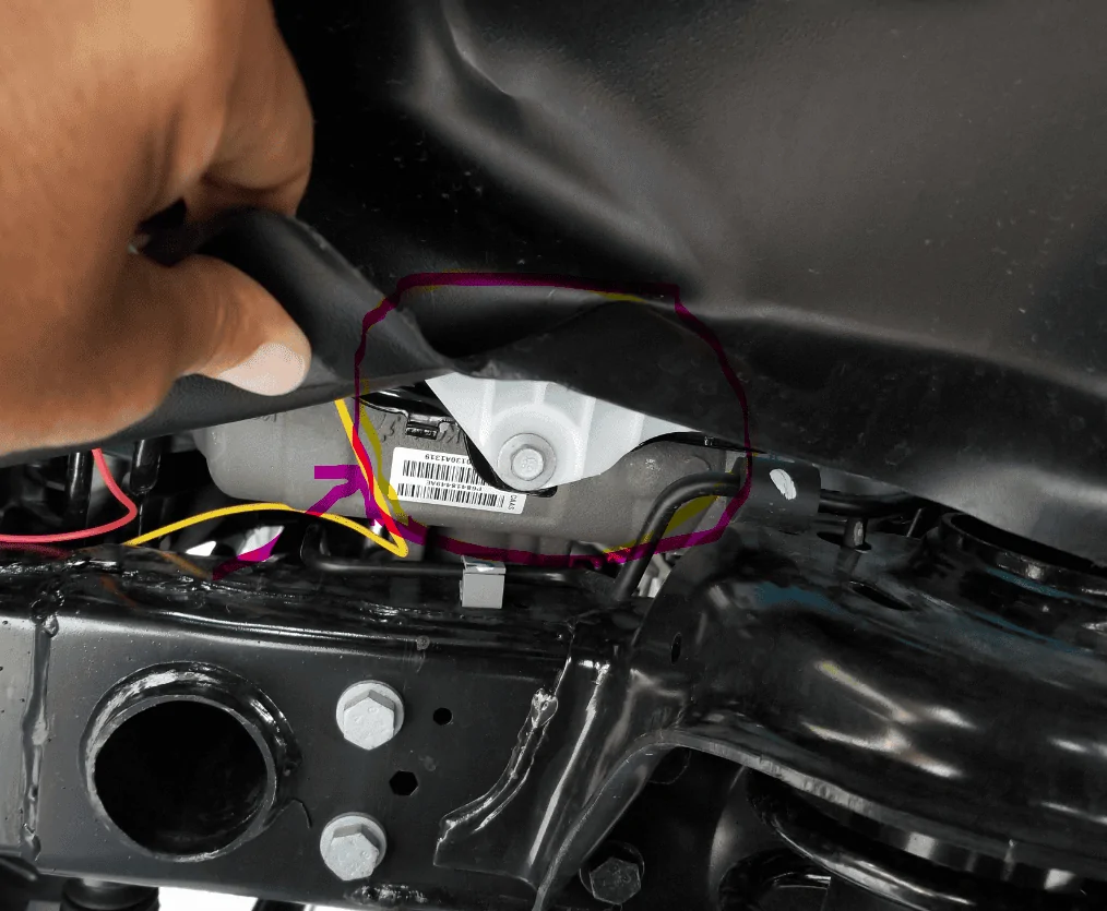

Not sure if this helps (is that silver piece what you're talking about?) :
Jeep Gladiator Confirmed: SOME 2020 JT's built on 8/14 (2020) and after got the Steel Steering box Annotation (8)
That's what I'm looking. Yours was built on 7/20 and has aluminum steering box. So again if your JT was built on or after 7/22/2020 look and see if box is black or aluminum. Thanks folks.
Sometimes folks have to take a closer look in better light. In my not well lit garage mine looked "dark" but in the light of outdoors it was definitely aluminum.
Yours is very very obvious, no mistake about it. But any that are dirty or have any overspray from undercoating if they opted for that (I always do - after having multiple truck frames and other parts rust after only 6 or 7 years in Iowa winters) they may look black.
The NEW box is a semi-gloss finish - absolutely black - folks can look back at some great photos in this thread that show it clearly.
If all else fails, look at the PART NUMBER.
Again, my bet is that nothing made up through the first week or so of August will have the new steering gear. Will be interesting to find the cut-off, though.
