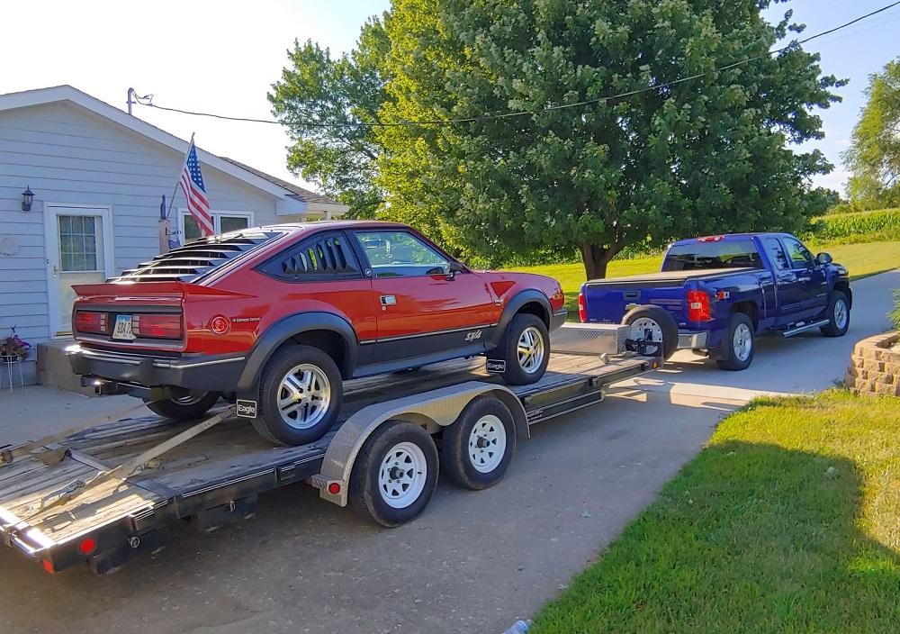

I currently own a 2011 Silverado 1500 extended cab LTZ with Z71 and the 5.3 liter LS engine. It tows my car hauler fine.
I used to own a 95 Ford F250 4x4 with the 351 and it struggled badly to keep up 65 mph on I 80 in eastern Iowa - even OTR truckers have some problems there. The Chevy does ok - it shifts down a whole lot to do it, but that LS tach doesn't even have a redline on it and goes to 6,000 RPM. The Ford - I could floor it and it didn't keep up real well.
My trailer is a 22' car hauler - about 2,000 pounds empty, double axle, full brakes.
The cars I haul are about 3,000 to 3,100 pounds, the little 4x4 Eagle being short but heavy.
I haul to car shows and so on.
I know that with the trailer at 2,000, the SX4 at about 3,100 and say 300 pounds of parts and stuff in the back of the truck, I'm hauling about 5,400 pounds or so, trailer and cargo.

I looked up the specs on my trailer again - oops, I was off. It's a bit heavier empty than I thought.
It's actually: 2350 lbs. / 1068 kg empty and not 2,000.
Not sure where I got the 2,000 - but maybe I had seen the base specs and that stuck in my head. 2,000 is easier to remember than 2350.
But still, 2350 plus 3100 for my heaviest car makes 5450 then if I put any parts or tools in the back, I'm closer to 5700 - still under 6,000 pounds.
My Javelins weigh less than the Eagle SX4. I'm more likely to haul them on the trailer due to the drone of the pipes and other factors.
I rarely have much weight in the truck itself - and going TO a swap meet/car show, I normally have no parts in the truck. Just me, a small cooler, and my duffle of some clothes. (and if I lose 30 pounds.........) So normally it's the trailer and car and not much else, at least going out.
Trailer has 2 3500# axles, electric brakes on both.
I am strongly considering an aluminum trailer anyway - this one is almost over-kill for me.

Ha - I've been towing without a weight distributing hitch. No wonder I drop the back of that truck a bit when I pull the car onto the trailer.
This car is very front heavy so I could have it back a bit further......
