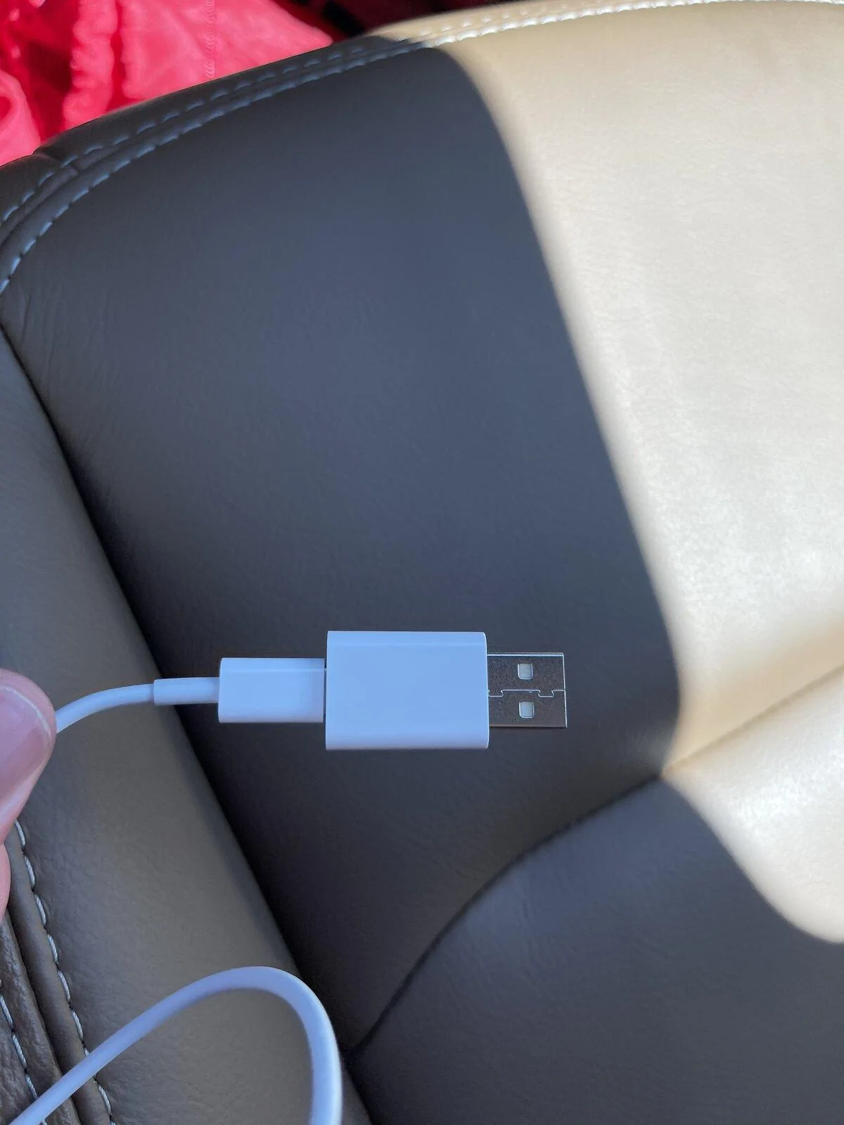

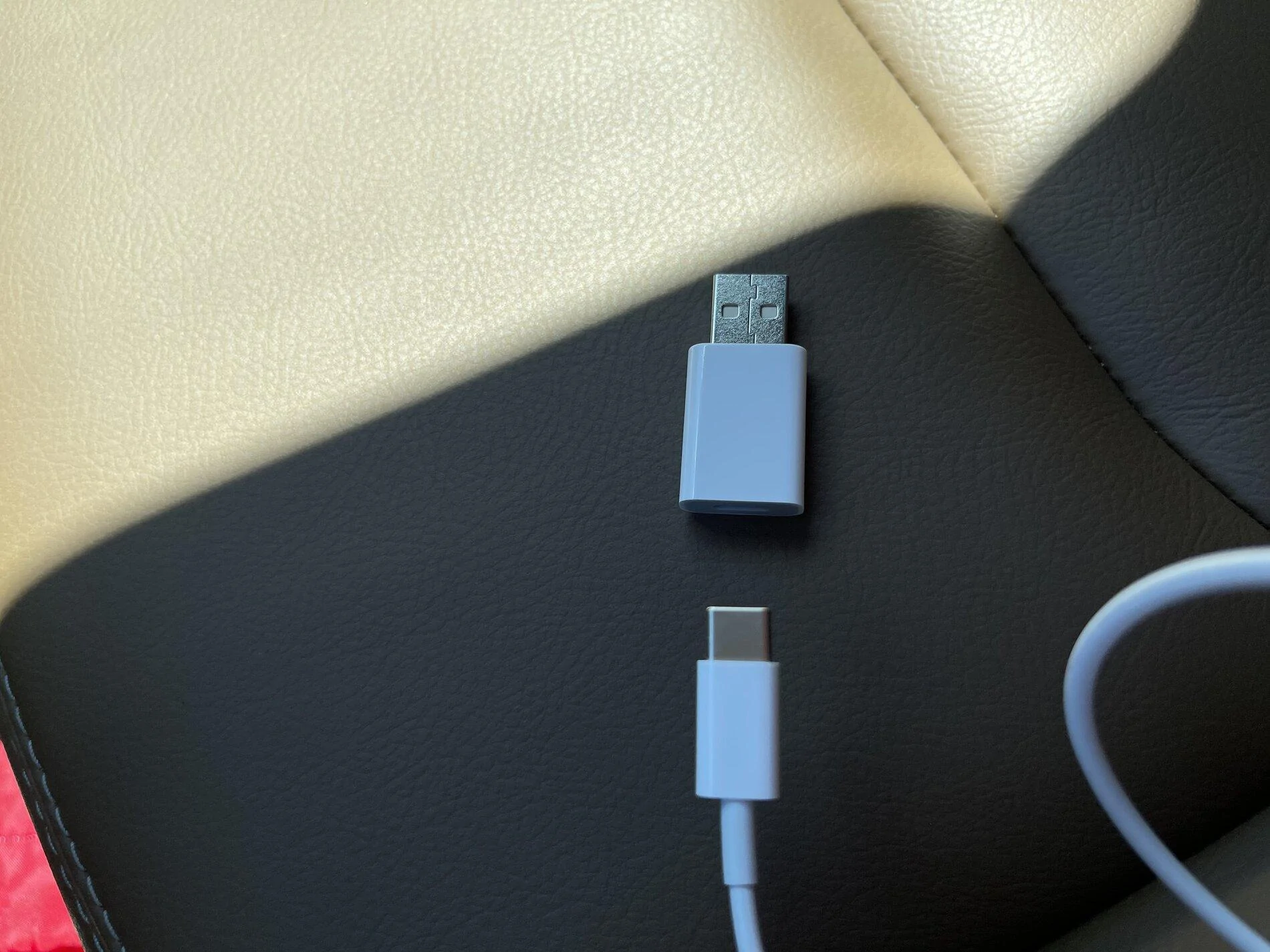

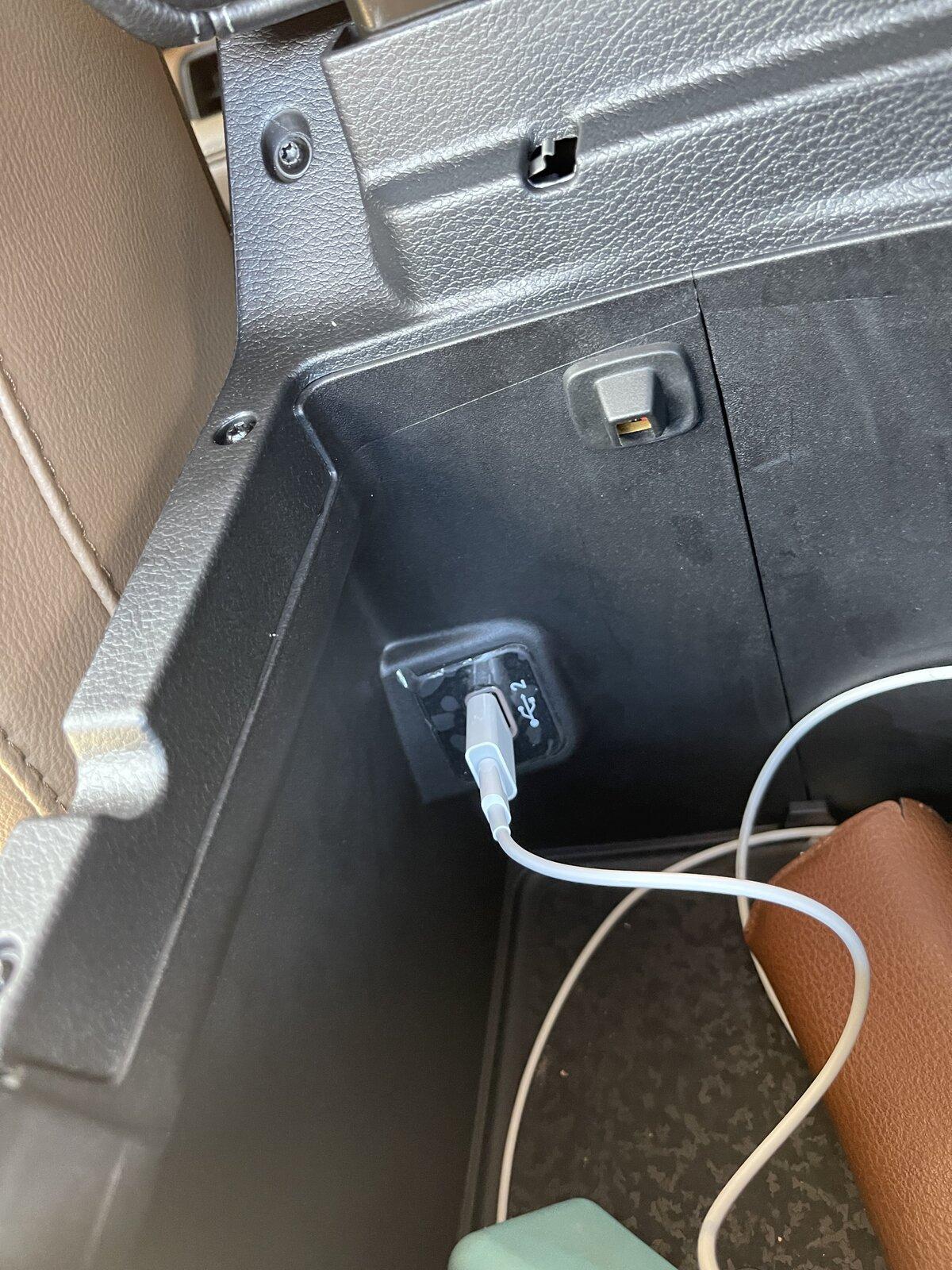

Update 9/3/21:
Issue solved. Using the apple supplied usb-C cord and and an adapter to plug into the console USB port solved the disconnecting issue. Glad to know it wasn’t just my phone having this issue. It wasn’t a Jeep issue. It is an apple iPhone 12 issue in that it likes the usbC cord better for whatever reason.
USB-C Female to USB-A Male... https://www.amazon.com/dp/B08W2SNQM3?ref=ppx_pop_mob_ap_share
