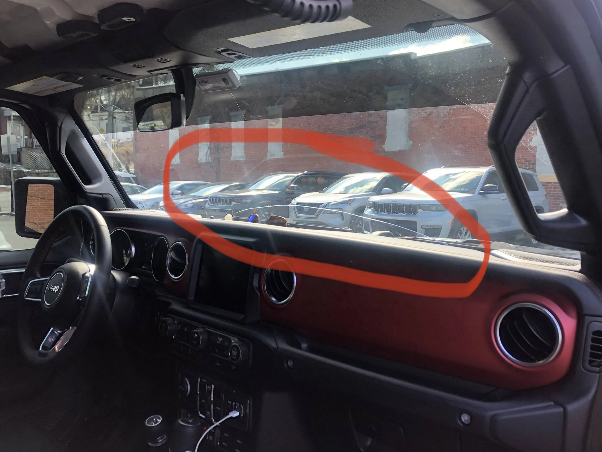

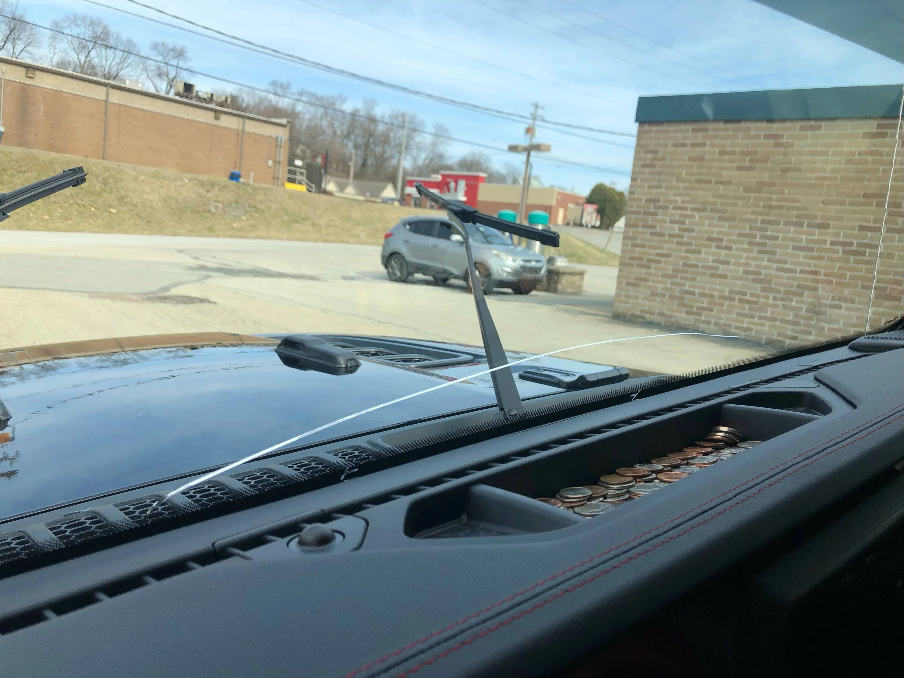

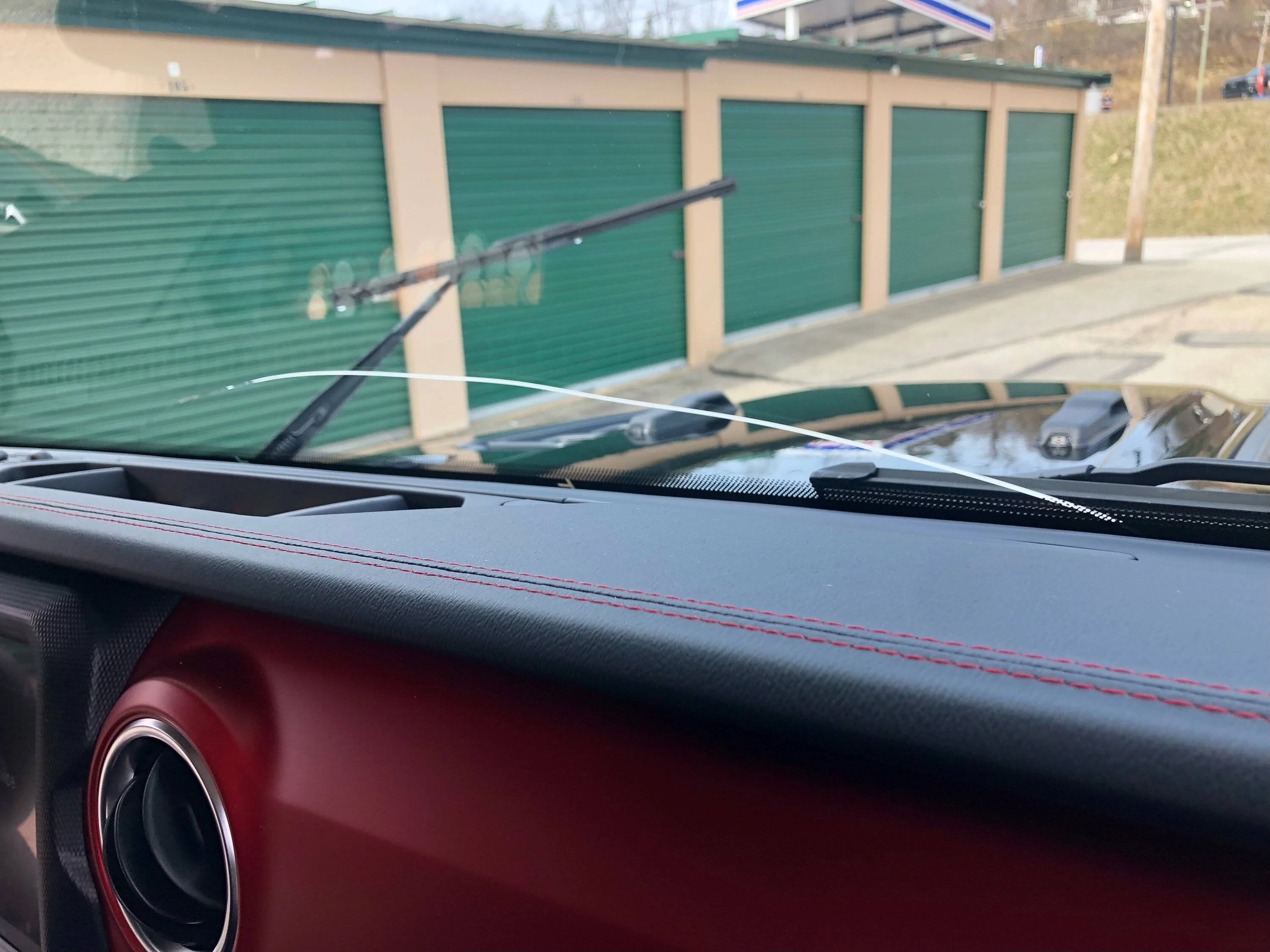

I am attaching photos. The cracks started at the bottom of the windshield under the wipers. Throughout the crack in the "rainbow" there is no damage suggesting a rock or debris striking the glass.

The automatic temperature will runs it's course during remote start operation until you hit the start button. Unfortunately, it won't run your preset setting and no selectable options to change it either.
Yeah I think that is what Jeep needs to change so it's no blasting the the hottest setting.

Sorry this happened... I believe this is a design flaw that Jeep should definitely address. Based on the posts I've seen about this on here and in a couple of different Gladiator groups on Facebook, it happens a LOT - and the crack almost always starts over on the passenger side of the windshield near the corner of the glass and travels back toward the driver's side. I'm guessing yours did this too... though I don't recall seeing the crack go quite as far as yours did.
I park outside - and I know I've remote-started mine when several times when the windshield was frosted over this winter (I'm in SC, so we don't get a lot of really cold/freezing weather) - and every time, when I get out to it, that spot on the passenger side is significantly more clear than the rest of the windshield - so either the air coming out at that spot is hotter (closer to the heater core?) - or the volume of hot air is higher/more forceful there for whatever reason. I believe the glass being heated up unevenly like that is what's causing it to crack. Well... that - and maybe the glass is too thin. I wonder if some sort of deflector to redirect or block the air in that area away from the windshield would prevent that from happening? I guess you could just put tape or something on the dash covering the defroster duct in that area as a hack just to see if it helped.
A better fix would be if Jeep would just reprogram the computer to run the system with a 50/50 or 75/25 split of floor heat and defrost when in auto-start mode too instead of it being 100% defrost. I bet that would prevent it as well. A 5-minute re-flash at the dealership would be all that would be required for us to get it.

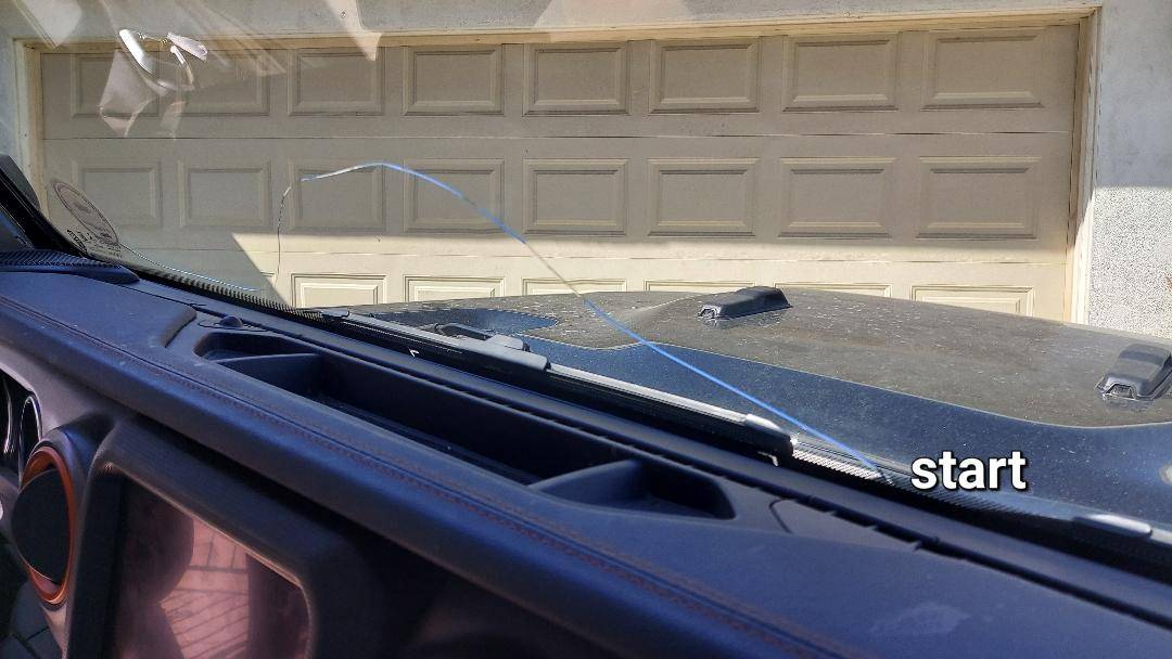

2021 Gladiator, cracked windshield, no impact, same location as many others reported. Is this a body location flex point? affected by defroster?
