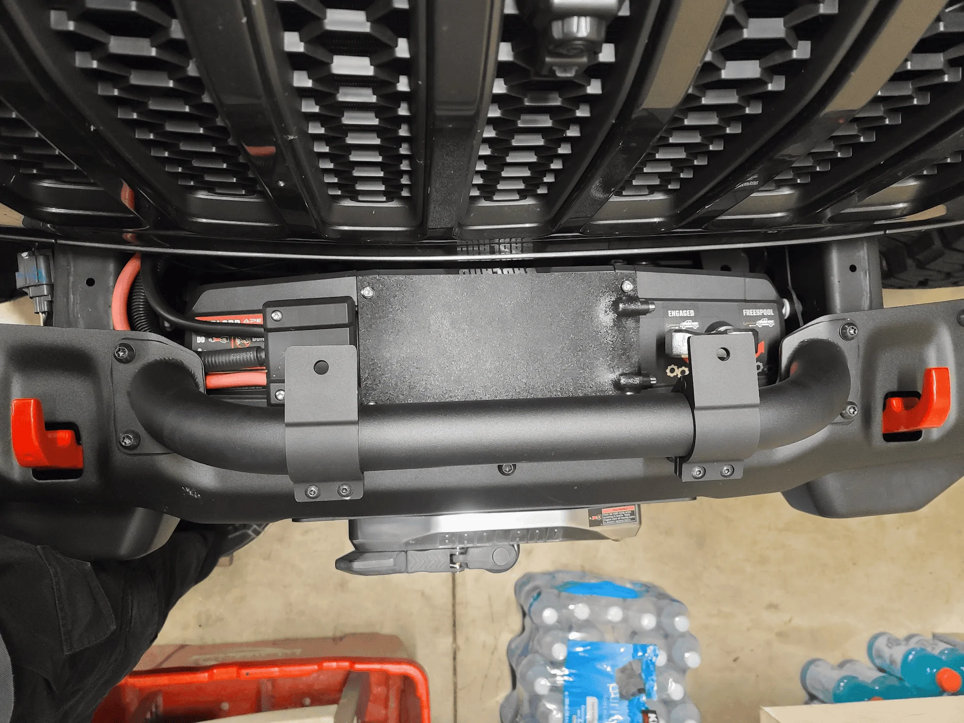

I have my winch (same one as the OP) installed in remote mode, moving the solenoid/electronics into the engine bay. Mine is "sunk" into the bumper and won't allow a normal cover. I ended up cutting some UV-resistant plastic and making a cover for mine by forming it with a heat gun.
Doesn't hold water, and keeps the sun off the rope
Thanks for this pic. This is similar to what I have seen done and IMHO make the most sense as it protects the rope from UV and doesn't allow moisture to stick around.
