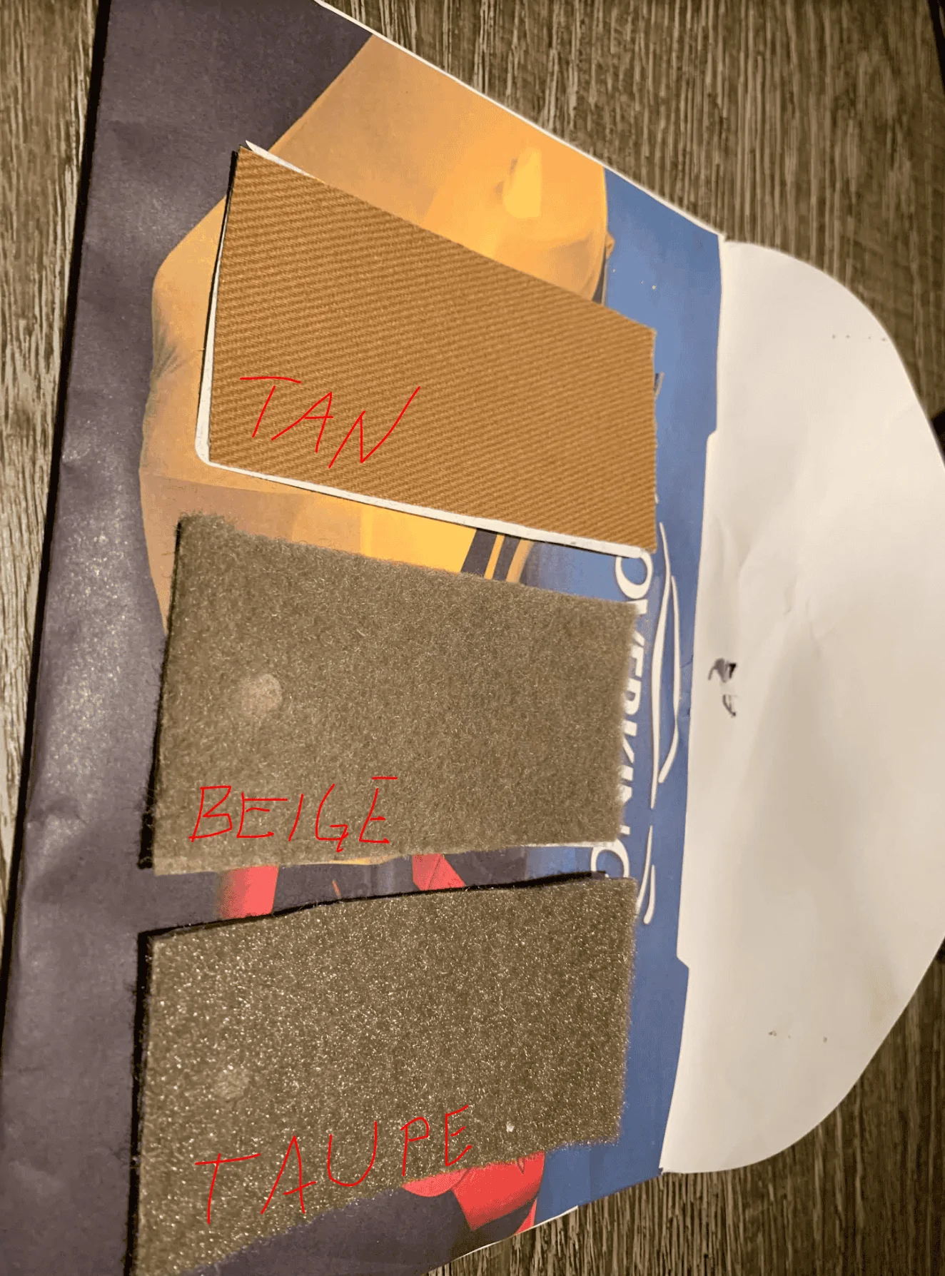

Appreciate all of the details, @staying_tuned; Not a lot on the board from what I've seen considering how nice of a finished look this is. I am thinking about a CK but wanted to try and match the saddle seats. It was pretty hard to get them to send me swatches of this particular product, but in case anyone else is interested:
Update - Super unimpressed with what they finally sent me. Sounds like the finished product is pretty nice, but these swatches seemed to be poor quality. None of the colors really look right for me. I did order an ARE CX Classic with the headliner so I may just wait until it arrives and then try to match that color instead.
Whoa, that is pretty horrible. Thanks for posting these, zero chance I'd trust anything other than black after seeing this. Even the carpeted textured versions of the tan seem like an entirely different structure. That twill looks pretty nice but seems way too thin. The black is very clean cut and sharp, not fuzzy at all if that makes sense. I'll be posting a video, I'll try to show what I mean.
