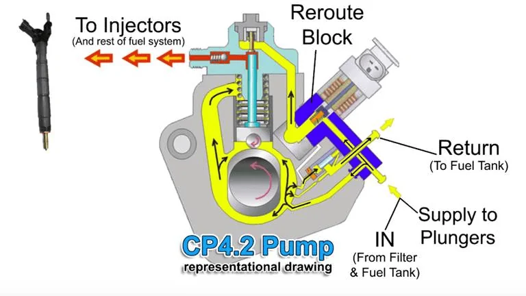

In the video above it is clear why the cp4.2 is an inferior design to the cp3.
The ramp rate on the shaft/cam is radical and the friction is very high. Remember its not lubricated by oil but by diesel. This is why additives are so important. I have been running 2oz of hot shots EDT and I frequently fill with renewable diesel all with hopes to stave off the eventual nuclear destruction of the fuel pump.
The CP3 has a much much much better design with more surface area for wear and higher flow volume. It does not have the metal to metal ramp that causes wear on the cp4. There is no roller bearing either. If the ramp rate was lower on the cam for the fuel pump lifters they could have run a flat lifter with no bearing which is likely how it was designed. At some point Bosch likely needed higher pressure so they added a ramp and then a roller to the lifter to reduce friction. This is speculative.
If we get a CP4 recall will the fix from Bosch be to retrofit to a cp3 or will they simply find a way to pin or hold the cp4 lifters from rotating 90 degrees? In all honesty that would not be a bad fix. Replace the pump with a new one with 2 plastic keepers and a flat spot on pump lifters. Similar to how some v8 engines have a plastic keeper on a lifter to keep it from rotating. Thats all the pumps need to not explode.

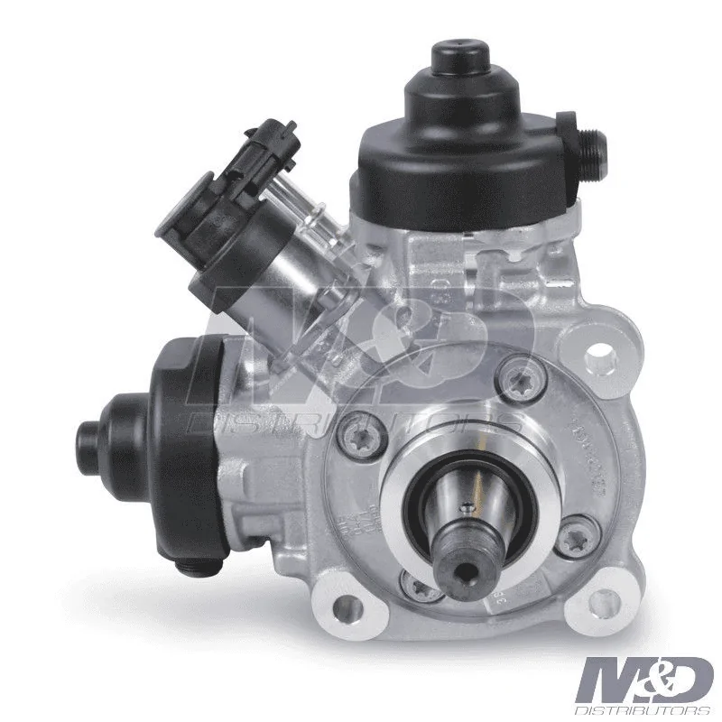

from a ram forum regarding the 4.2:
" 1) The CP4.2 injection pump was installed in all 2019-2020 RAM 6.7s. The original had an asymmetrical cam design for the lifter. The theory of failure is that the aggressive ramp rate of the cam lobe contributes to the lifter turning in the bore, effectively kicking the roller off it's intended path, causing it to grind and send metal shavings through the system. Additive companies claim to aid the prevention of this by increasing the lubricity in the fuel, making it "slippery" so the lifter roller doesn't stick and kick to the side. Around early September, a revision to the pump was released [Pump Identification Link]. It is identified by the large machined dimple in the top right corner. All other small dimples on any of the pumps are nothing but date/mfg coding and do not indicate design differences. The revised pump has a symmetrical cam lobe theorized to lessen the ramp rate of the lifter, reducing the chance of the lifter spinning in the bore. "
Someone take a look at their pump if its 2 dimples its a 4.2?
@californiajeeping
@californiajeeping
Apr 1, 2020
922
933
California
2022 Jeep Gladiator diesel, 1977 cj5 LS swapped
Jeep Gladiator CP4 weak point and why the CP3 is the only solution. 1659641789937
I believe we have a 4.2. There are apparently 2 "revisions" or more of the 4.2 design. No clue how to tell what they changed or how its better but if ram is putting cp3's back in then none of them are any good.
