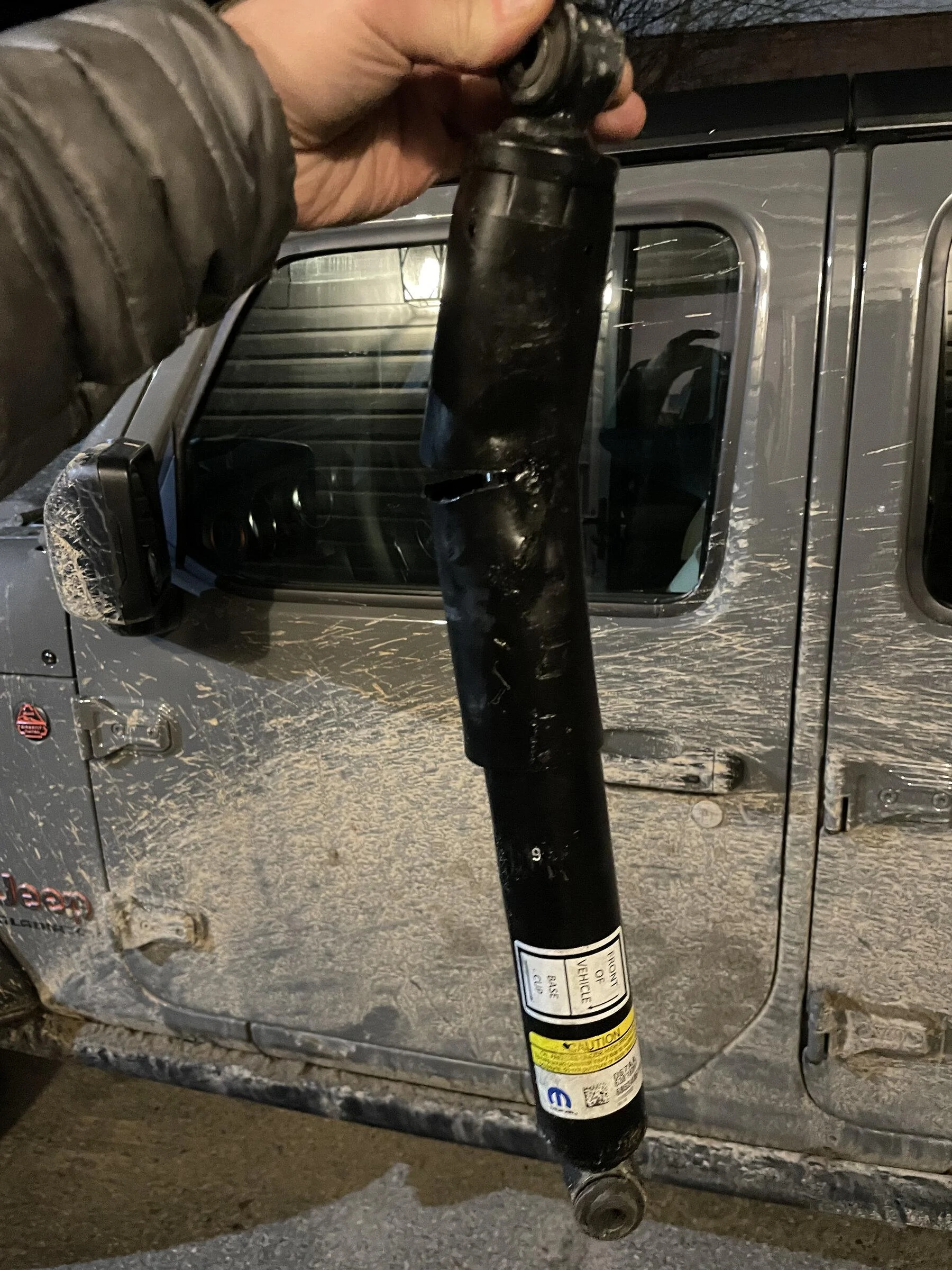

I was on my way back from taking my mother out for a campfire hamburger last night on moderately rough forest roads, in my area there are still sections of these unmaintained roads with ice cover and I managed to find a soft spot while putting along slowly and crunch! Backup up and moved over a bit and crunch again, then couldn't turn left more than a 1/4 turn of the wheel. Had a quick look and the stabilizer was pretty bent! Anyway made it out ok. Got home, took the stabilizer off, turns out the Mojave with only 2000 miles on it drives good without it. I notice some less solid feel on bumps and never went over 50mph today. With availability being an issue I ordered the Falcon Nexus 2.2 adjustable stabilizer to replace the factory stuff. Fun stuff!

I’ve had a few Jeeps that saw some good wheeling but never destroyed a stabilizer quite like this! No other apparent damage thankfully, managed to not contact anything other than this and the control arm mount

time to relocate my friend. did you get the kit to do that with the falcon?
I agree with the relocate. I relocated on my JK's with the OME stabilizer setup. I needed whatever was quality and available quick in my area so I didn't order any relocation parts. This Mojave will only get a 1 inch front spacer and a 3/4 inch rear spacer for lift, up front I figure I lost 1/2 inch with the winch and bumper install. I will look into this and adjust if it works - thanks. 37's might have been better than the 35's also...

Definitely, the JL/JT stabilizer hangs way too low. When I went to my falcon SS, I did a jk version that gets up and away like the fox through shaft models do.

Finally got the Teraflex Nexus 2.2 installed, after a very quick drive I am happy as I can be with it I guess. Feels better than with no stabilizer! As for relocating, not sure if it would work with only a 1 inch lift on a Mojave. Open to any experienced feedback.
