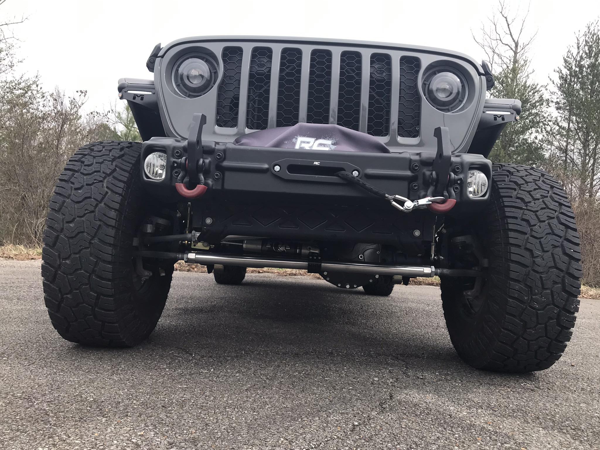

Mine bolts up using the spots on the axle where the original swaybar links bolted up. So if you cut those off I’d say your only option would be to weld some back on.
Jeep Gladiator Currie Antirock After already having JKS Quicker Disconencts 4CECB45B-46DD-4ACF-8C3B-69FBB58419E1
You can see here where mine bolts up.
