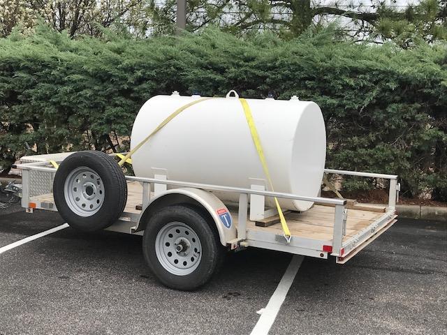

This is why I plan to have additional fuel capacity in my JT of some sort = so you can shop smart for fuel, the prices vary so much.

In-bed fuel tank! :like:
I am really really having a hard time not pulling the trigger on a diesel JL :lipssealed:
That's what I'm planning to buy my wife next year!
Also, Stock Up! Local diesel is $1.91 today. Oil tanked another 18% today, fuel will go down even more.
Is that your trailer and tank?

That is my new tank I bought this week, but I will be mounting it on a small double axle trailer. Just use the aluminum trailer to haul stuff behind the GC because...
No diesel JT yet.
