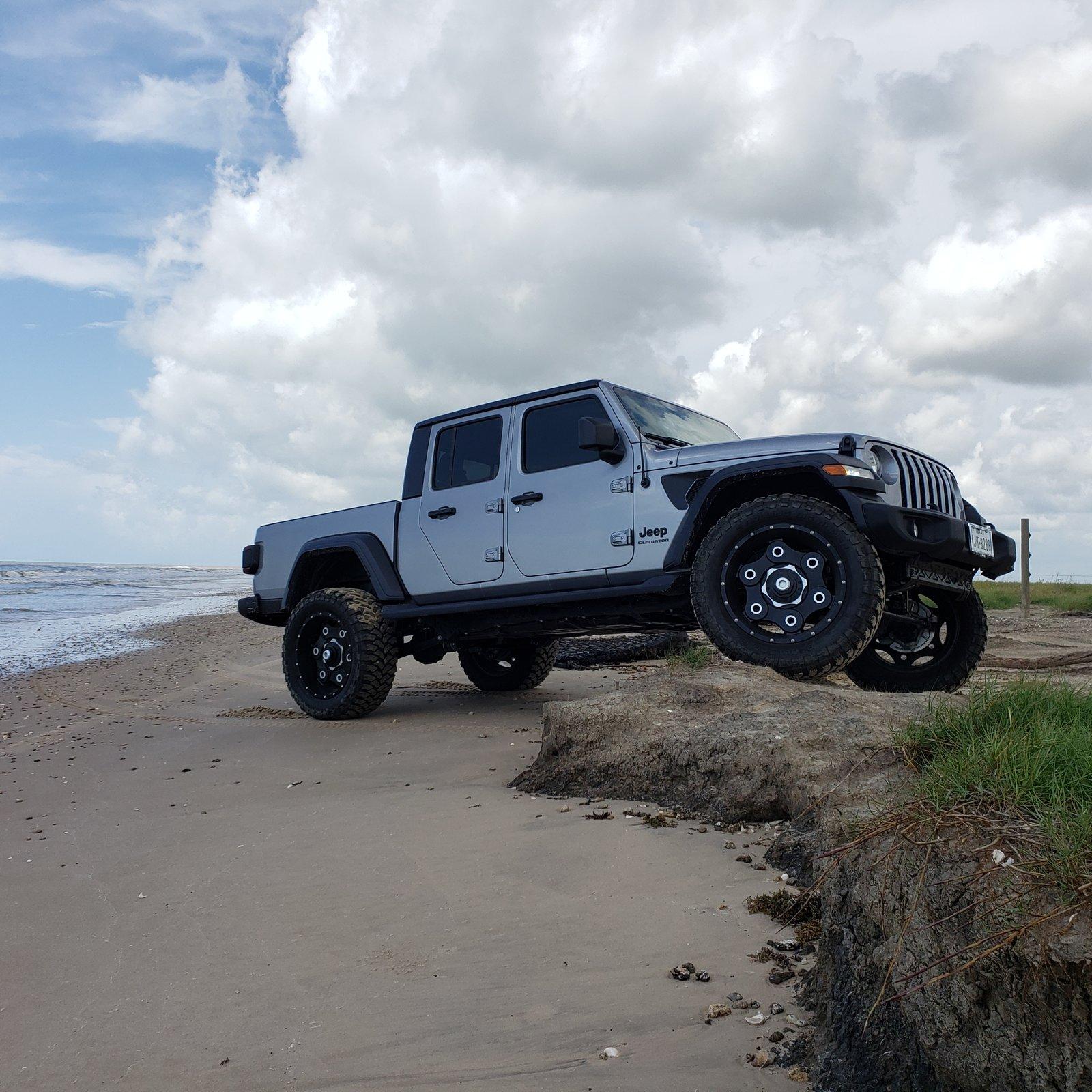

I daily drive with 37's. I have the Sport S with Max Tow and it drives great! I put the lift and tires on at 700 miles so I dont have much of a basis for comparison from stock. I had the same tire/wheel setup on my JK with 373 gears and the difference from that is very noticeable. I dont get much out of 8th gear but at 75mph in 7th I'm at ~2200 rpm. I hear people talk about 20+ mpg and am pretty confused about that...I'm consistently at ~13.5 no matter how I drive.

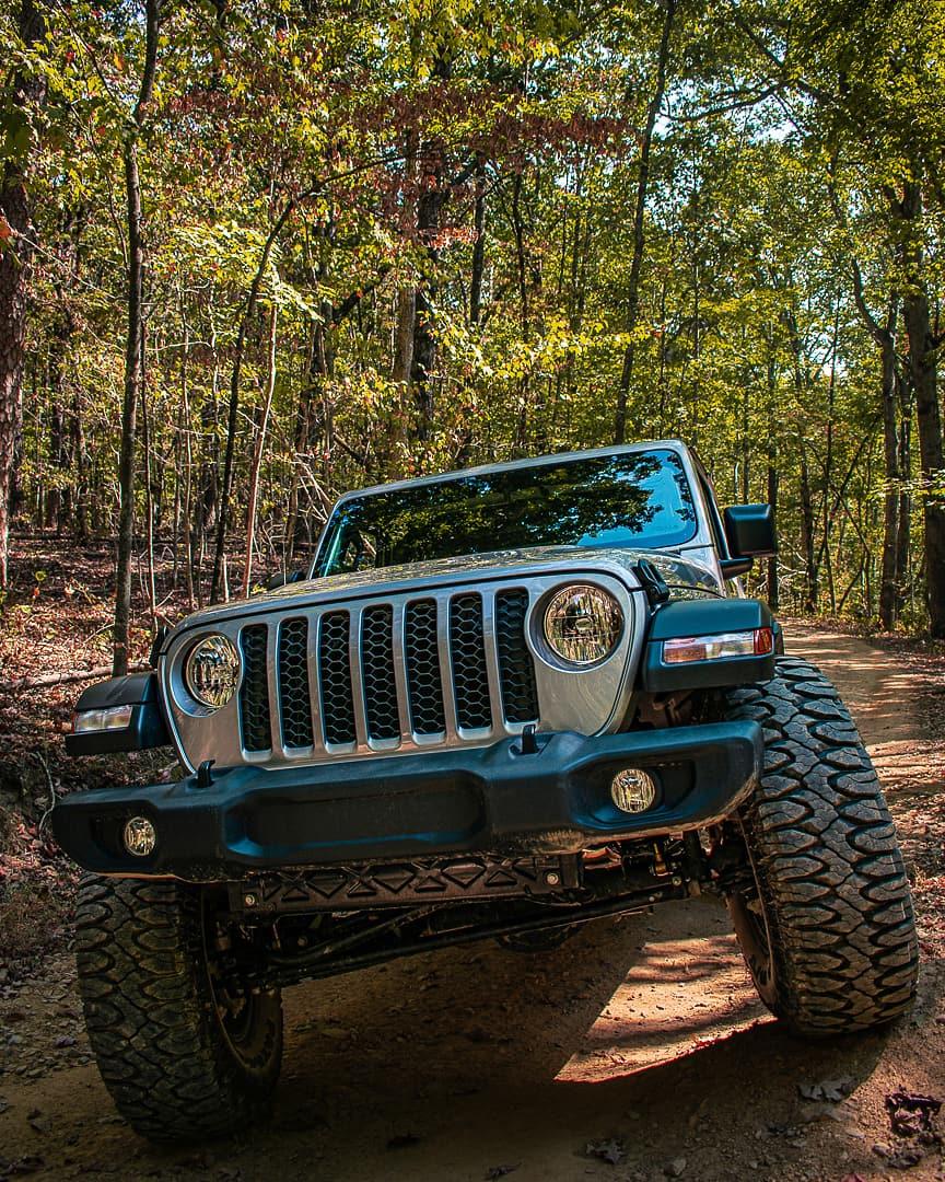

Drove around 4,500 miles stock with Sport S Max Tow. Have had an Evo 2.5" lift and 38" Milestars for the last 1,000 miles.
I've seen 8th gear on flat sections of interstate (~70mph). It has plenty of power and acceleration for daily driving with the 4.10s.
You will lose a bit of peppiness, but it drives far better than my JKU with 35s and 3.73s.
If you're debating 35s and 37s, go with 37s. If you don't, you'll likely be back on the market within a year.
