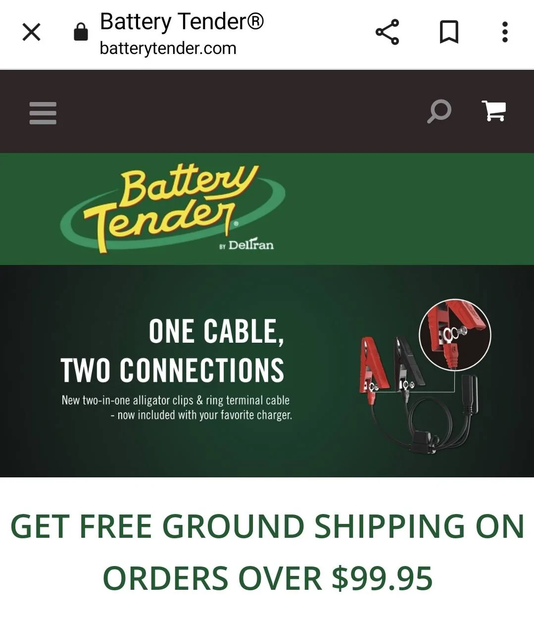

I've had good experience with these products for many years.
Jeep Gladiator Dead Battery after a month of sitting Screenshot_20230927_122623_Chrome
Some of the other companies not. Even highly recommend ones, I've had them flat out "kill" AGM batteries.
My LJ, 4wheelers and boat batteries are connected most of the time. Probably a reason why I've had some Optima batteries last up to 20 years or so.
