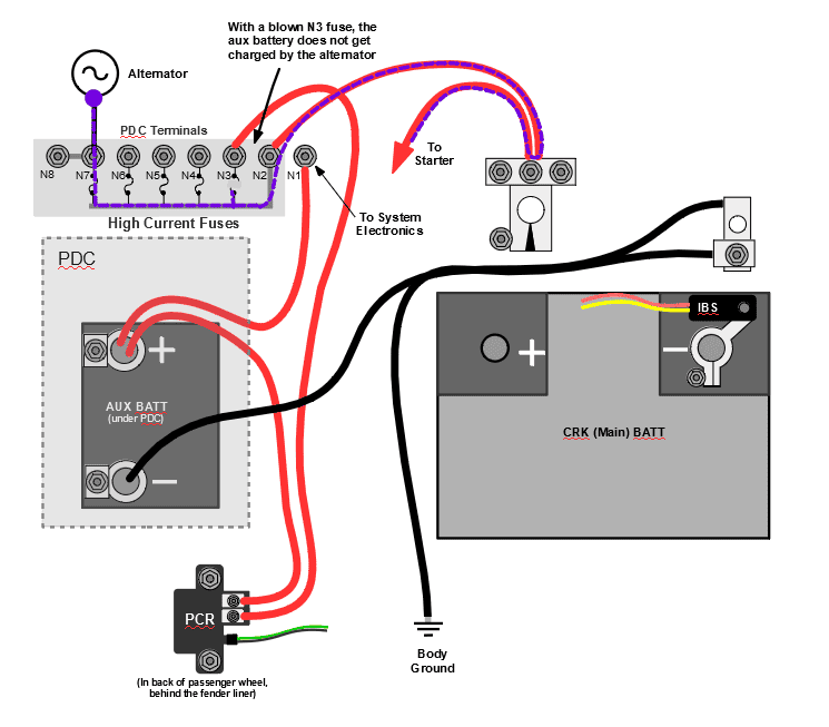

Just tried to start and now it’s completely dead. Nothing. Just like the first time, 2 weeks ago. Back to dealer.
Check the voltage at N3 and compare it to the voltage of the other terminals. If it's lower, it's likely that the ESS fuse at N3 is blown, preventing both the aux battery from charging and preventing main battery power from getting to the system electronics.
If this is the case, you should be able to move the cable from N3 to N4 as a temporary fix until the fuse array can be replaced.
