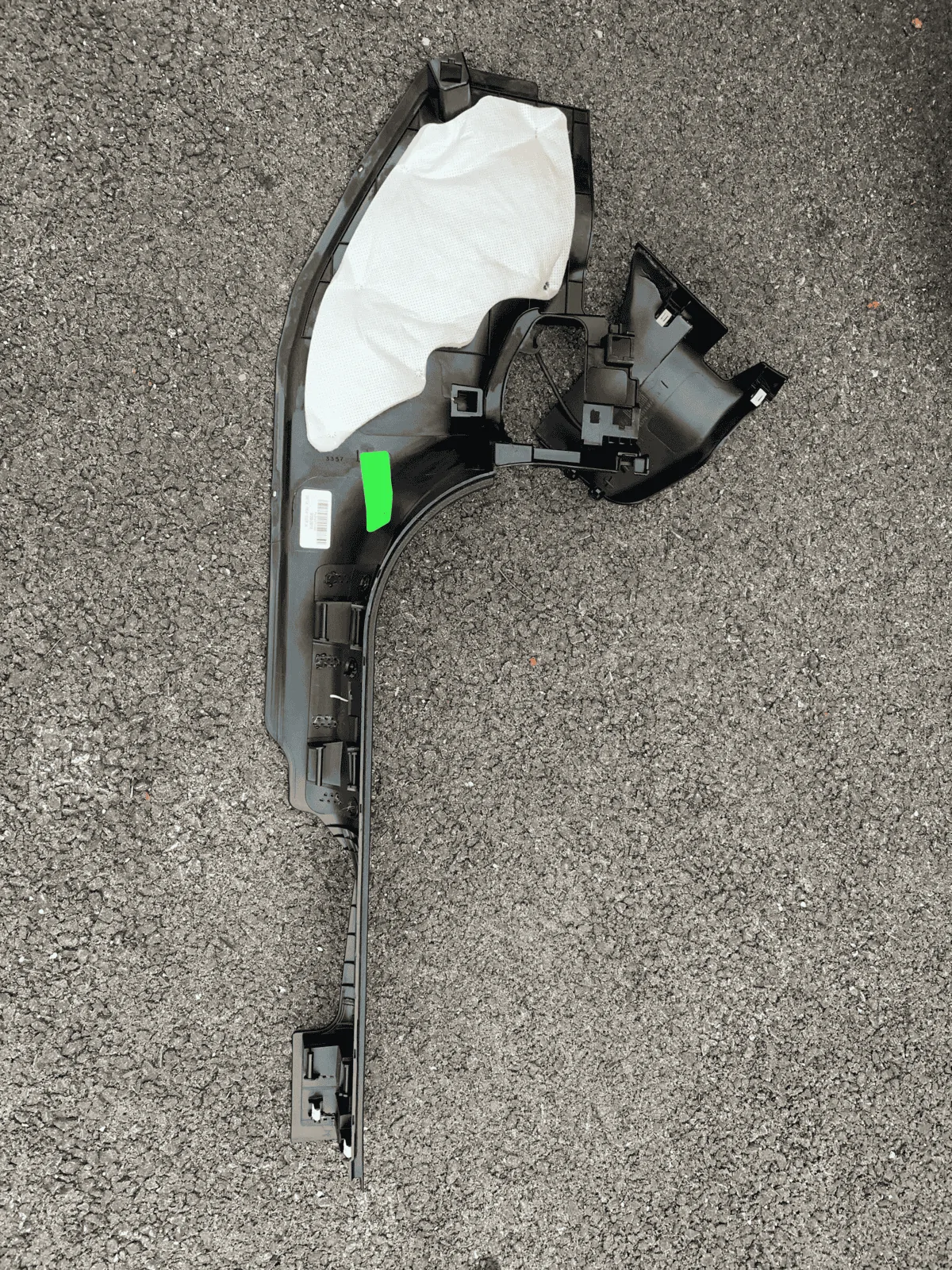

So basically, you need to remove this plastic paneling to the left of the pedals on the floor on the driver side to the left:
It has one screw at the front near the door connectivity and then there are a couple of plastic pins that you need to get past.

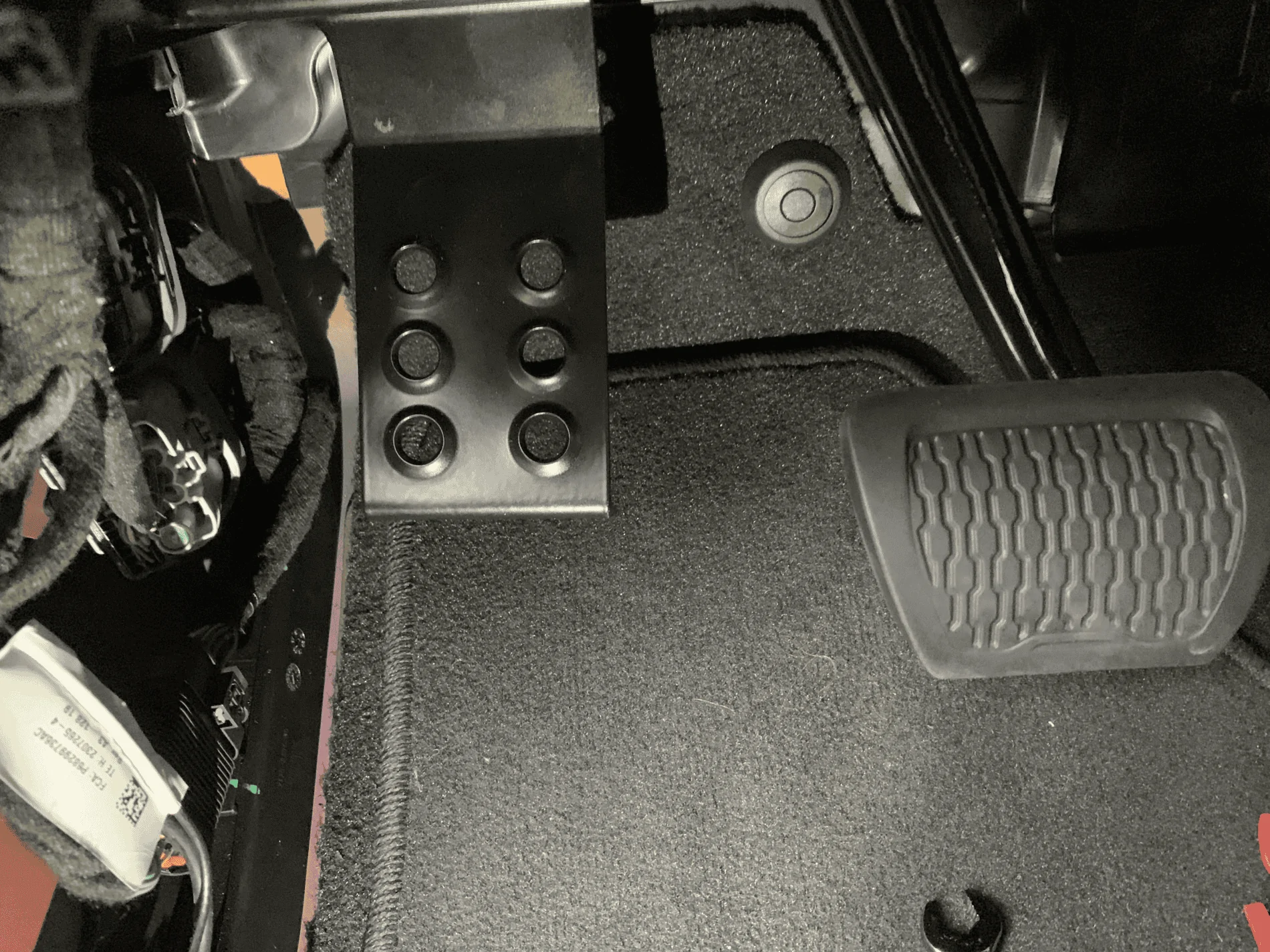

Once, you do that you have enough room to install this:

I stuffed a rag behind the plastic panel to keep the nuts/washers from falling down there. Saved me a couple times with getting the rear nut/washer started on the bolt, since my fingers just didn't want to bend the way they needed to! Definitely way more difficult than it should be, but my left foot thanks me everytime I drive :like:.
