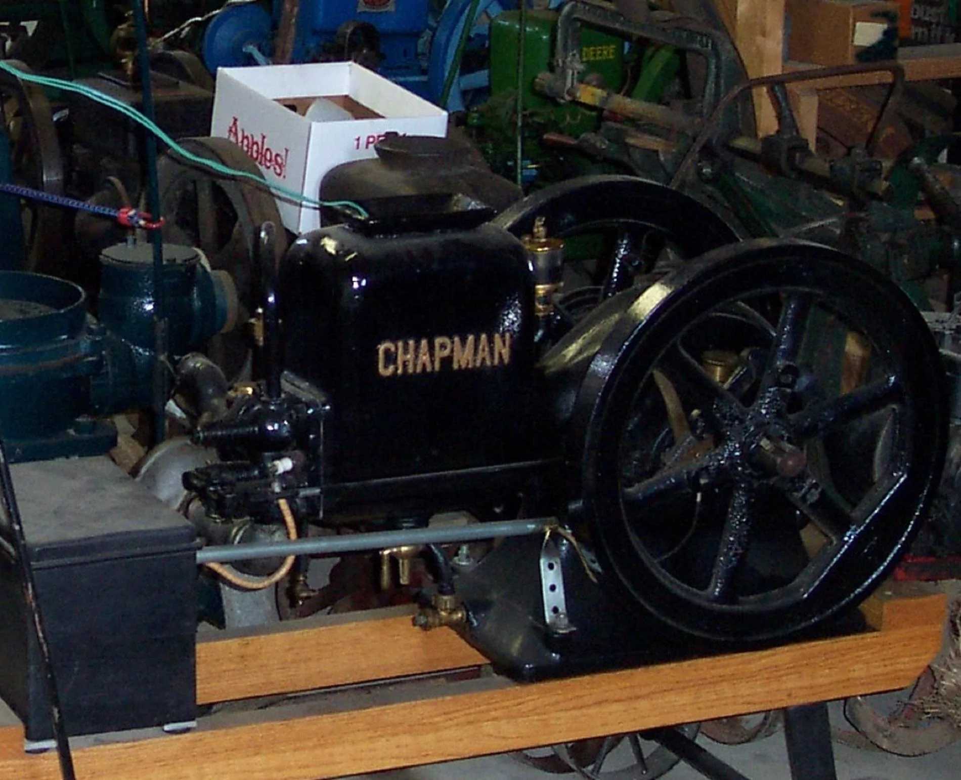

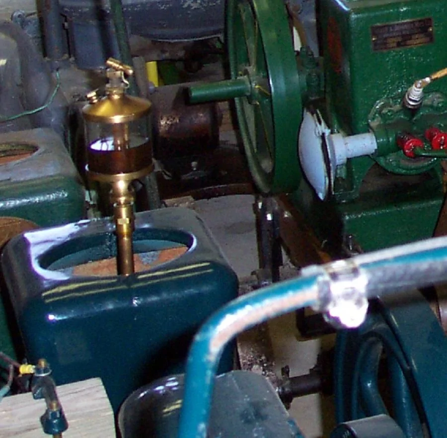

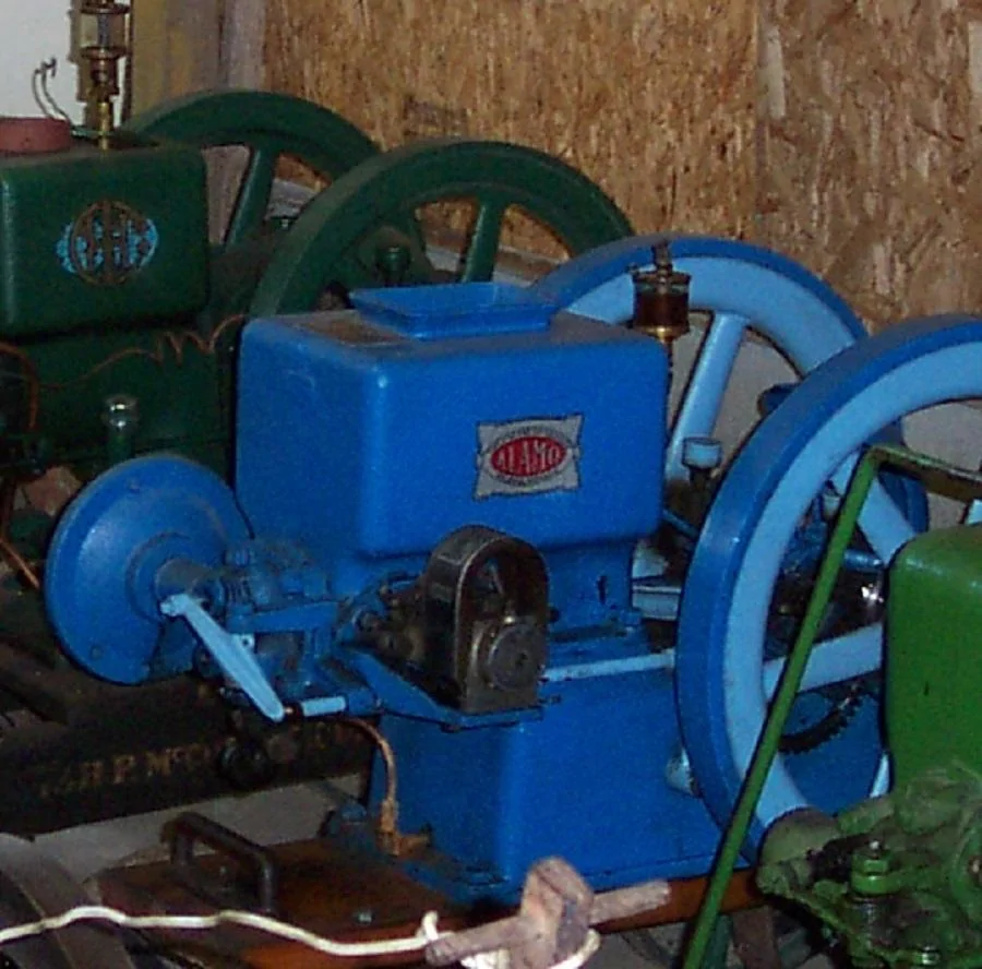

Most modern oils are more amber and less dark - the majority are more clear than your pictures,
but here's some bad old pictures of oil in the oilers of my antique engines. That oil in these was new right out of the bottle when I put it in these oilers (the brass and glass devices that drip oil onto the piston while the engine is running) showing how dark SOME oils are........
So - maybe they messed up, and maybe not. That's just my thinking on it.
As far as "too much oil" - many of us used to run 1 extra quart in our AMC V8s because of the issue of oil not returning to the pan quickly enough at high RPM.
I am no advocating running 6 in these, just suggesting there should be no damage.
When there's way too much oil, then the windage from the spinning crankshaft whips the oil into foam and you lose oil pressure.
Again, it's not right, it's not how it should be, and a dealership shop should do it right, especially since these trucks are now well beyond their "new product" stage where they'd not know about the difference. That excuse is gone.
