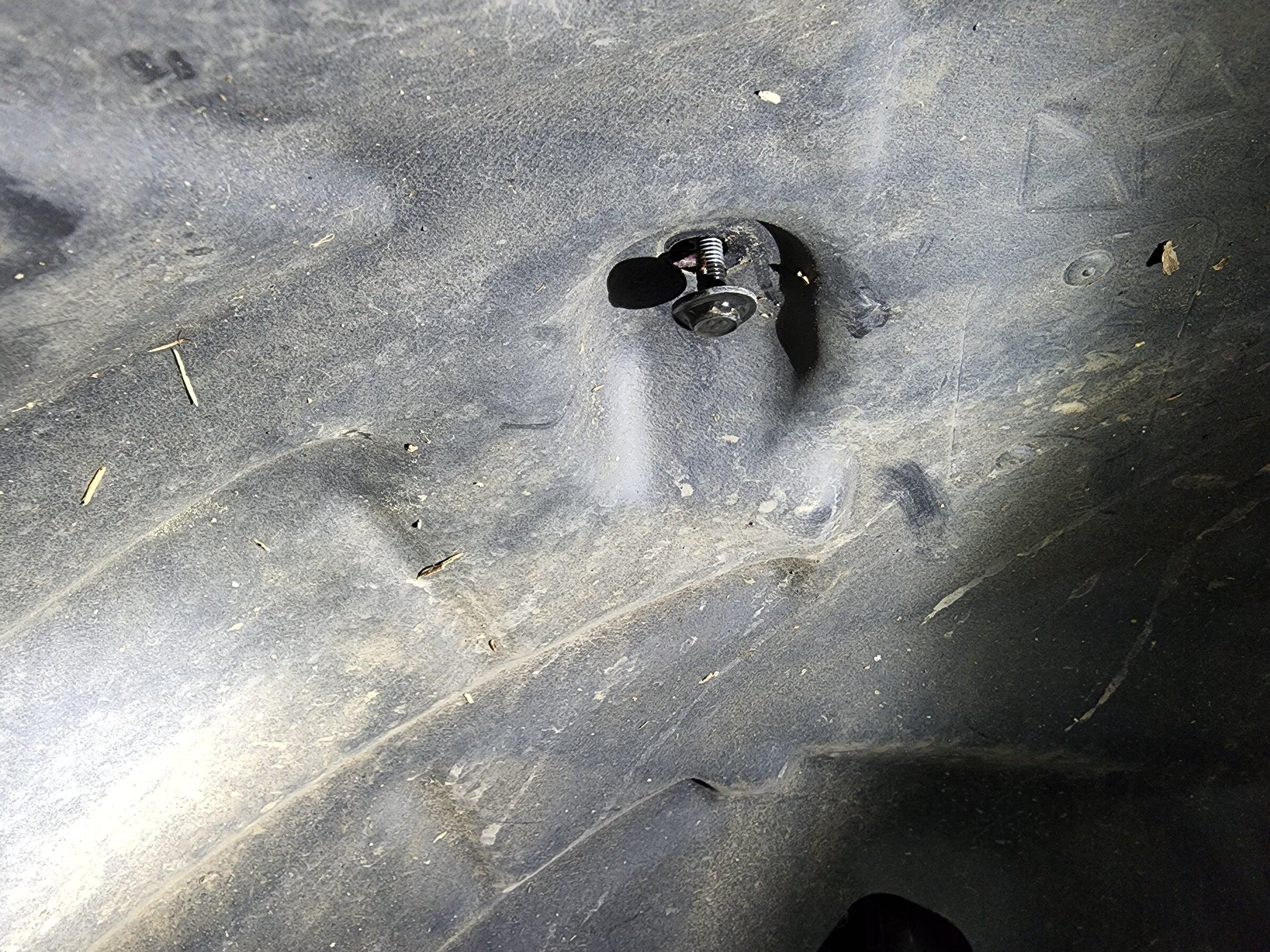

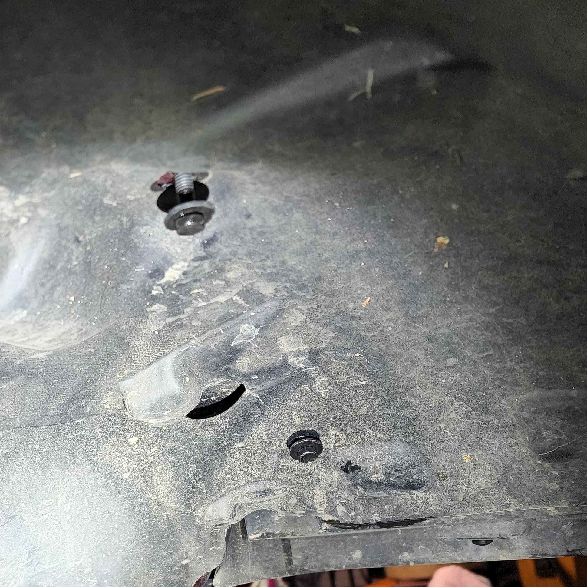

So ESS has not worked for awhile . Always showed " not ready " . I knew from these forums that it was probably a battery issue . Truck has 6k miles , build date
4/2021 . Voltage would be 12.1 / 12.2 after an overnight . Not normal . Service advisor was well aware of the aux battery issues but said they had to charge
the battery for 4 hours before they could load test it . Main battery tested ok , aux was not . They replaced only the aux battery . I see some people get both
as a matter of course .Oh well .
In my research about this I watched a YouTube by [Banned Site] . Highly recommend . He replaced both batterys in 15 min by going from in from the top , removing the fuse box etc . Some comments said this was factory procedure , some said they get in by way of the wheel well by removing the fender liner .
When I got home I thought I'd see if how they did it . Here"s what I found .
Jeep Gladiator Dealer service story , ESS related . 20220411_191217
Jeep Gladiator Dealer service story , ESS related . 20220411_191151
Yeah , obviously thru the fender well . Jeez !!!!
I also got a Jeep Cares oil change and made a point of telling them that last time they overfilled by a quart . Got it right this time .
Was told it would take a day or so for ESS start working but it kicked in on the drive home . I don't care about ESS but I didn't want it to take down the main battery
like other people have experienced .
I was wondering how this might end up for lots of people . Would the screws fall out on the garage floor and give them a flat tire ?
Would the fender liner start flapping in the breeze ? Maybe nothing ?

There's a reason they go in via the fender liner - the books says to. And they get paid flat rate, not by experimenting or trying other methods. Owners can do what they want, dealers have to follow procedures or miss getting paid back by Jeep.
If you are paying you'd have a right to have them do it how you wanted, assuming you promised to pay extra for any issues when disconnecting the PDC, and so on. There's a risk disconnecting that stuff, especially when the "book" says for warranty work, this is how you do it.
Had they removed the PDC and done it like owners do - what if something had gone wrong, poor connection, electrical issues later - it has happened to users here who have removed that and not gotten things exactly right going back in.
But to screw up the book procedure like that - that's a different animal!
Be happy they didn't remove the PDC! Imagine the issues you'd be having.
